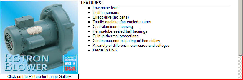

So I have pretty much settled on an aerator, and I will outline my plans and what I plan to buy, and I am looking for some constructive criticism and suggestions.
For starters, the pond is between 1/4 and 1/3 acre with a max depth of 8' and an average probabally around 4. Rough dimensions are 150' long, and kinda oval shape with one end larger than the other. About 80' on one end and 100' on the other.
Here is what I plan on buying mdpnddesc
Seems to be the best price around and made in USA:thumbsup:
Since air hose is just as cheap (or cheaper) than electric wire, instead of locating the pump out at the pond and having to build a box around it:confused2:, I think I am going to locate it in the garage about 100' away and buy air line instead. Good Idea or bad??? This way, everytime I am in the garage, I will know weather it is working or not, Plus with it being in a "controled-climate-evironment" I cant help but think it will be better for the pump.
Another option I had was to possibly buy a Chinese knock-off compressor for 1/10th the money, and buy a diffuser separatly. Like this one https://www.surpluscenter.com/item.asp?item=4-1586&catname= or similar. But what concerns me is that it is the same 1/20 HP, but is only about 1/4 the CFM:mad: But it doesnt show that it is continuous duty either. I could also step up to 1/8HP like this one https://www.surpluscenter.com/item.asp?item=4-1854-A&catname=, but it still isnt rated at as many CFM as the small one I first listed:confused2:

These style blowers come into our shop a lot for motor bearings. Usually after about 7 years of outdoor service here in Florida. Fish farmers use them exclusively. They make lots of air, last practically forever, but aren't cheap. The ones you gave links to won't make 1/100th of the air that these will make. Not enough air, lots of algae. The life expectancy of the China stuff probably is less than a season.
