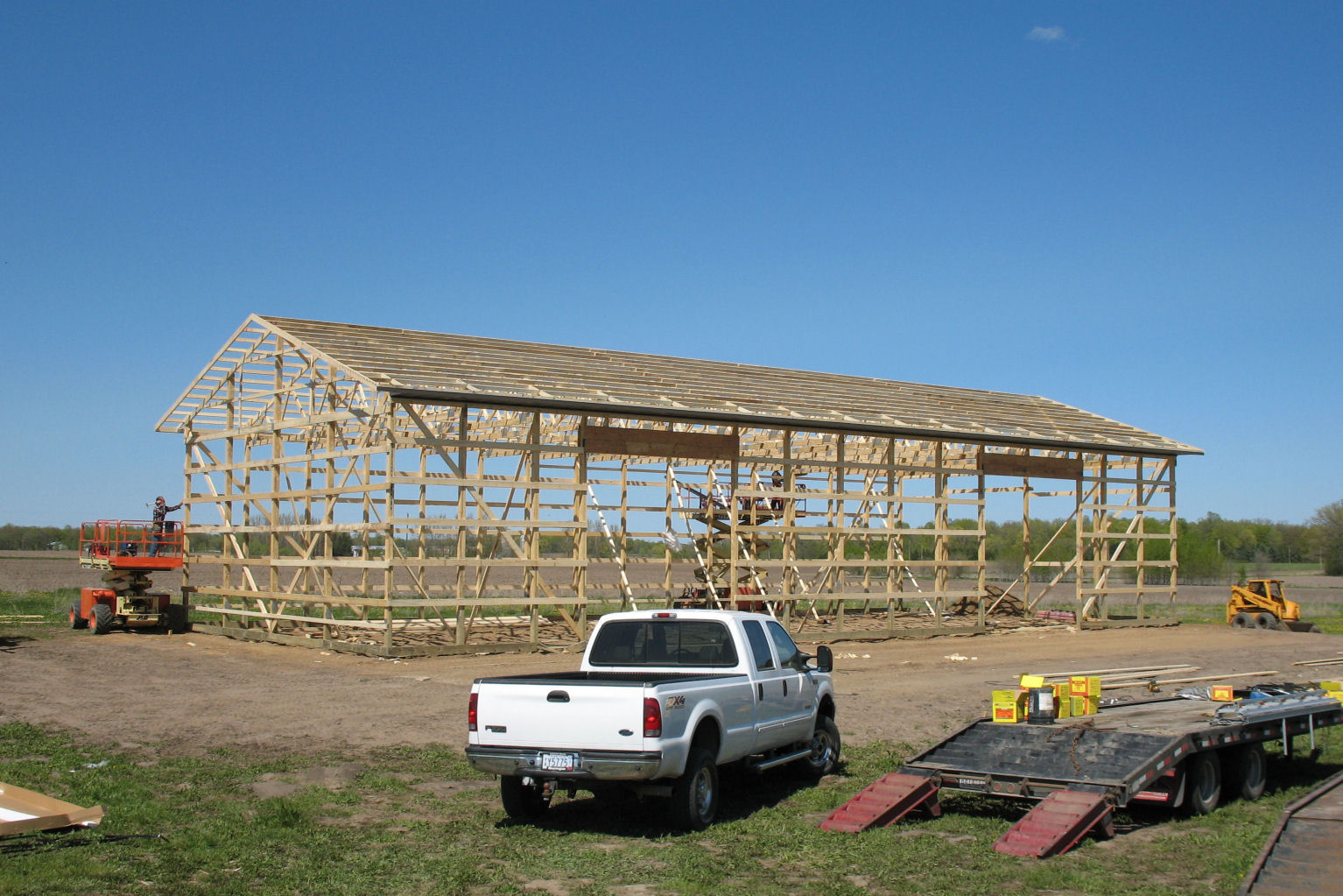

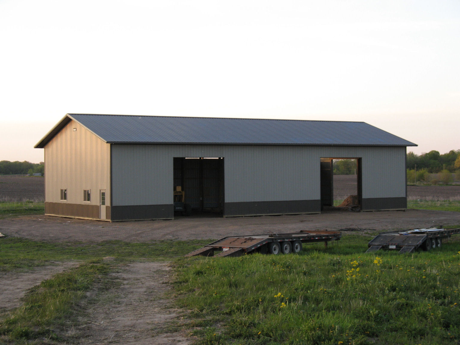

Recently I have started a project that I have been working and saving for a number of years. I must admit it is great to see this come together but it is getting rediculous how much steel and general building materials are costing these days. My new shed will be 40X90X16. My shop part will be 40X42 with all walls insulated and finished in steel. The other half 40X48 will be cold storage. It will be all cement flooring and the shop part will have in-floor heat. As you can see I have planned for 5th wheel camper or tall equipment with 14' overhead doors.
I do have questions about the lighting and all input would be welcome. I plan to do fluorescent lighting in the shop part and incandecent in the cold storage along with the eave lighting.

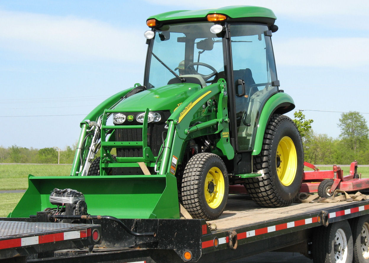

As you can see I also treated myself to a little 3720 JD cab - it is really a nice little machine!

WOO HOO! Nice Doghouse!! Someone has finally built what I have been thinkin' ! Great job. Get us pics of the inside where your shop will be... BobG in VA
