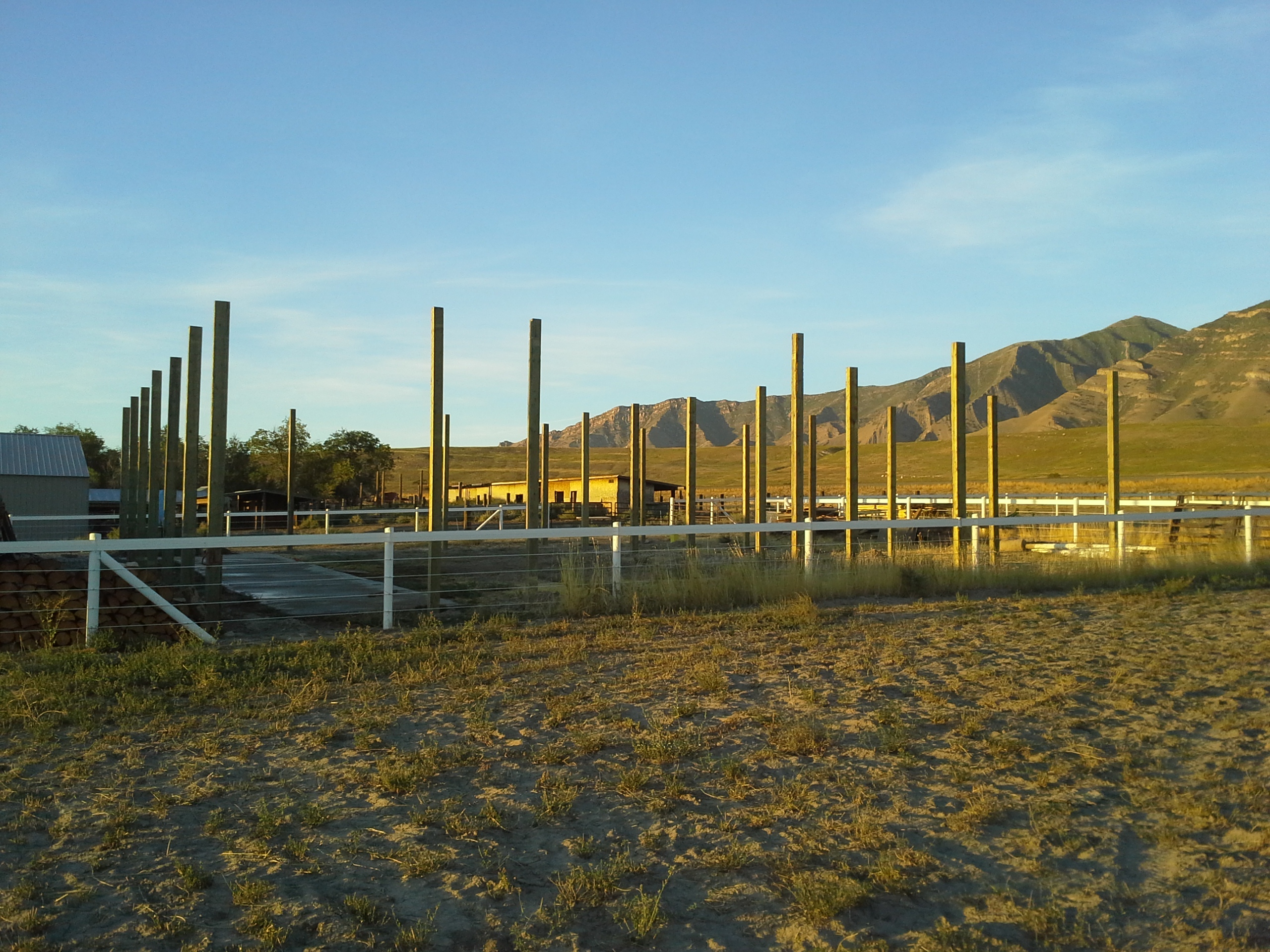

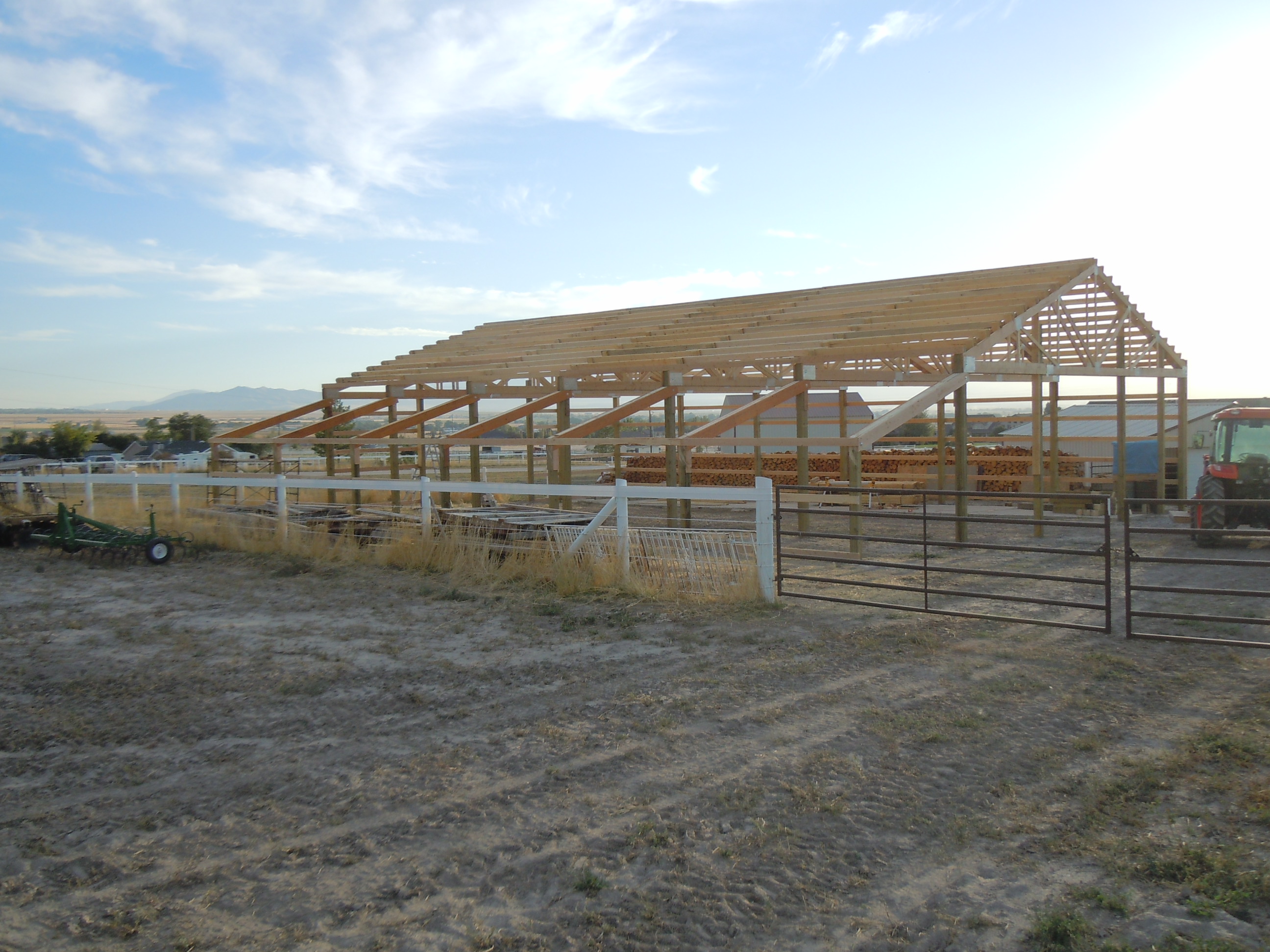

   / Pole barn, what size? #34
   / Pole barn, what size? #35

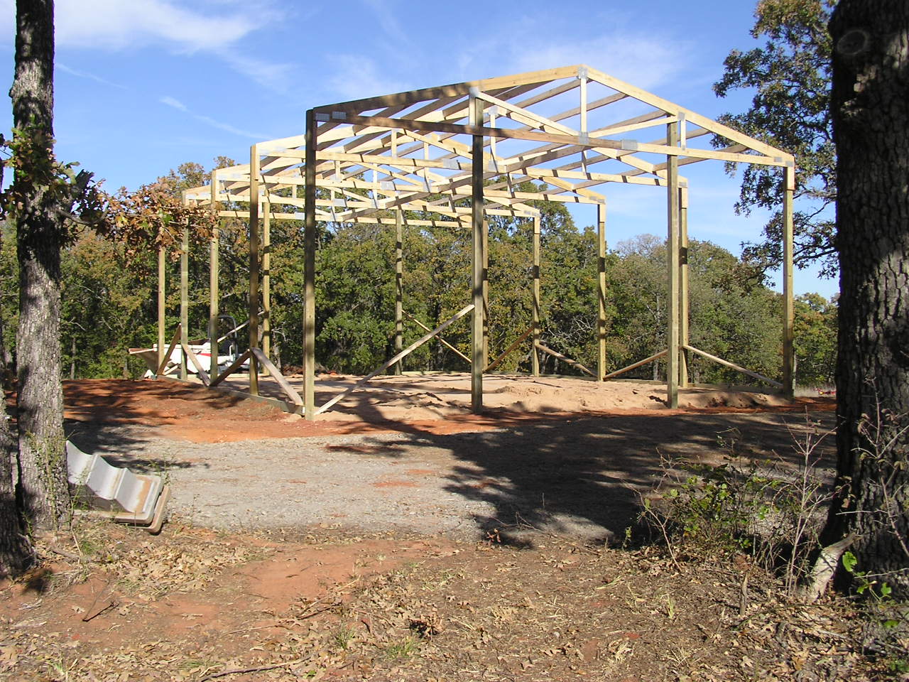

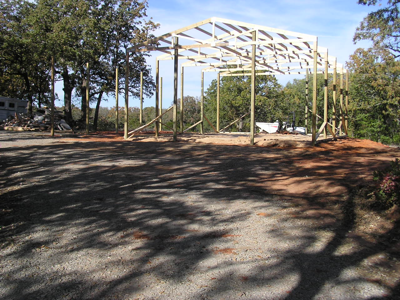

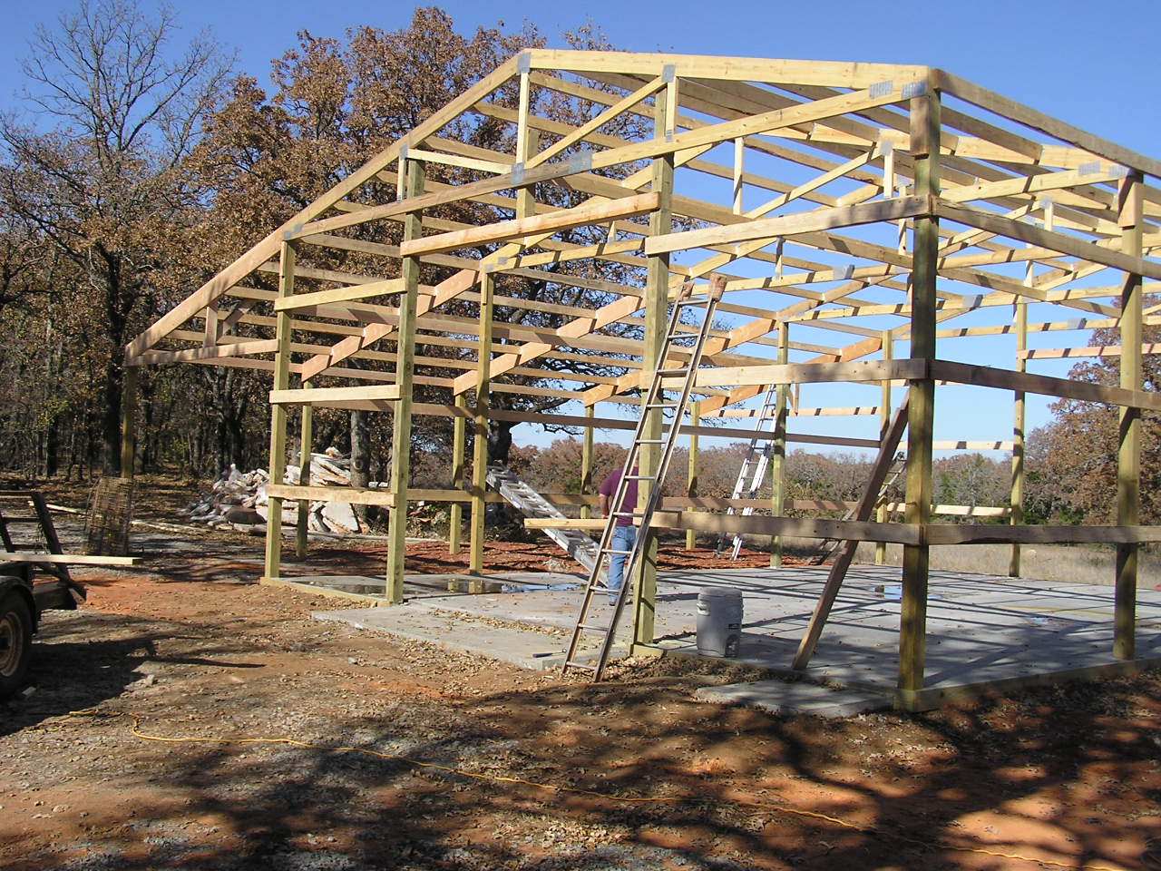

Nice building. What length poles did you use?
Don't know what length he bought or how deep in the ground, but the walls are 14' high.
The tops were cut off after they were all set in place.

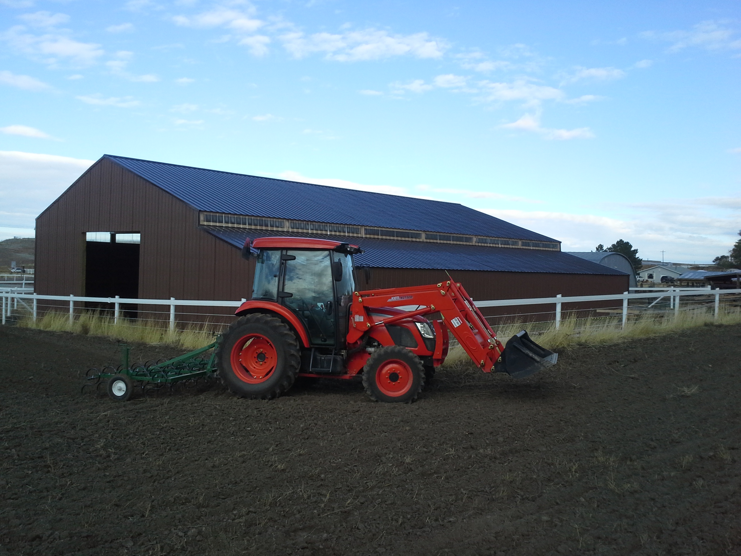

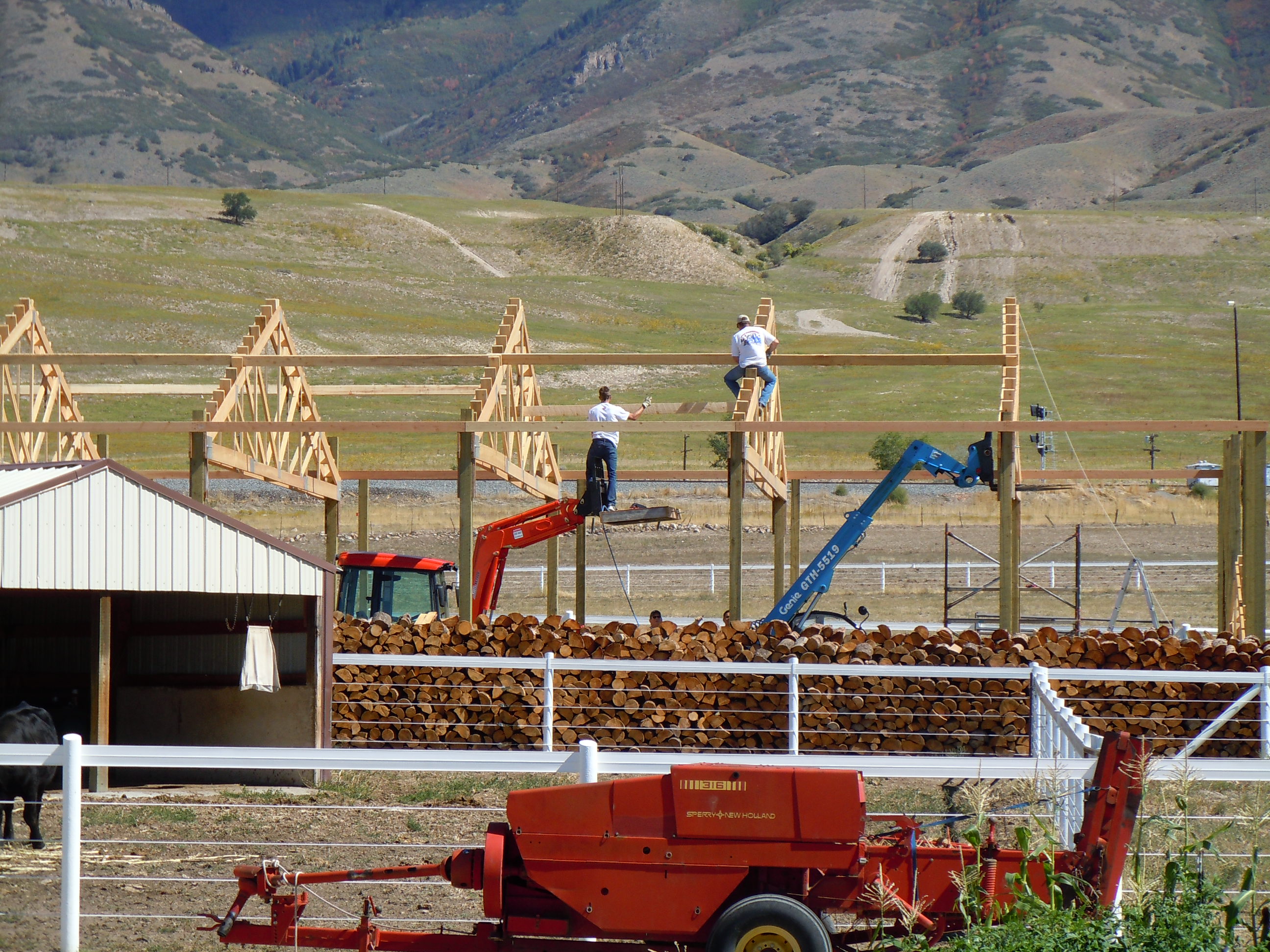

   / Pole barn, what size? #37
Thanks for the info and additional pics. Pretty easy to pull a material list from this.

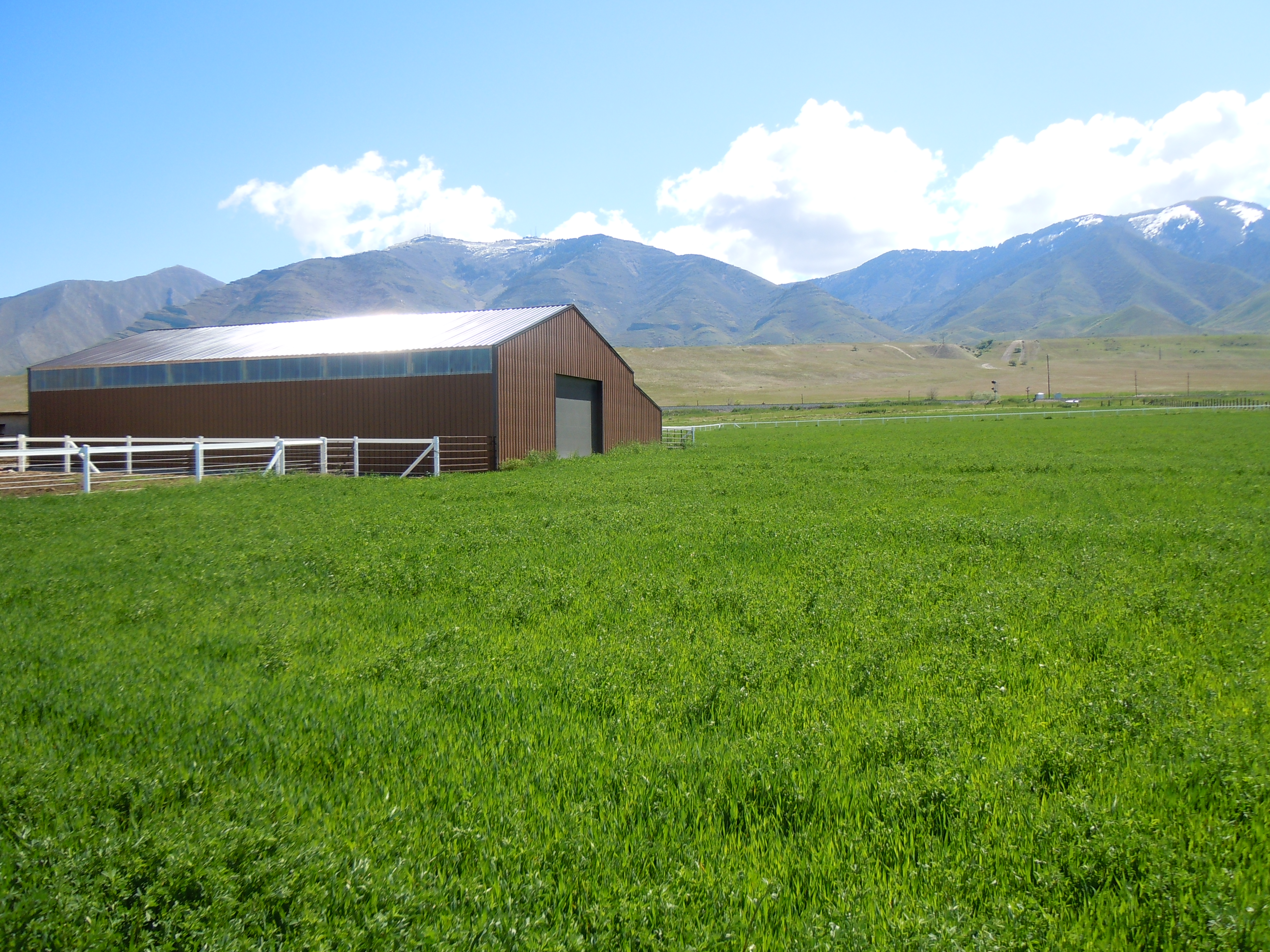

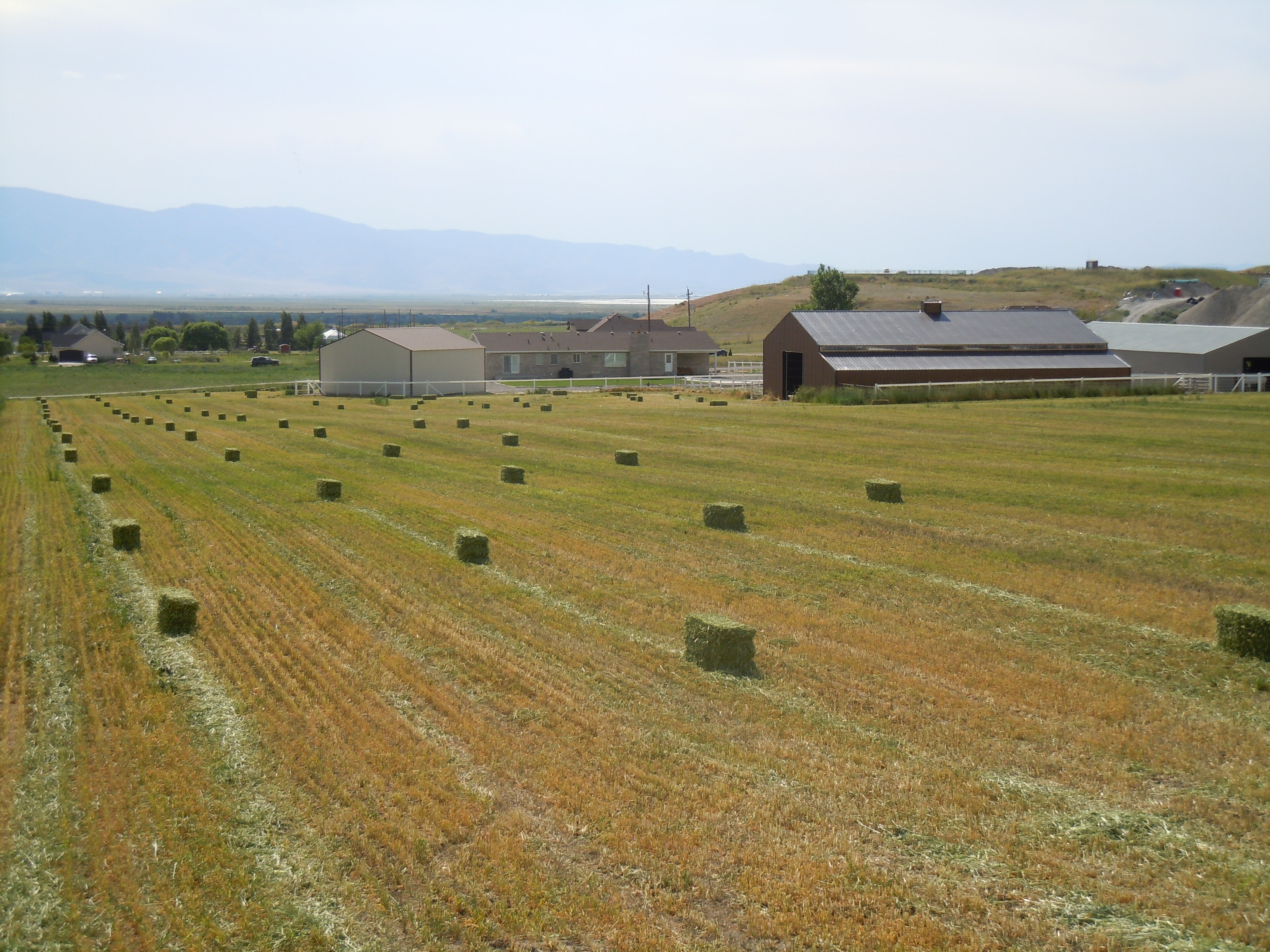

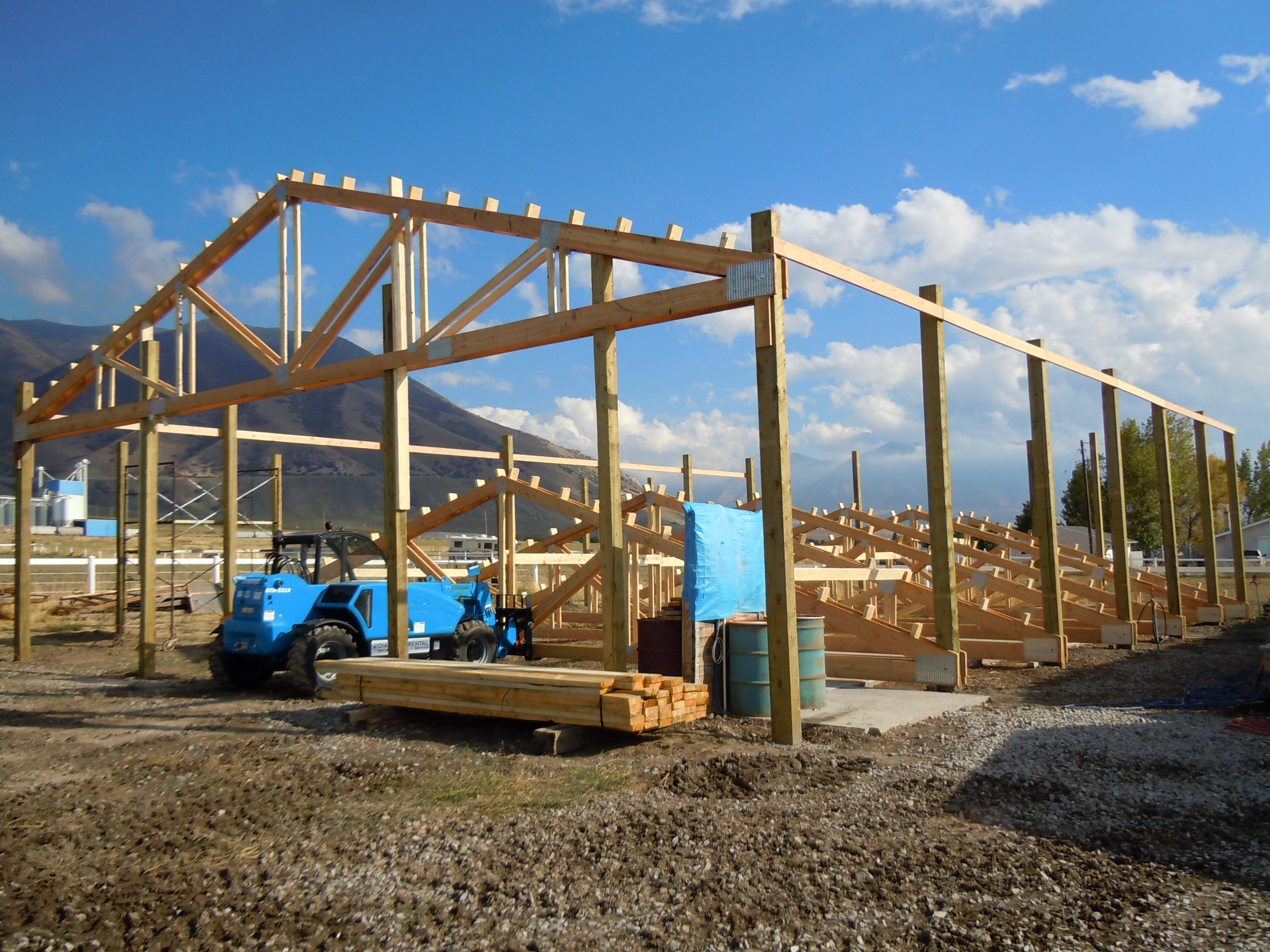

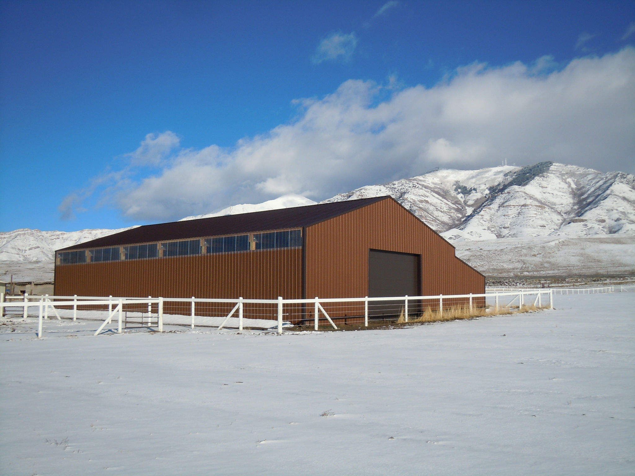

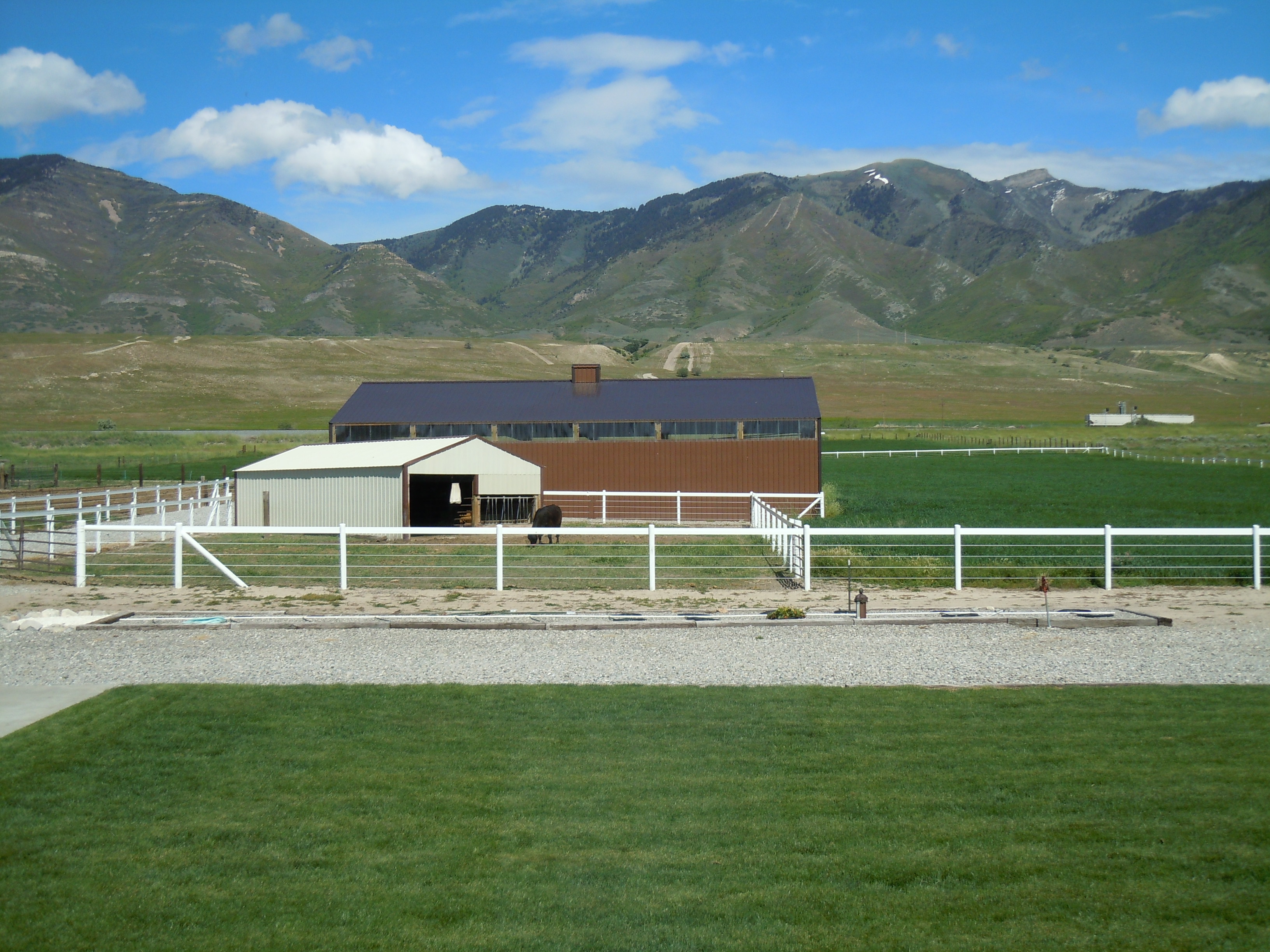

I built just last fall. 57' X 72' it does hold all my farm equipment, but sometimes I wish I had gone another 12' on the length. As others have already said and I will echo. Build as big as you can afford.
Here's some pics of mine.
It will fill up faster than you think. I do not store any hay in mine. At this point I'm 30k into mine.
