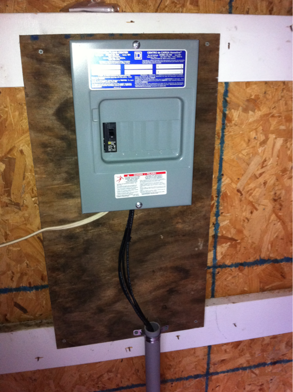

Well I took the jump and put in a 50 amp service today.After reading all the posts I think this will come in handy.
No more extension cord plugged in from the basement for the welder.
I ran 90 ft of 8 awg thwn at 37 cents per ft 6 breaker panel 19$ total cost with conduit was about 200$.
I ran 1 quick outlet today for power,on Monday I can get started with the rest.

While I'm not sure, but it looks like you're missing a wire... You should have two hots, a neutral and a ground. Be sure that you're safe.
/ Pole barn sub panel
There are 2 hot a neutral and a ground just hard to see in the picture.

You might want to put in a local grounding rod. 90 feet you are starting to get out there. Not sure of codes.

You need a local grounding rod to that panel.
/ Pole barn sub panel #8
Nope not anymore.. that is old code,,,2 code problems,, you do have is the wire needs to be in pipe all the way to the panel.. and you need a Main breaker..
/ Pole barn sub panel #9
And for any one else ..... 8 awg at nearly 100 ft exceeds allowable voltage drop for 50 amps. Should be 6 awg. What you have will work, your voltage will be a little low and your circuit will run a little warm at 50 amps, but no real danger wise.
The ground rod is still a good idea/ allowed correct?
Sure woulda used one size bigger wire, would be nicer to the electric motors in a shop setting....
That box has enough spaces that it does require a main breaker in it - which will take 2 of your spaces away.....
Main feed needs the pipe.
As well, the wire leading away needs a staple within 8 inches of the box, would not appear to be there tho not sure.
you DO need a single ground rod per 2008 and 2011 code book for a panel in a separate building. Also need the 4 wire run from main panel to subpanel, and yes a main breaker is required in a separate buildings panel.
