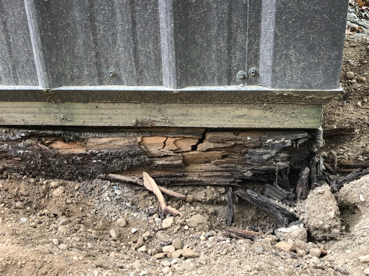

I purchased a home with a 24'x32' pole barn with stone floor. The barn is only 5-8 years old and was built up in the back to accommodate being level with the driveway. The other day i was spraying around the barn and to my surprise some of the 2x6 tongue and groove is already rotting. Since the barn was built up they have some of the left over dirt just piled around the outside of the barn and graded out. I am assuming i need to replace the skirt boards, but what do you recommend to do with the remaining dirt around the barn? Replace with stone, gravel, etc?

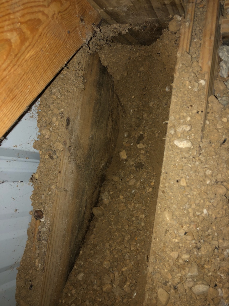

attached are the pics. One from the outside and one from the inside. IMG_1291.jpgIMG_1297.jpg
/ Pole Barn Skirt Board question #6
That doesn't look like ground contact pressure treated wood. The board above does. Maybe it was a temporary thing and they planned to pour cement and never got to it.
Dig it down, and use GC PT and never worry about it again.

Agree, that wood does not look treated
Can the ground be leveled and slop away some ?

OK, silly question, if there is stone on one side, and dirt on the other, and the board above holds the siding...why do you even need a board there? Maybe just pull out what you can to keep it from rotting something else?
/ Pole Barn Skirt Board question #9
X2
It looks like non PT board to me that was added after the pole barn was up. If I am seeing it correctly I would pull it out and just add gravel as to me it looks the same level as the inside floor. Or form it up and fill with concrete.
