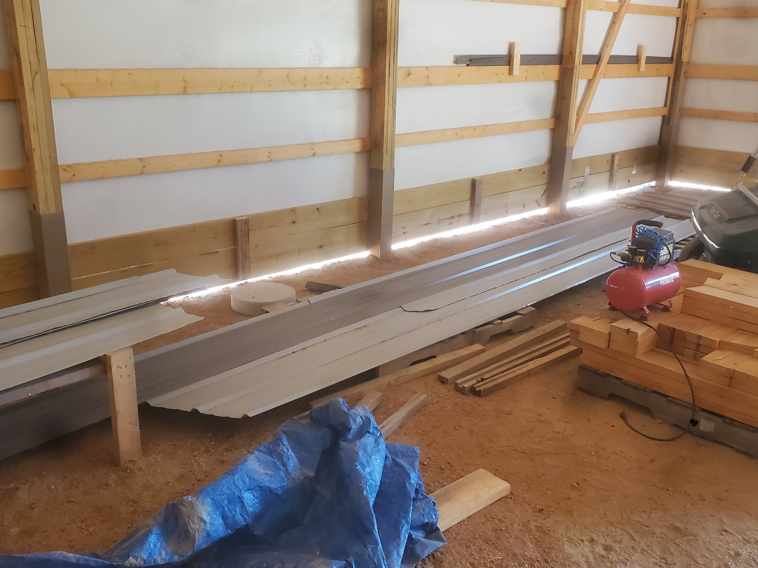

Nice. So... your rat wall is about 7 or 8 inches tall, underneath the slab height? I hope that is enough to accomplish your goal. I went 24" deep on my rat wall, below the slab bottom.
So now you need a sh!tload of fill brought inside the building to get leveled up to the top of your rat wall sections, right? fun! :)

Juiced - Yes I plan on a vapor barrier but thinking about what I should do with the extra flap of plastic at each bay. Leave it flat and put stone on it? fold up and try to integrate into the "main" vapor barrier?
Deezler - Thats correct about it being 7-8 inches and underneath the slab. I have 100 tons of crusher sitting right out in front of the barn just waiting to be brought in. Would have had to do the same thing before, only difference is now these rat walls are here. Just need to finish a few more things and coordinate with this local guy. He will run the skid steer and ill run the rented twin drum compactor and plate. My goal was not necessarily to prevent groundhogs but doing something to help contain the fill. The only problematic area groundhogs could dig in is behind the barn but I have a plan for that. Talked to some concrete folks about doing a thickened edge slab but wasn't happy with the responses I got so pouring these myself was the only somewhat sane option left.
I have thought a lot about putting 2" foam under the ENTIRE slab but I just dont think that's the best option for me. I went over to a local guy's house who has a slightly smaller barn with full radiant heat and he was showing me the ins and outs. I think its neat but I just dont know about radiant under the ENTIRE thing. One gable end of my barn was setup with scissor trusses to accommodate my plans for framing in an office/clean area with storage above since I have 14' sidewalls. I am thinking about pouring this building slab in two sections, one would be approx 12x40 and the rest would be 36x40. My thinking is I can edge insulate the 12x40 and run the tubing just in that. My neighbor does commercial concrete finishing for large warehouses and him and one of his coworkers do side jobs during the spring. He said pouring 40x50 with just us 3 is too much to handle but he would make me a smokin deal on the labor for the 12x40 office area. Guy owes me a few favors so who knows. Still thinking though.

Gotcha. Well definitely don't pay for the high-psi foam board if you aren't going to heat the whole building.... it's expensive!!
I would ignore your current bits of vapor barrier, just do it all correctly on top when it's time for the main slab pour. Just 2c.

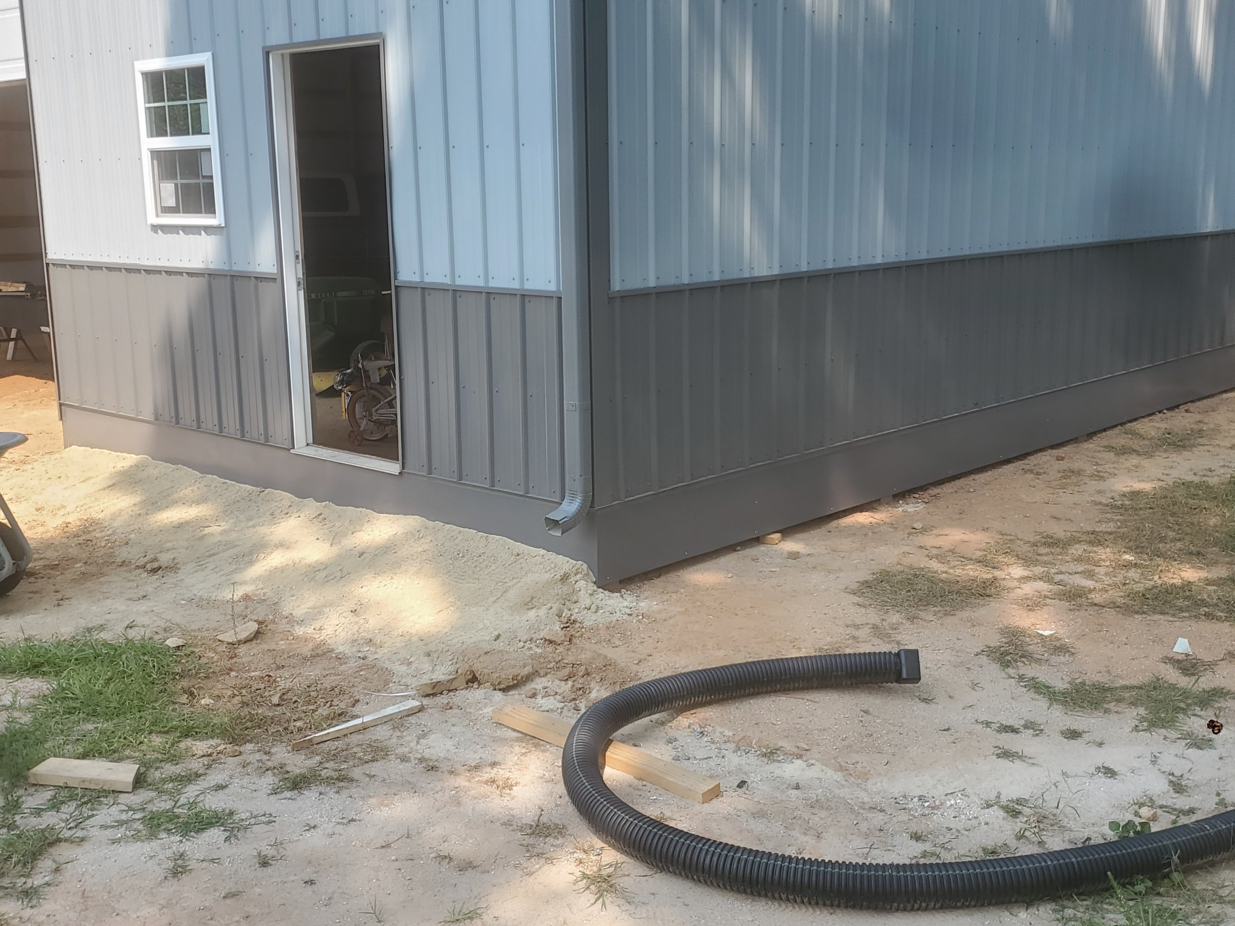

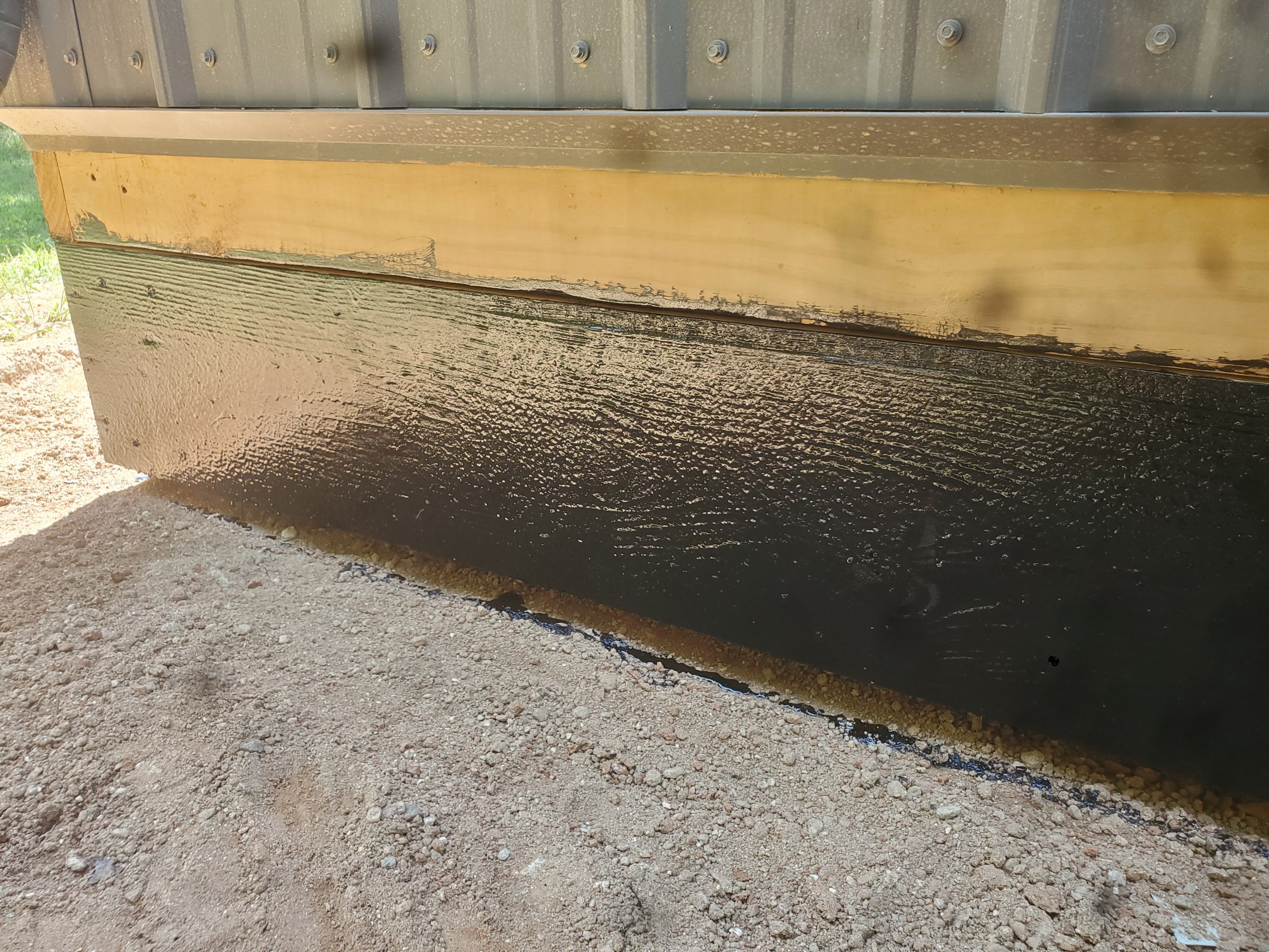

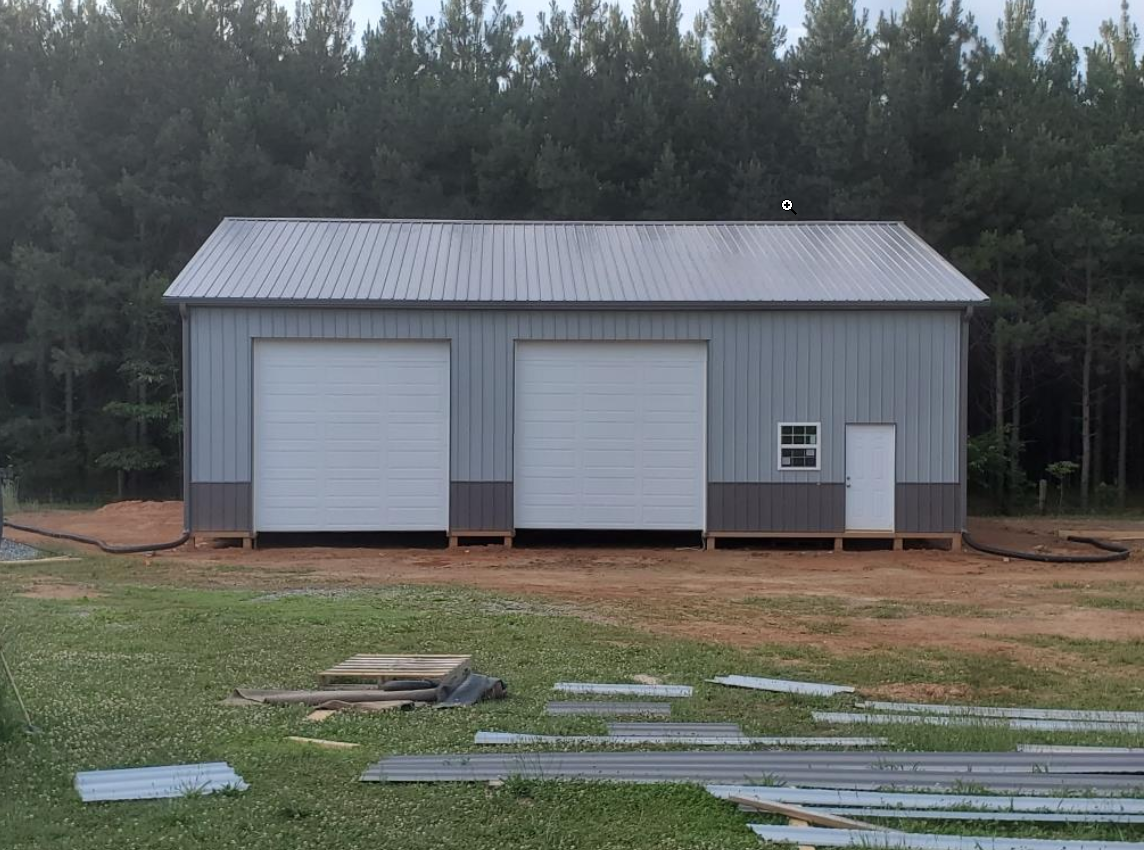

Hi guys,
Just finished a 40x48 pole barn. There is ~12" gap below the bottom of the skirt (2x8) that I need to do something with. This was intentional as the barn is on a slight grade and I wanted to raise it up a bit due to the crazy rain we get here in NC. Due to complications with the county, the building pad was built up just enough to create a level area for the builders to do their thing. Even then, this resulted in ~2.5' of fill in the back. Yes, I understand it would have made more sense to build pad up to
I have ~14" that needs filled up INSIDE the barn. I figure 4" concrete + 4" #57 and ~8" of compacted sandrock would do the trick. The outside we will blend off using cheap fill dirt. Should I double skirt this building with a 2x10 below the existing 2x8?
Just curious if anyone has been down this road before...the builder said they typically put the skirt right on grade but that wasn't going to work in this situation.
thanks for any advice!!
Drew
Form it up and pour a concrete skirt

Don't let him get you feeling defensive, Drew. Sure, accommodating the elevated building is taking some extra work now, but you're handling it. Keep forging ahead!
When I built my 30x36 pole barn, I had an oversized compacted dirt slab that had some drainage in all directions, so they put the bottom treated skirt board basically right onto my grade. Had to dig down an inch or two in one corner, and left a couple inches of gap on the other sides; no problem. The best part about this was indeed the minimal work require inside to get prepped for my slab afterwards. Just had to pull out a handful of loader buckets of surplus soil, then level, compact, 2" foam, 5" slab.
I think you will actually come to appreciate having your building somewhat elevated. Especially with that backside drainage issue you mentioned initially.

I don’t understand why you didn’t go on down. Should have poured a concrete footer or cinder block at minimum just to prevent your band board from resting right on the ground and rotting out. Then took your metal down to the footer. The way it was done doesn’t really make a lot of sense.
/ Backfilling pole barn, need advice #80
Sounds like you would be pretty disappointed in a majority of pole barns here across the midwest then.
Putting the skirt or band boards right into the ground is how it's done. Mine were done with full ground-contact rated, tongue and groove 2x6s. Three courses of them, two are below grade, the top one is above.
Back-fill the building exterior, fill and compact inside as needed, then you pour the slab inside and it's already all formed up by your skirt boards. So what if they get a little rotten over the years, they aren't structural in any way.
As with any building, you need to make sure you have good drainage away on all sides. Then the ground-contact skirt boards ought to last 50+ years.
