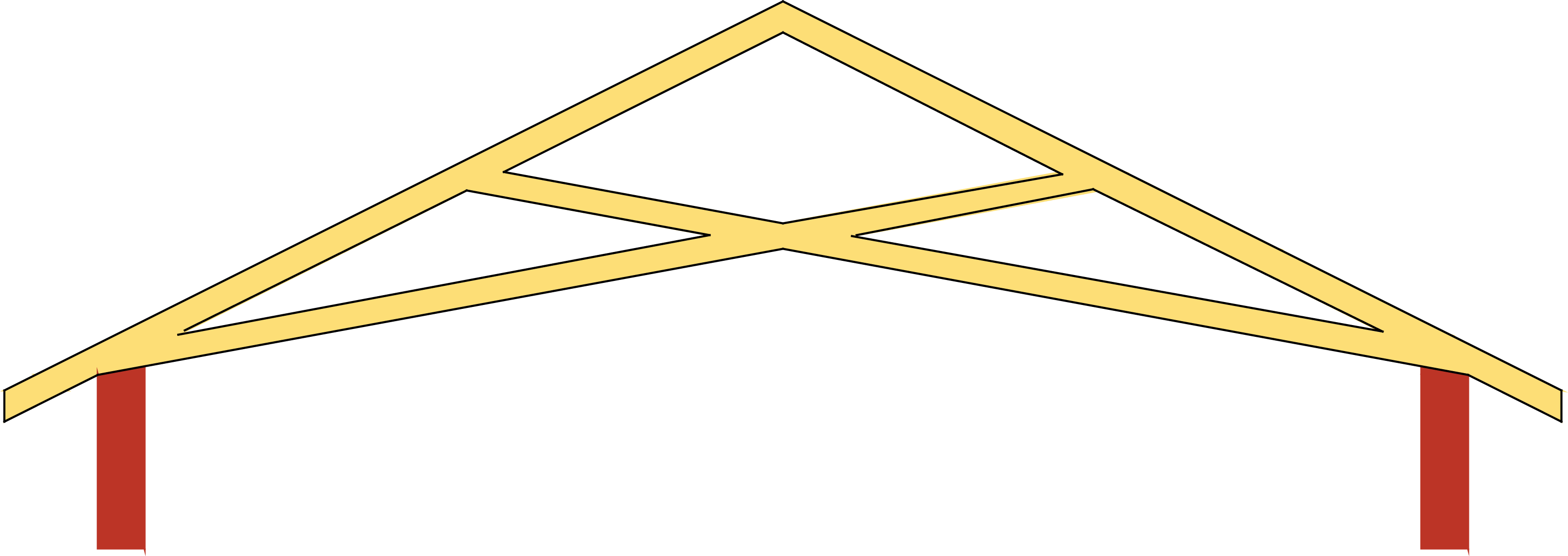

Good idea. Keep in mind that I currently live in Nashville but am building in Alabama (my parents' homeplace). We currently do wedding photography & DJ work and an awful lot of the barn venues I see around Nashville are steel trusses on wood poles. In Alabama I've noticed a lot of the places use stick trusses and frankly I just hate seeing all that trussing so low down. It makes the room feel much more cramped than that big, open feeling from steel trusses.
If you pay a little more, most truss manufacturers also make what they call a scissor truss which has both the inside and the outside going up in a peak (but at different angles):
