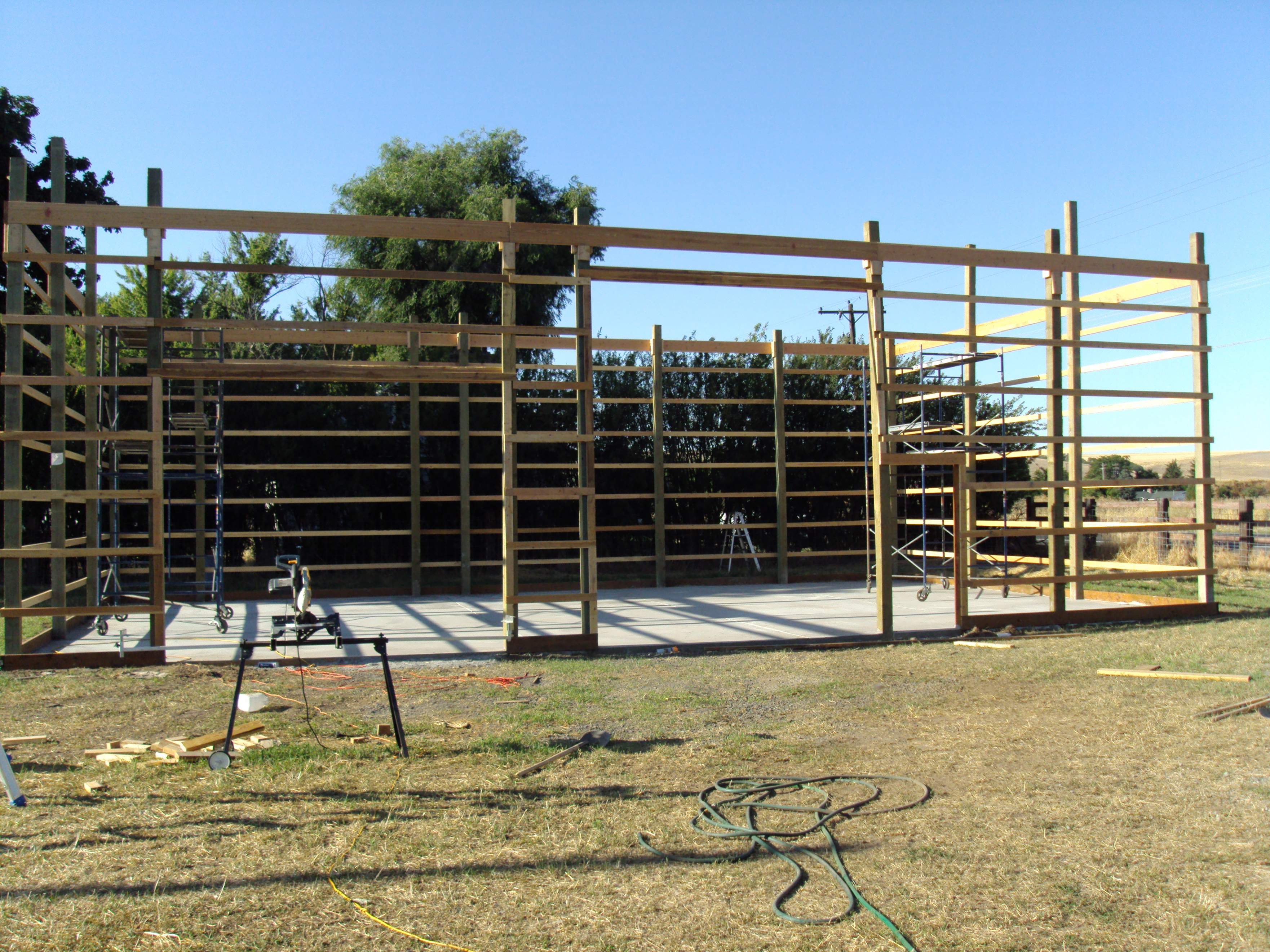

Im building a 30x50x16 pole barn i have everything up just waiting on the trusses right now.
What would be a cheaper and easier way to do the purlins on the roof....
#1 I have the option of doing the purlins 2x6's on edge stacked on top of the trusses
-This way i would have to use more metal on the side of the barn but it would be easier doing the roof. but a little tricky getting them purlins nailed standing up and while laying the roof metal i would think it would be a little dangerous standing on them for the risk of one twisting and me falling
#2 or buying purlin hangars and have them cut to match the spacing of the trusses.
-This way i would have to buy a **** load of purlin hangars and nail them to the trusses every 2 feet and more expensive but the purlins would just slide into place
Any thoughs on what i should do??

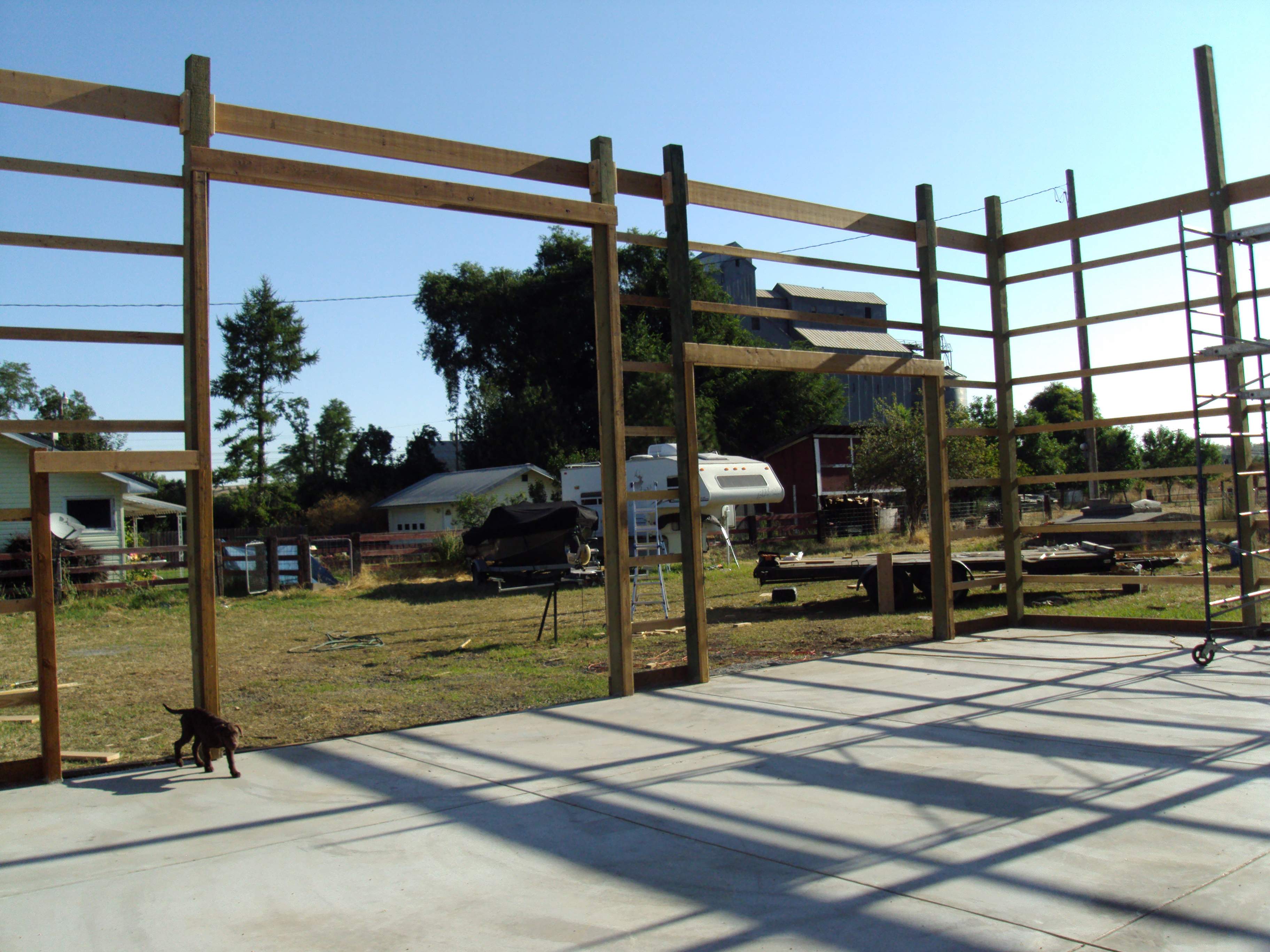

Yea i wish i could do my purlins 2x4's and laid flat but i have a couple of 12' spacing between the posts. So doing hangars is much stronger than just laying them up on edge on top of the trusses?
heres a couple of pics of what i got going on

the post spacing is different all the way down the furthest is 12'.....Yea im sure the hangars are a real PIA but they shouldn't get in the way of the roof steel. The truss manufactors are calling for 2x6's for purlins for the best support. The top cord of the trusses are 2x6 so if i lay the ledger board down the 2x6 purlins would stick above the trusses a inch or 2...but that is a really good idea with the running a ledger board along side of the trusses it would save me some money on buying all them hangars but would it be as strong as the hangars??

well the random spacing comes with haveing 2- 12' door openings on the eve side so the first spacing is 5' then 12.6' then 3' then 12.6' then 8.6' then 8.6' oc. So i guess on the 5', 3', and the 2- 8.6' spacing i could use 2x4's on edge with that ledger board. Would that be enough strength for the roof?

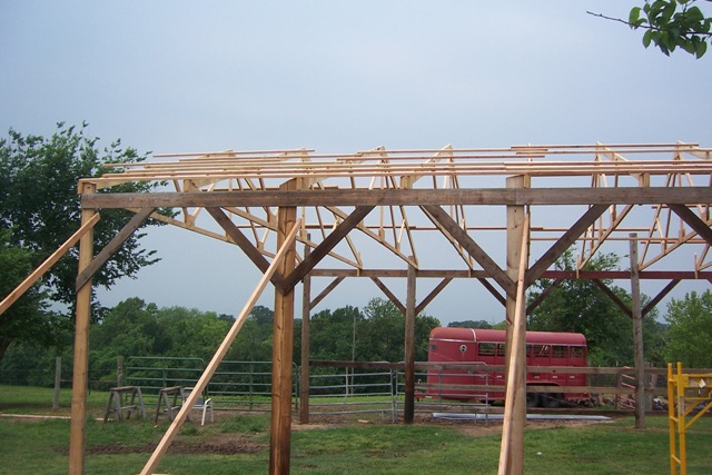

Nail a stub pole or 2x6 to the top plate to fasten the rafter to ... if your worried about support put a plate on the inside just like the outside.
Don't know about the Cost difference... the darn hangers and long 2x6's are going to take up some time ...
/ Pole barn roof question #20
When I built mine I put a stub 2x4 ..
