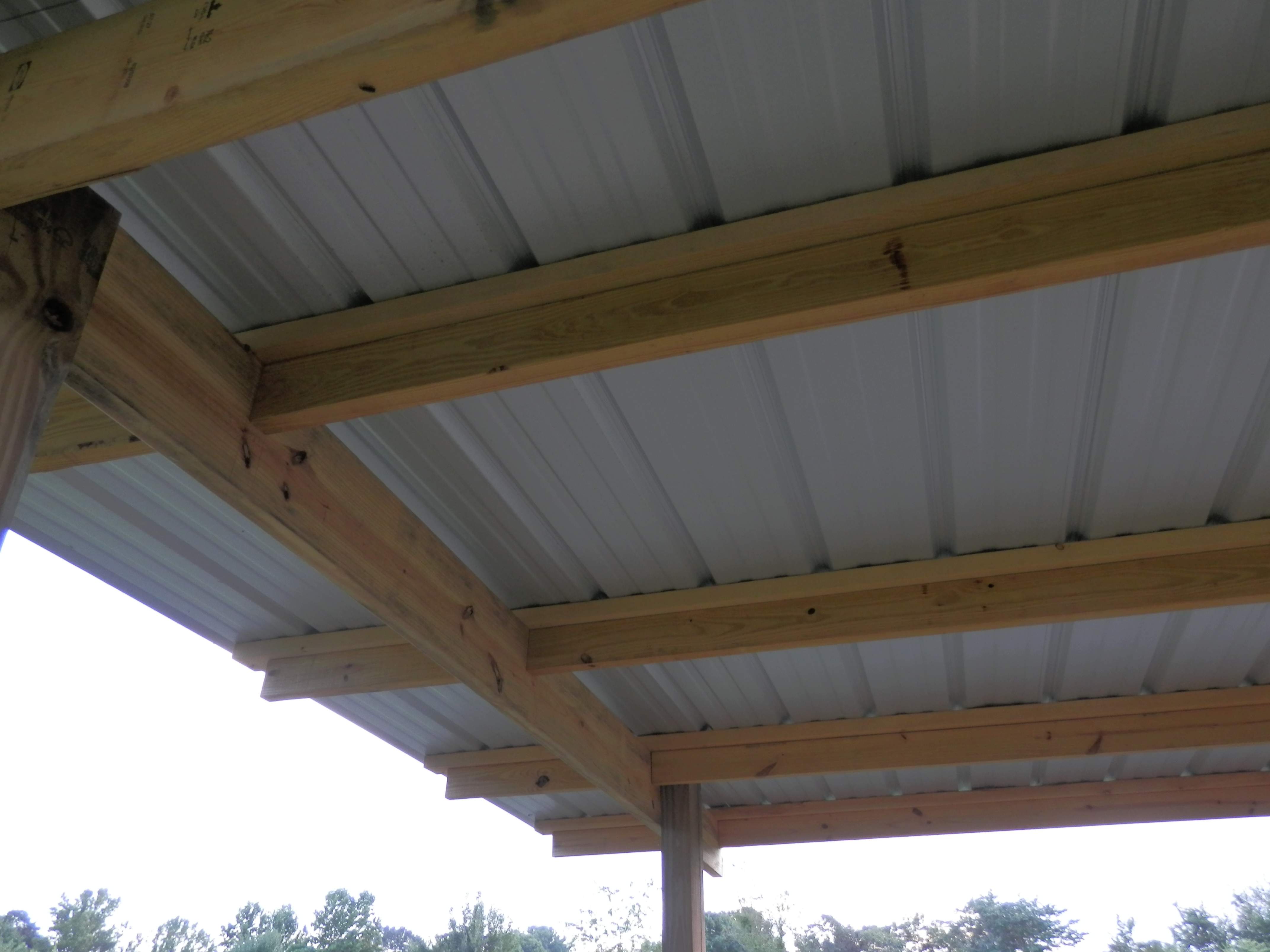

Barn in question ....
/ Pole barn purlin help! #8

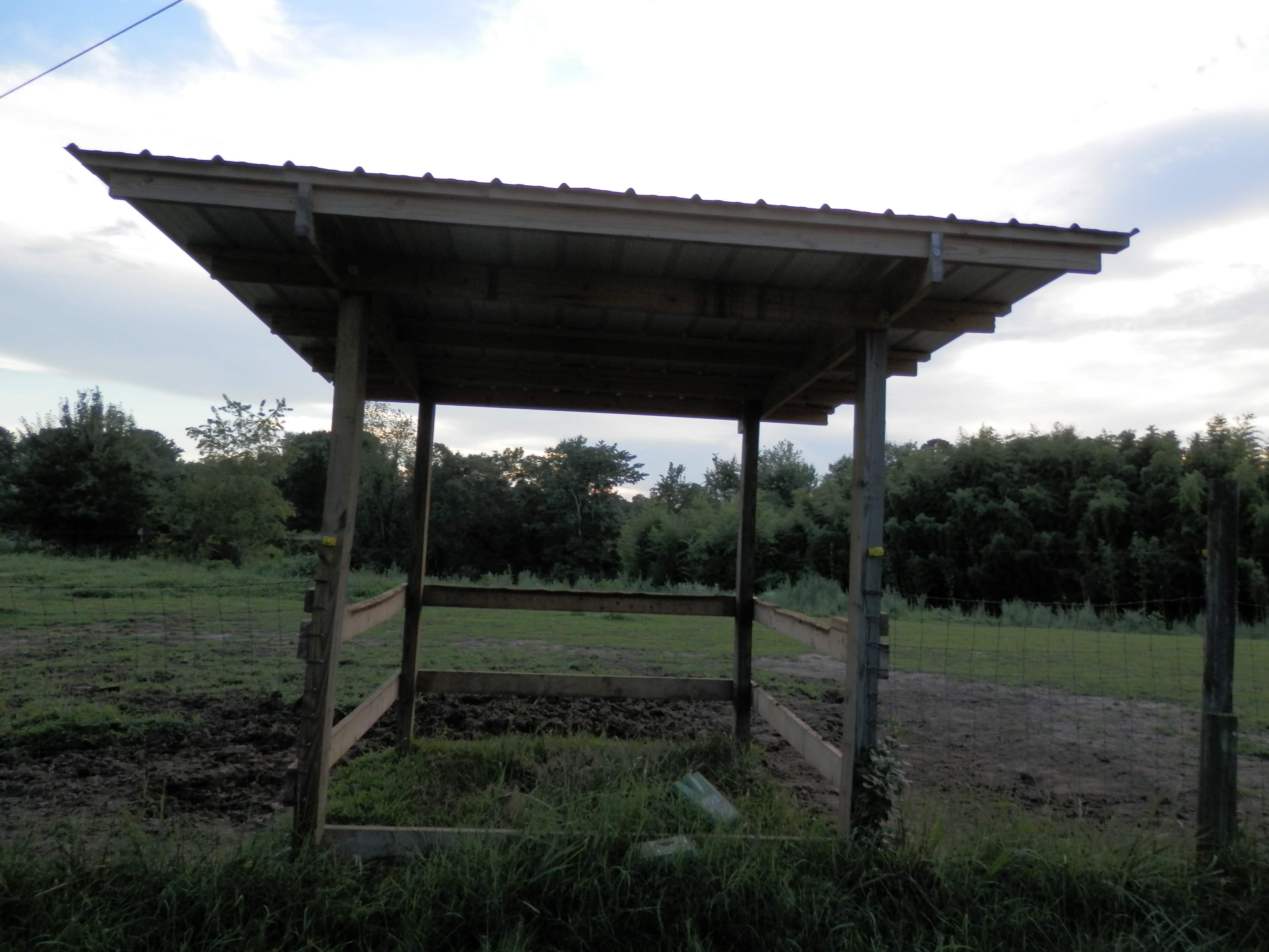

This is just my round bale feeder but I put a 2x4 on edge between the "trusses" and one flat across the top to make a T.

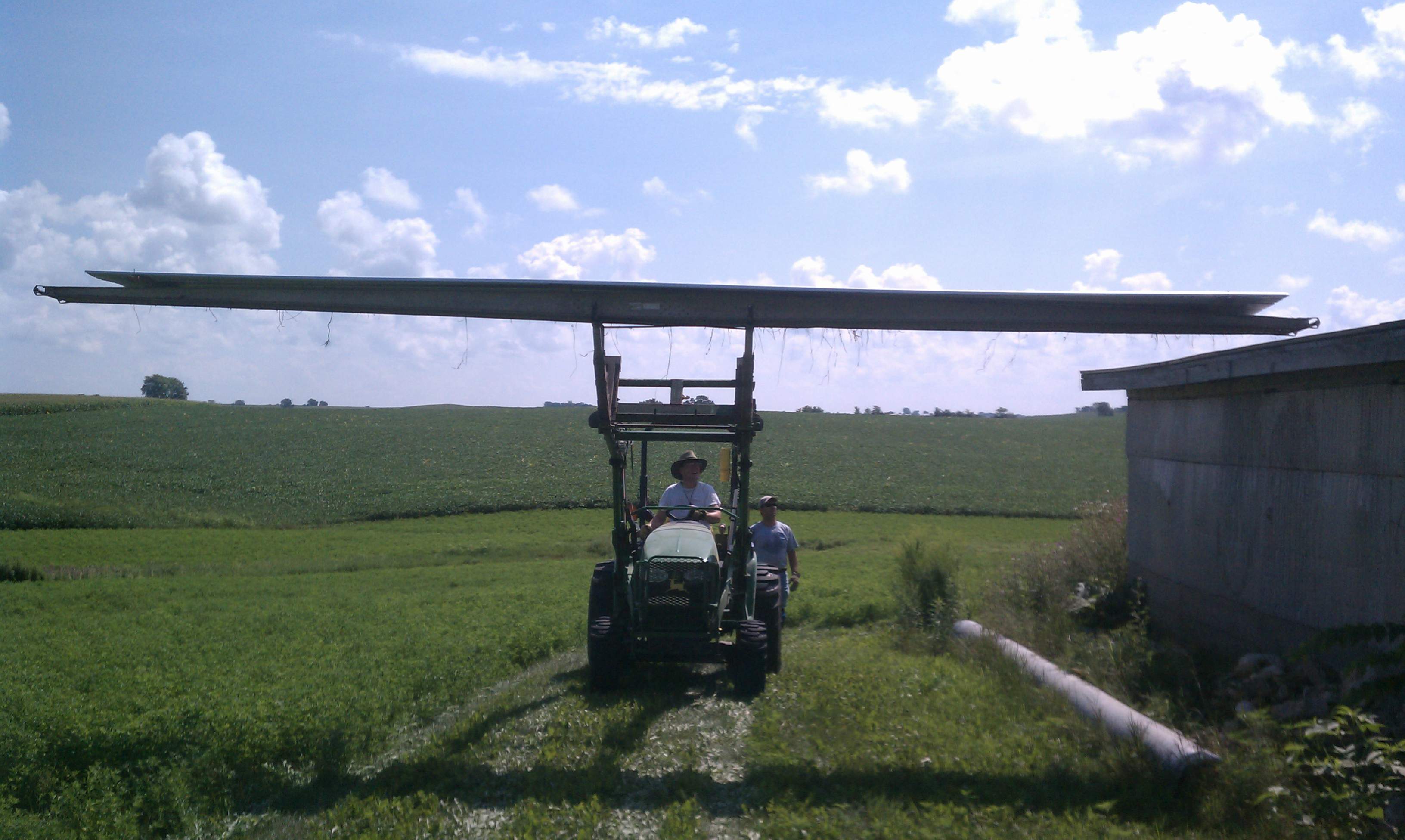

I re-read the original post, and I think you mis-understood the specs. The roof purlins are on edge and on 24 inch centers, not 4 or 6 feet.
As to long sheets: I have worked with sheets as long as 41 feet. It is tough to get them delivered and unloaded without damaging the edges, but if you can get the tin supplier to use a couple cover sheets it helps, and get the driver to use more than two straps when unloading it too, it helps. After that it comes down to having enough hands to lift them without kinking. On the 41 footers we had 4 guys. 32footers will need three guys. Another good trick is to build a ramp of sorts, at the point where the roof is closest to the ground, so you can slide the sheets up. Think of it this way: A sawhorse that is about 5 feet tall, then five feet closer to the building a sawhorse that is 8 feet tall, then five feet closer a sawhorse that is 11 feet tall, OK, you get the point. They dont have to be actual sawhorses of course, but now you have the concept. Cover them with carpet if you are really ****. Or you can use some automation. Let me see,,, Yup, here are some pics of a deal I built to handle long steel sheets...

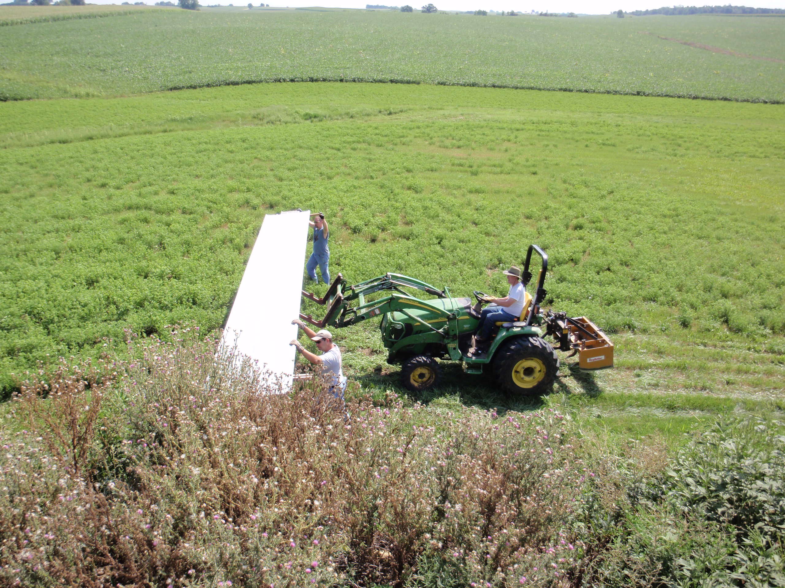

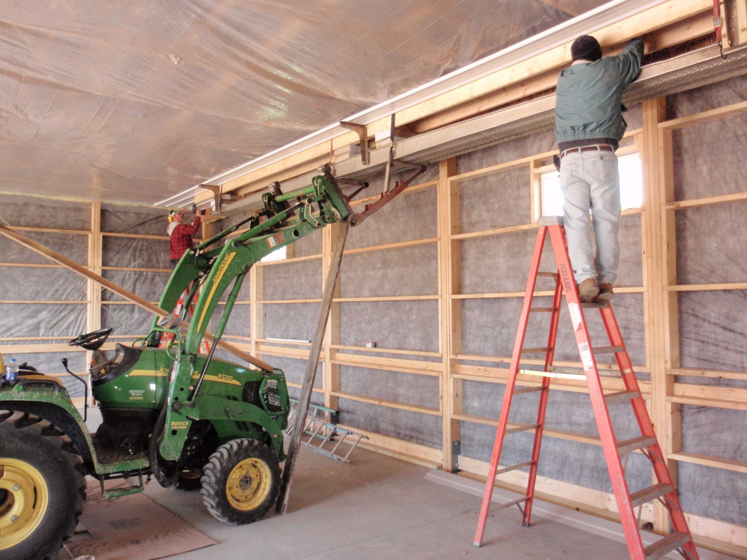

I have a 22' boom for my loader. I reach over 4-5 sheets lengthwise & place a couple of slings under the sheets to lift them. I use short cam action straps between the slings & the boom which makes it easy to lower the sheets to the roof. I have another strap with a hook which is placed over the ends of the sheet closest to the tractor to prevent them from sliding out of the slings. The slings bow the sheets side to side & keep them from kinking. This setup works for side walls up to 12' no problems. If it is higher, it will still lift the sheets over the roof part way & allow you to slide them up the rest of the way lice the ramp mentioned earlier. (Note - On some loaders where the lift arm cylinders are pinned to the lift arms there may be several holes. If so, if you use the set of holes closest to the driver, it will allow you the highest reach. If you use the furthest set of holes, you lose reach but gain digging depth.)
The boom has sure made life easier for many things.:thumbsup:

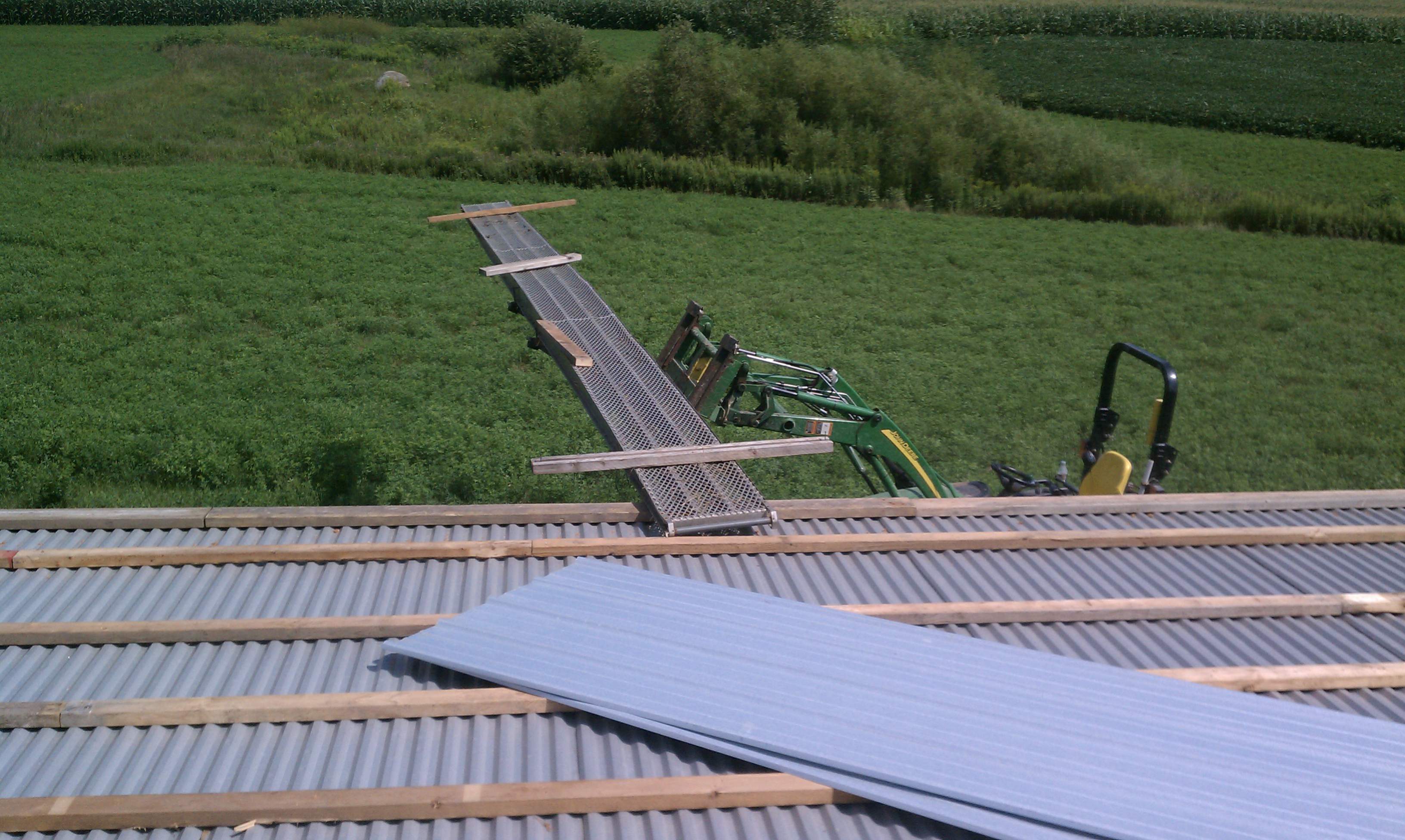

I don't know what the practical limit on length is, from the perspecive of expansion and contraction due to temperature change. In my case, the 41 footers were a ceiling. The pics I posted showing roofing were 25 footers. I don't know how much the Original Poster's desired 32 footers used as roofing, would expand and contract. From the handling standpoint, I would want to use a single pc for the 32 foot span. It would avoid the overlap, where 4 corners all stack up and it never looks right. My opinion anyway.
