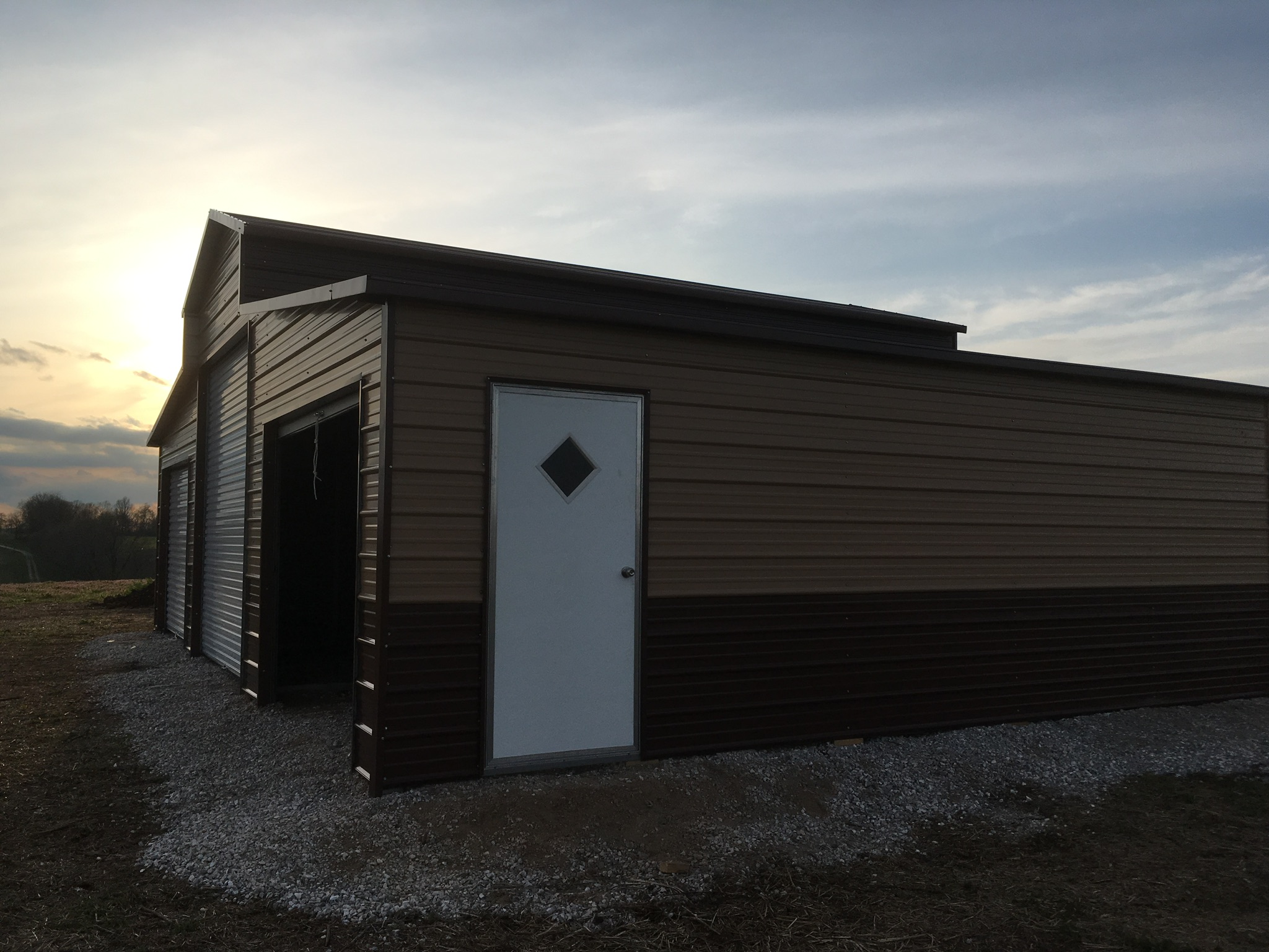

I have one of the metal buildings similar but smaller than yours. I put it on a gravel floor base and did the land prep myself. I like it and it is very utilitarian and looks good. We致e had some storms come through with 60 mph+ Winds with no issue whatsoever. Needless to say I知 a fan. Do not put any fill in if you have to level a spot. Dig down to the low point.
Here is mine for reference.

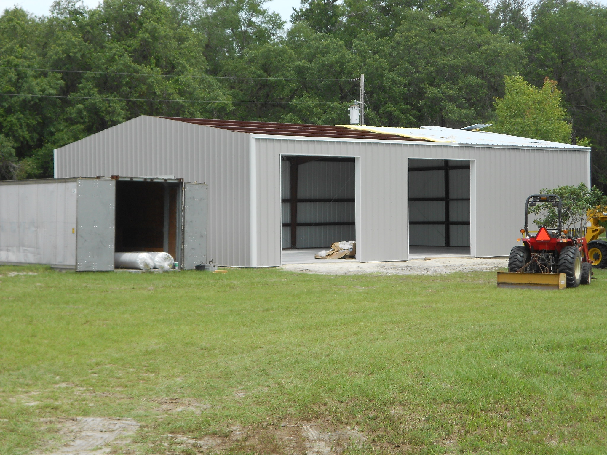

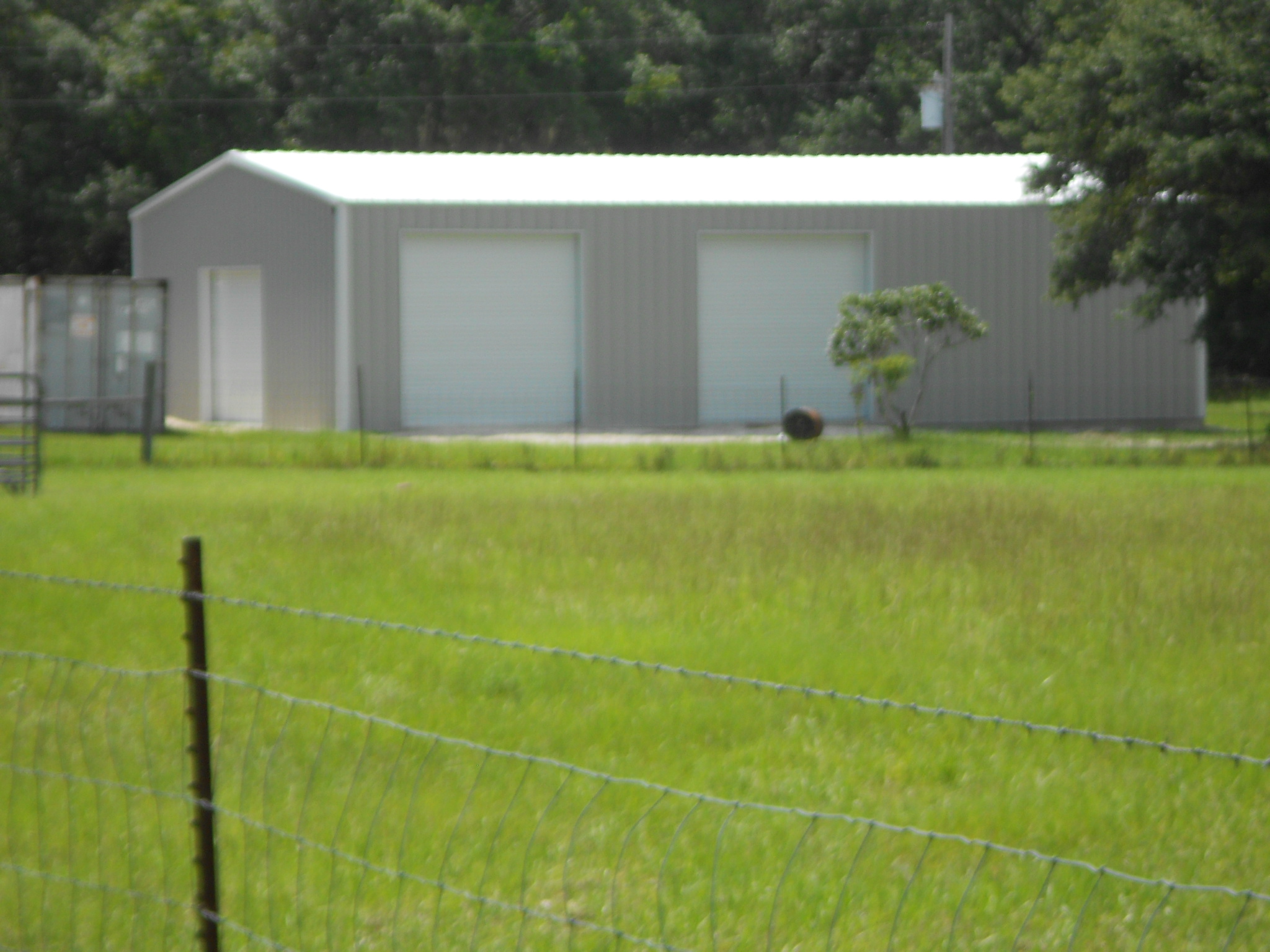

Just an example- I had this building put up 3 years ago for $38 K complete , it is 40' X 60' X 14'.
I bought it from a dealer in Jacksonville Fl and it was made in Adel Ga.
One big concern is do you have to permit it? Then costs/options go up.
Pole barns tend to be cheaper.

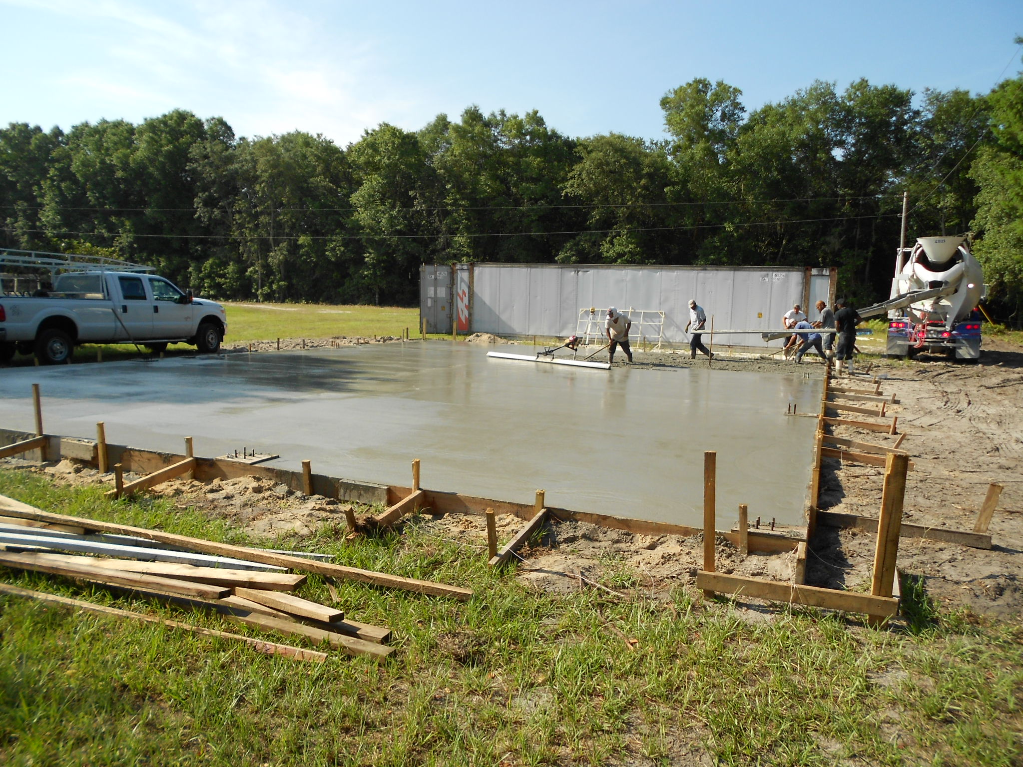

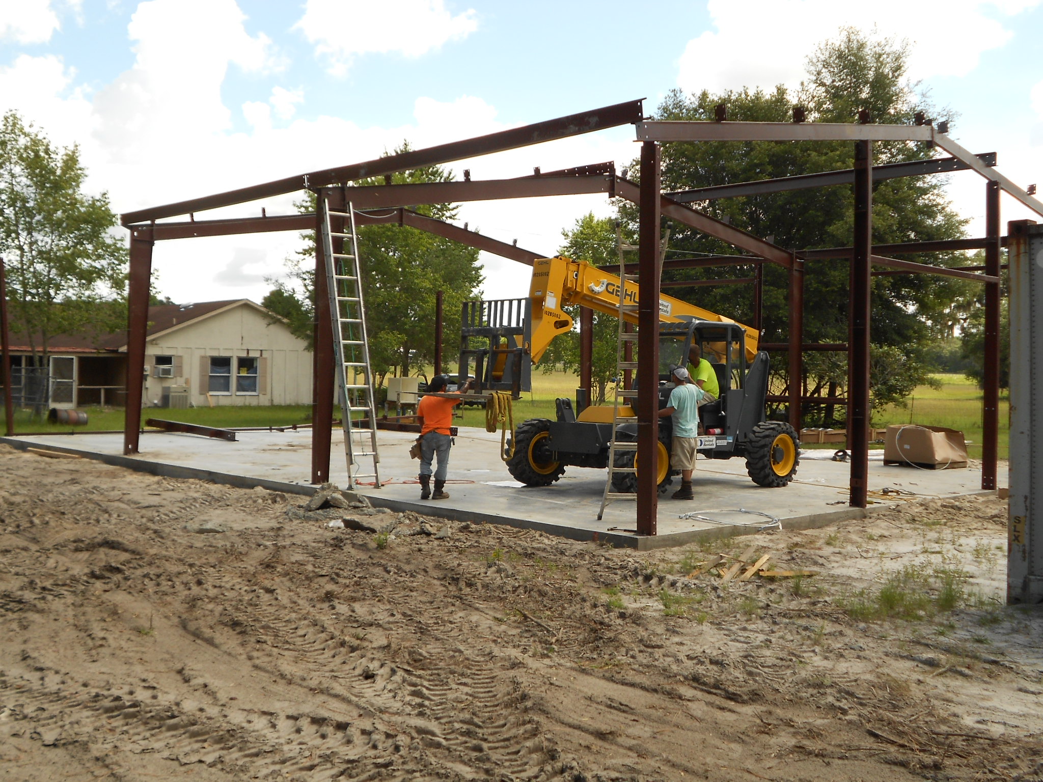

I have a 36 x 28 pole barn that I built myself and a 40 x 60 metal building that I paid someone to build.
Materials for the pole barn was around $8K, took me 6 months to complete working half the weekends
Metal building was $56K, with $24K for the slab, $18K for steel materials, & $14 for erection labor (our black clay is difficult to build on)
OUCH!! My concrete was $12,000. and assembly crew was $7500. on my 40' X 60' in 2015.
