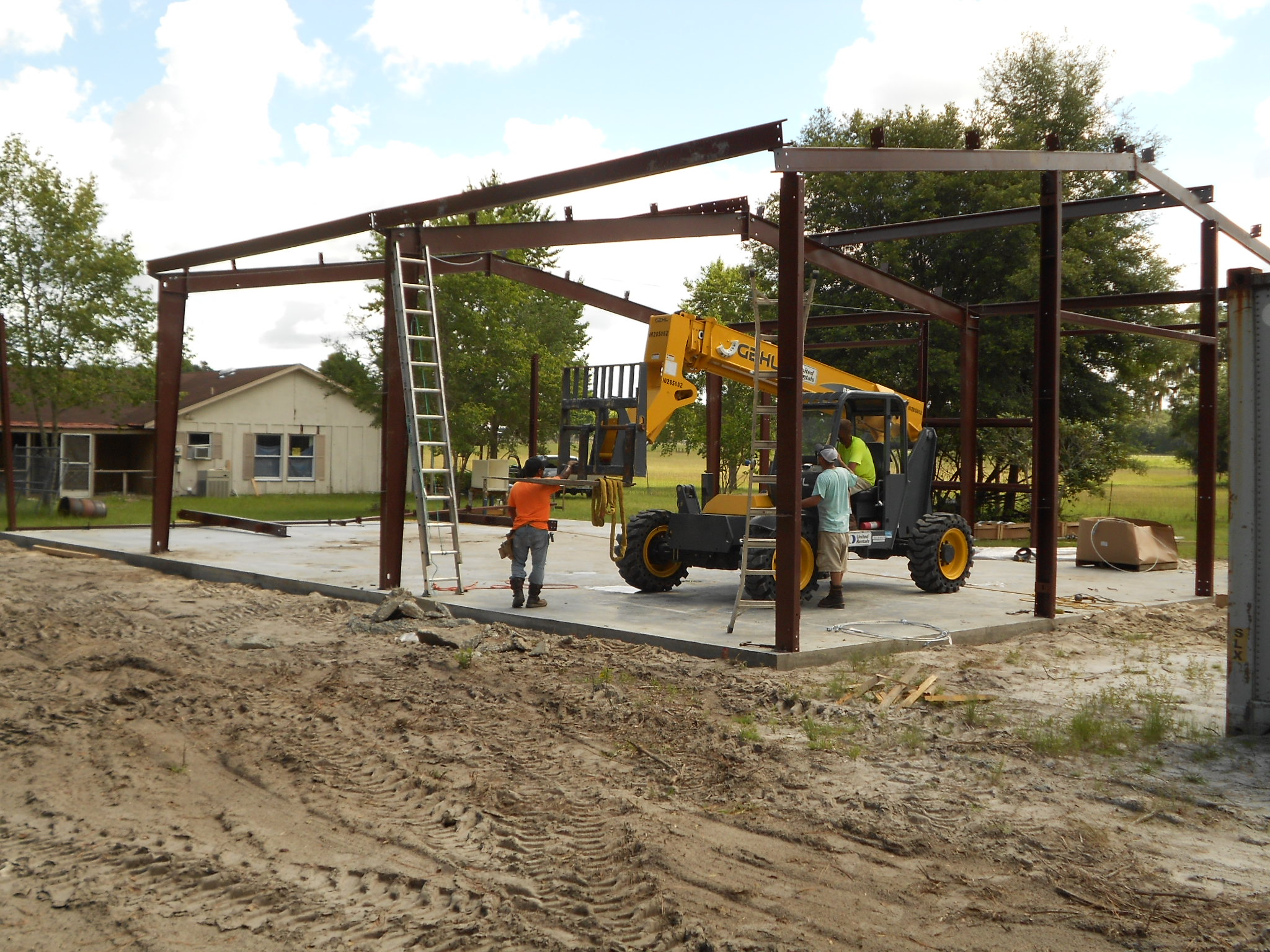

The steel barn referenced in the first post is one of the carport square tube structures, it is not as sturdy as a pole barn or a red iron steel building.
I would be nervous about one of those especially if any manure accumulates around one of those tubes, corrosion would get to it quickly.
Red iron steel building would be my first choice, followed by the pole barn.

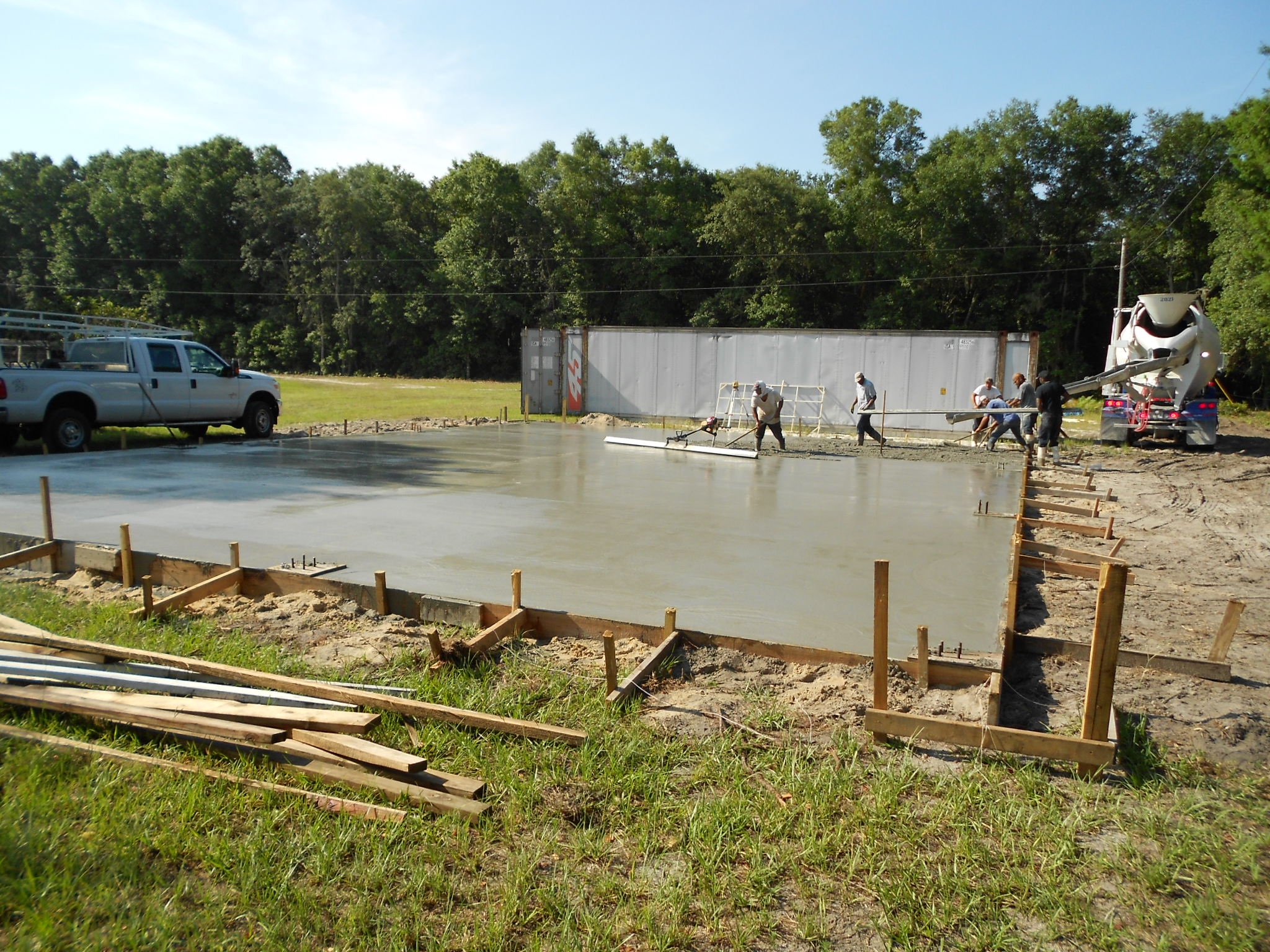

OUCH!! My concrete was $12,000. and assembly crew was $7500. on my 40' X 60' in 2015.
Your lucky you have good soil. 100 yards of concrete for my slab.

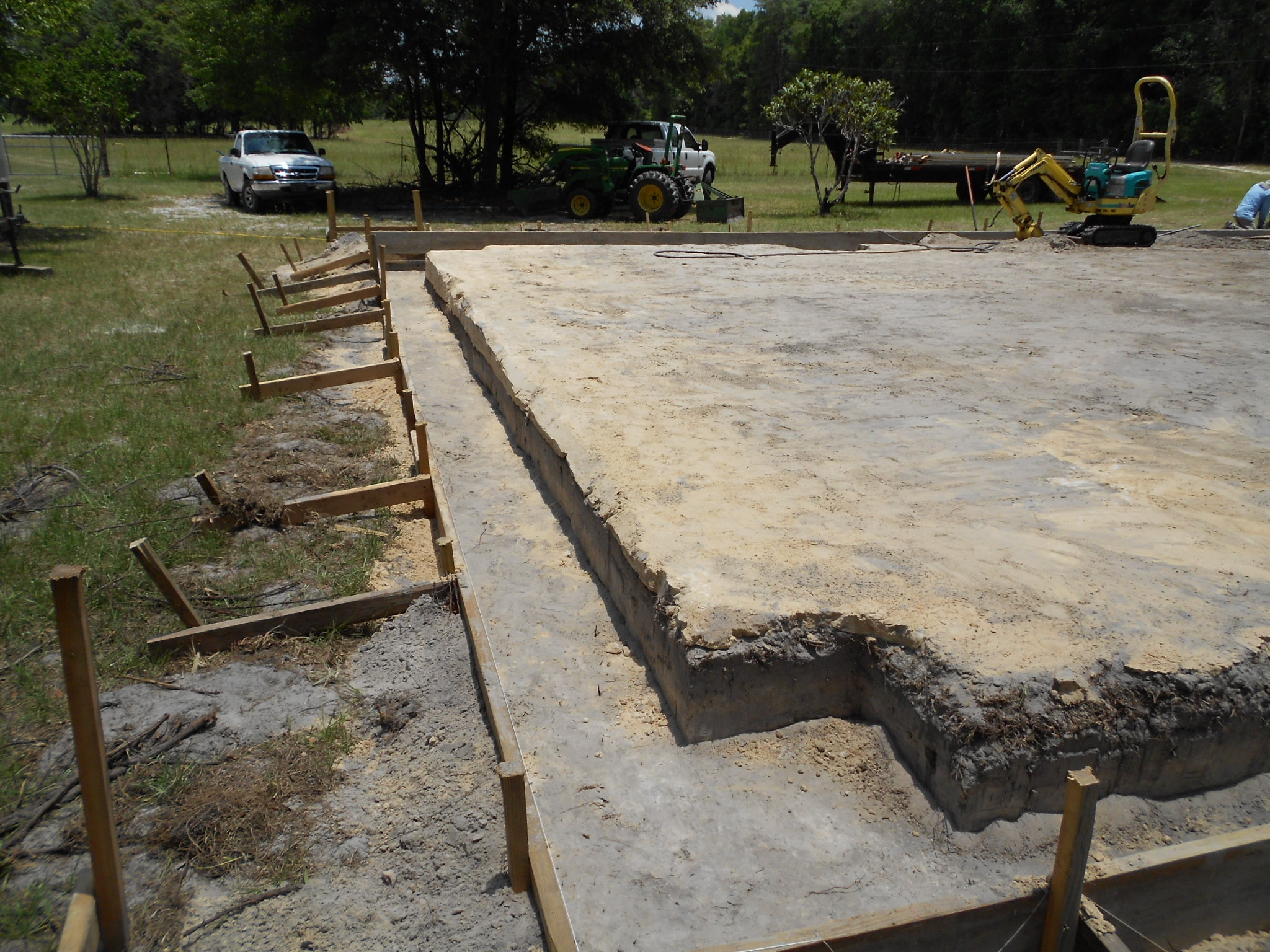

My first shop was pole design and I used it for 2 years before adding concrete. Your elevations need to be carefully planned!!!!! Draw it up as if concrete is used.
/ Pole Barn or Metal building? #34
Yep, and depending upon the engineering design, the header can reduce the overhead clearance (height of the drive in door openings) by 12" +/-.
I found a lot of differences between concrete contractors. My concrete was $17,800 but that included the rock underneath it, 42" deep footer, 42" square concrete pillars for steel posts, 6" floor, insulation, and vapor barrier - and a 2' high stub wall on one side. The key was finding a contractor who would dig the footer and not want to form it - just use the foam insulation on the outside and the dirt wall on the inside as the form - that saved about $4k I am guessing by the quotes I received.
