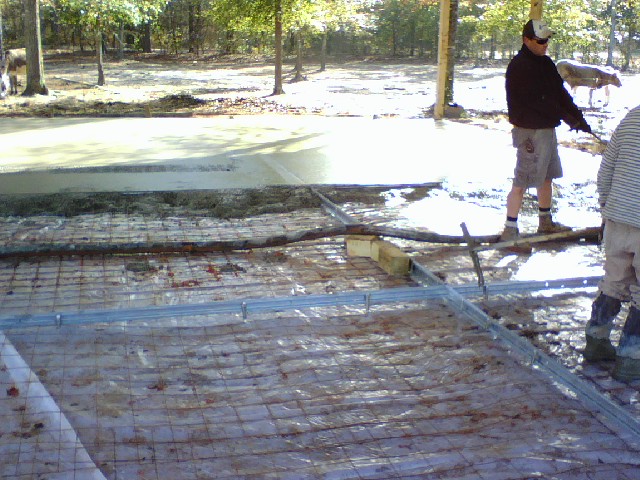

I'm having trouble locating plastic 3" rebar chairs. the local concrete supplier / brickyard only has 3" in metal, and they are expensive, over $1 each compared to about $.12 for 2" plastic chairs.
Check with hardware store for the plastic chairs. My local Menards has them.
/ pole barn concrete slab #22
Worst case, pick up some of the 1"x8"x16" concrete bricks. Break them into pieces and set the 2" chairs on top of them.
/ pole barn concrete slab #23
The 2" ones would be perfect anyway, you don't really need 3".
#24
pretty much what I was thinking about doing, put something under 2" ones.
don't have menards here, looked online, etc...
I did find one Lowes with a few 2" ones in stock.
thanks!

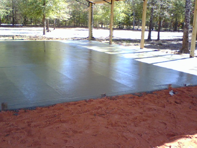

I plan to line the pole barn interior with steel panels. So I'll have interior girts. Can I put use an interior skirt board and pour concrete floor up to that vs pouring concrete between posts up to exterior skirt board before installing interior steel panels.??
/ pole barn concrete slab #26
Go with 2" chairs. don't mess with em, just use them.
/ pole barn concrete slab #27
Watch a few You Tube videos from RR Builders. They install a skirt board both inside and outside the poles and install insulation in the cavity before installing interior metal walls. The slab is poured against the 2 x 8 interior skirt board halfway up thus insulating the slab perimeter.
