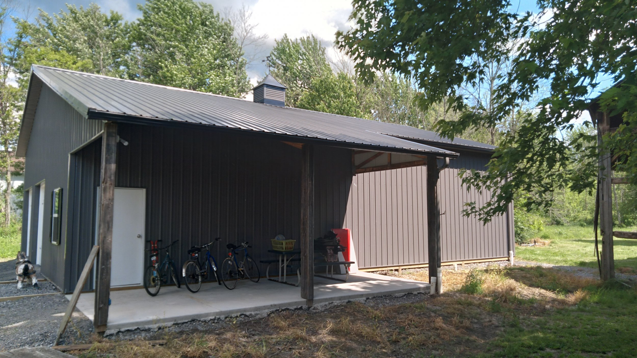

I bought a pole barn kit in Nov 2019 for a 30x40x12 pole barn for $13K. If you can do it for $14K, jump at it. You won't regret getting it built sooner rather than later. I put up the frame and put on the roof and then did the concrete floor. Finished with the walls.

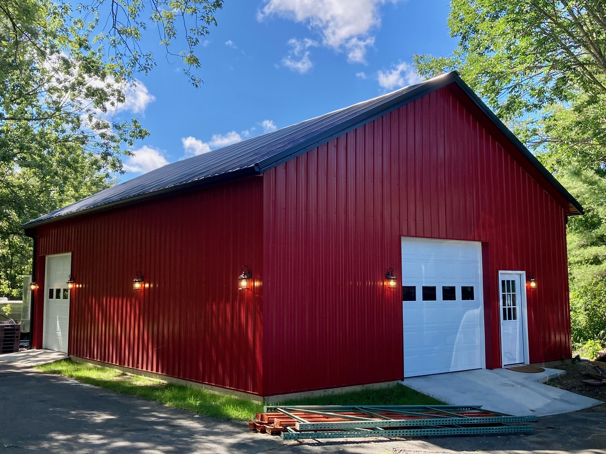

I did my floor 11 months after the building was up. I had to pay for a pump as a truck couldn’t get into the building (only 10x10 doors), but that was it. Morton does a great building. Nothing touches the ground that is wood, all concert (posts, rat board, everything).
Wow,....That seems as though you got a great price!
Looks like you have some shelving (on the ground) for an interior project.

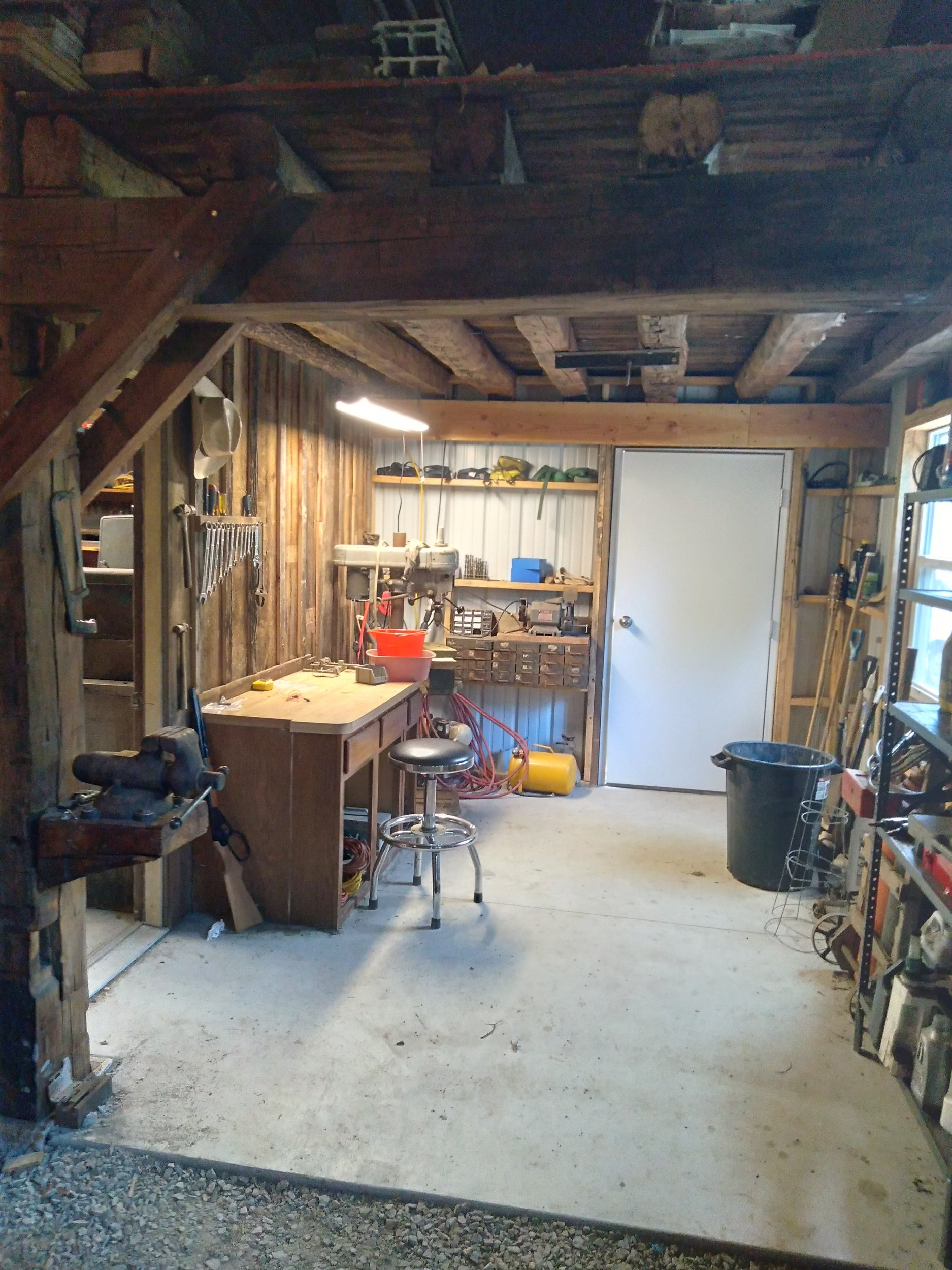

I put up a 36x50x12 with (2) 10x25 porches a couple years ago. Most of the floor is packed 1" crusher run stone, except for one of the porches and a 12x30 ft interior area under a loft that includes an enclosed and heated 12x20 ft woodshop and an open 12x10 ft metal shop, which are concrete.
I made the loft and interior shops using American chestnut lumber (hand hewn posts and beams) reclaimed from my great great grandads 1883 barn that was previously on the site.
I love the concrete floors in the shops and porch but I also like the stone floor in the rest of the barn. It is nice not to have to worry about tractors dropping a little oil or my boat leaking water from the bilge or live well plugs.
