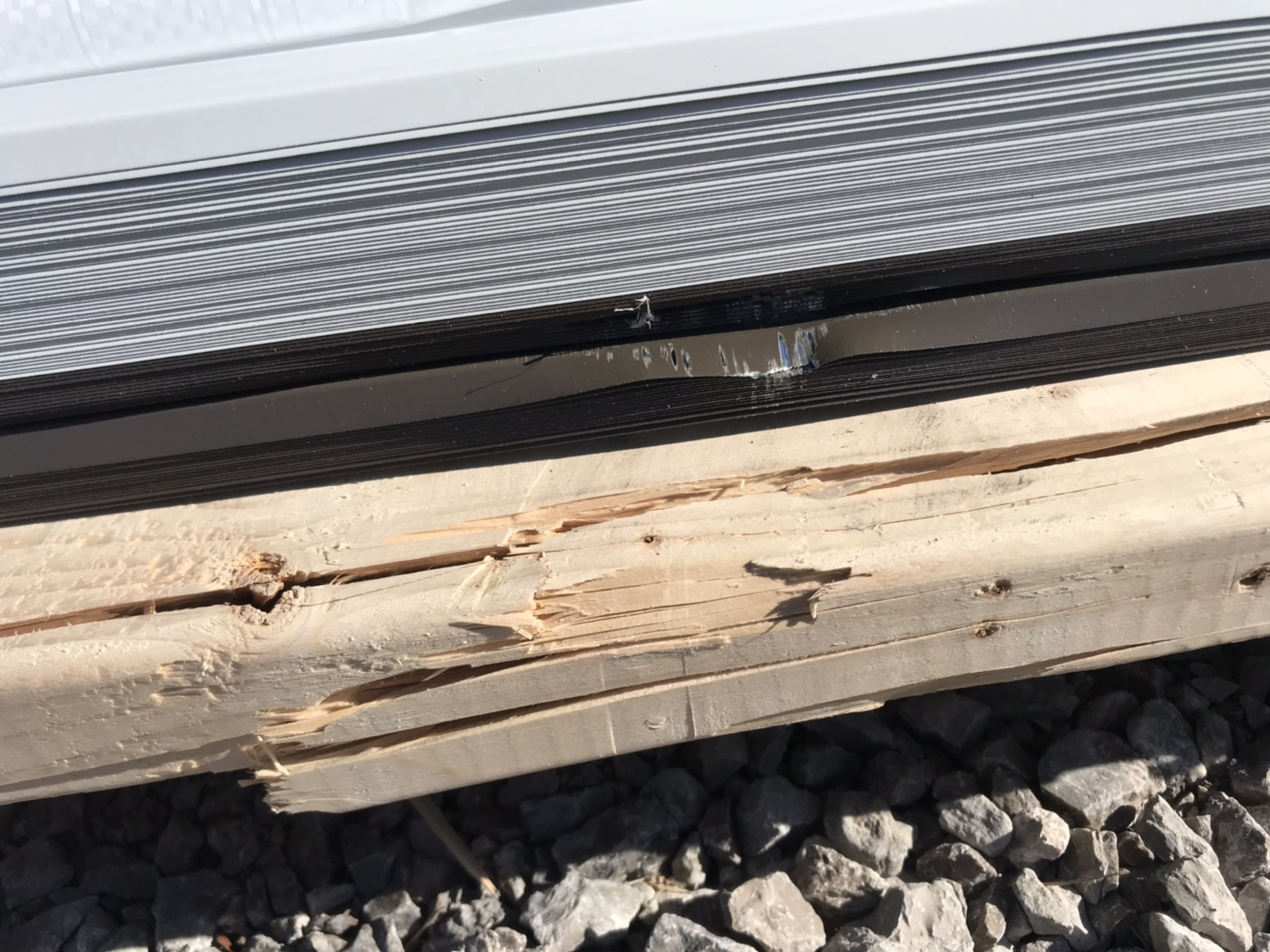

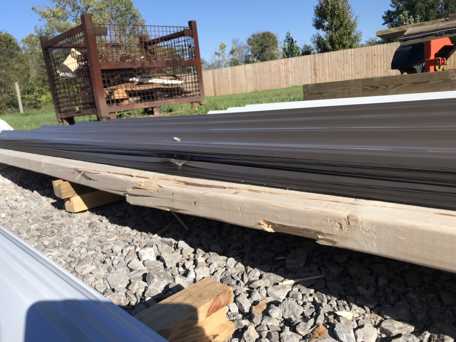

Yesterday I finally received the correct metal panels along with the overhang materials and bracing lumber that Menards dropped the ball on but after sorting through it I noticed the roof panels were hit with a forklift on the top lap of some of them.
If I straighten and use them it would stand out and I’ll have to live with the way it looks. It doesn’t have to be prefect but I paid for new not damaged material.

i just finished my house and it seems like 1/2 the stuff was damaged from careless handling.
probably not 1/2 but way to much, that damage eventually shows up in the price of stuff.
