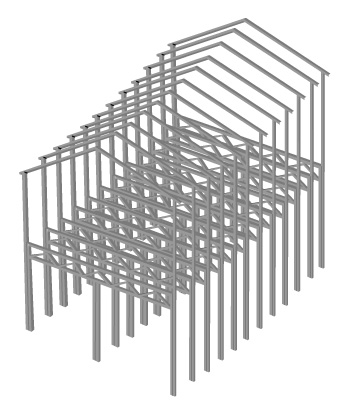

Have you ever thought about steel framed? Mine has a 20 year rust warranty, a 60 lbs psf snow load, and a 130 mph wind guarantee. I had it quoted at about 40% less than wood, installed.
You could do a 30 x 40 x 15 vertical roofed shop. Lets assume a 3:12 roof pitch so your peak height would be almost 19'. If you considered steel I'd go 12 gauge framing. 20 year rust warranty.
Of the 40 ft length I'd leave 20 ft open then have the remaining 20 ft lofted for a 30 x 20 two room setup. Make the lower level a 7ft tall story, the upper level a 7 ft tall story,and the one foot remaining would play as a leeway for the framing between both stories.Two 15 x 20 rooms are large, I'd put like a 6x8 restroom in the center of the two rooms. To support this arrangement you'd have to have the framing on 2' centers and have a column of supports on the lower level. These supports would play to your benefit when framing out the kitchen, office area, and what ever else you may do? closets,ect. The normal spacing of a non lofted steel shop this size would be 3.5 ft centers, I think, something close that made mathematical sense. The company that engineered and installed the steel frame I have didn't do the insulation, drywall, foor, or electric. I just hire subs to complete it. I was bored this morning so I did a little sketch. I also included a photo of my steel shop/office.

I hadnt really given alot of thought to a metal building to be honest.
I thought it would give me too many complications for adding a loft with electrical, plumbing and insulation.
But that might be just because of my lack of familiarity - I dont have any experience with a metal buiding. Some of the pictures Ive seen for metal buildings look good so maybe I'll ask around to see who locally have had success with metal (my immediate neighbors went timber).
Thanks for the pointer.
