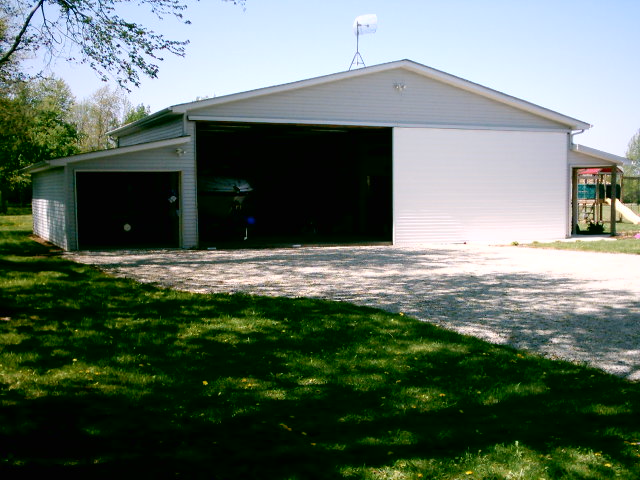

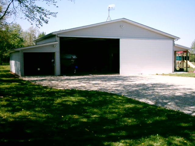

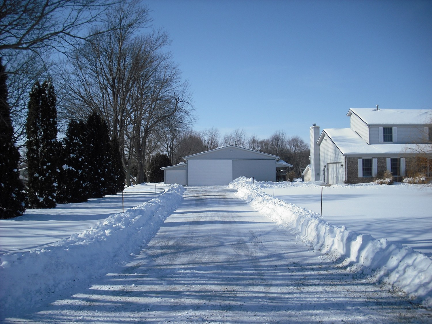

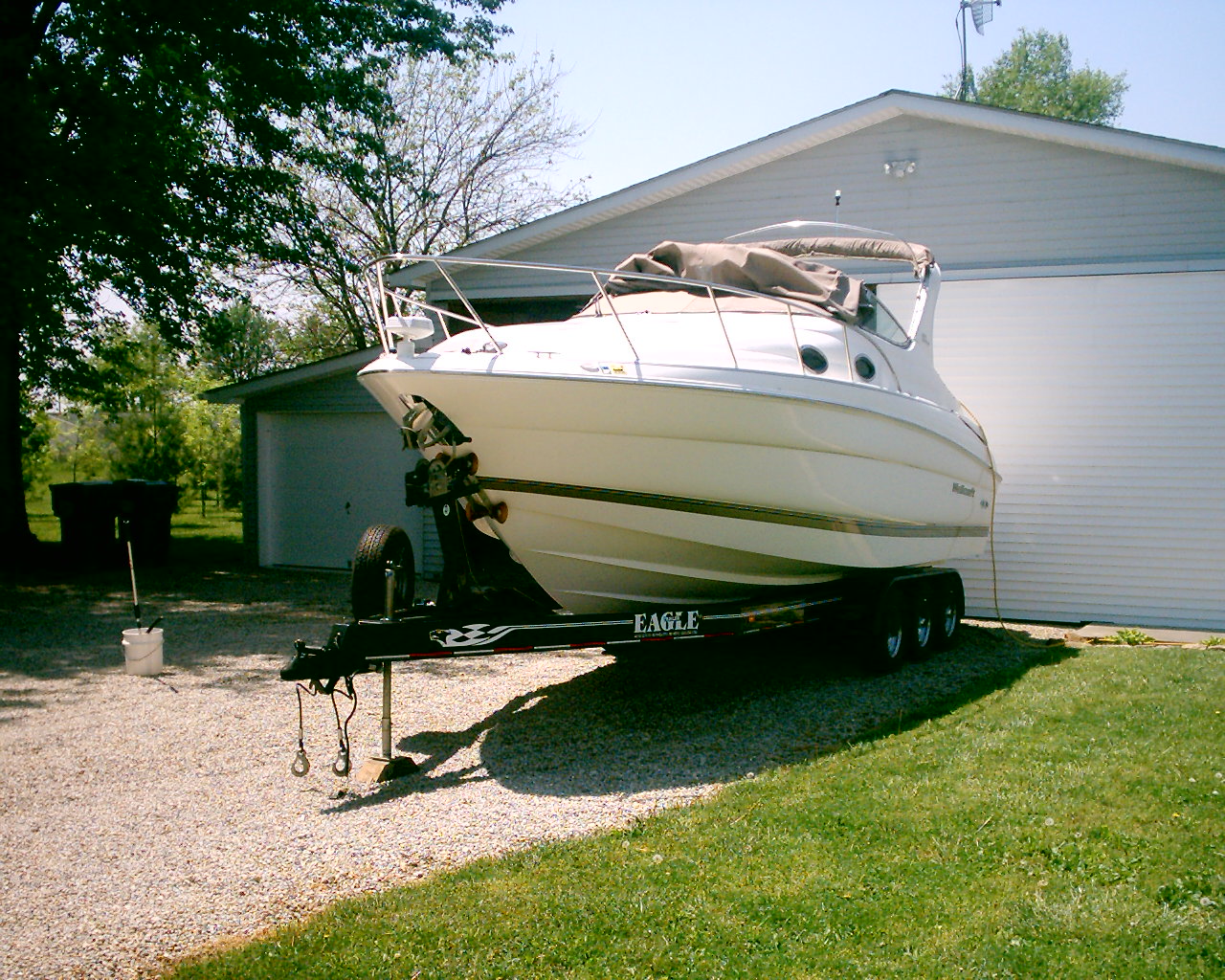

/ Pole Barn advise #28
A pole barn is little more than a big fence with a roof. I have seen and built many, Do yourself a favor and sheet the roof with osb and use 30# felt under metal roofing. This will eliminate the condensation issues.
When I built my barn it was just as cheap and looked better in my opinion to use vinyl siding and a standard 3 tab shingle roof all over 7/16" osb. Now if I would have only been smart enough to build it 14' tall instead of the 12' I did so I could get that boat in.
Chris
