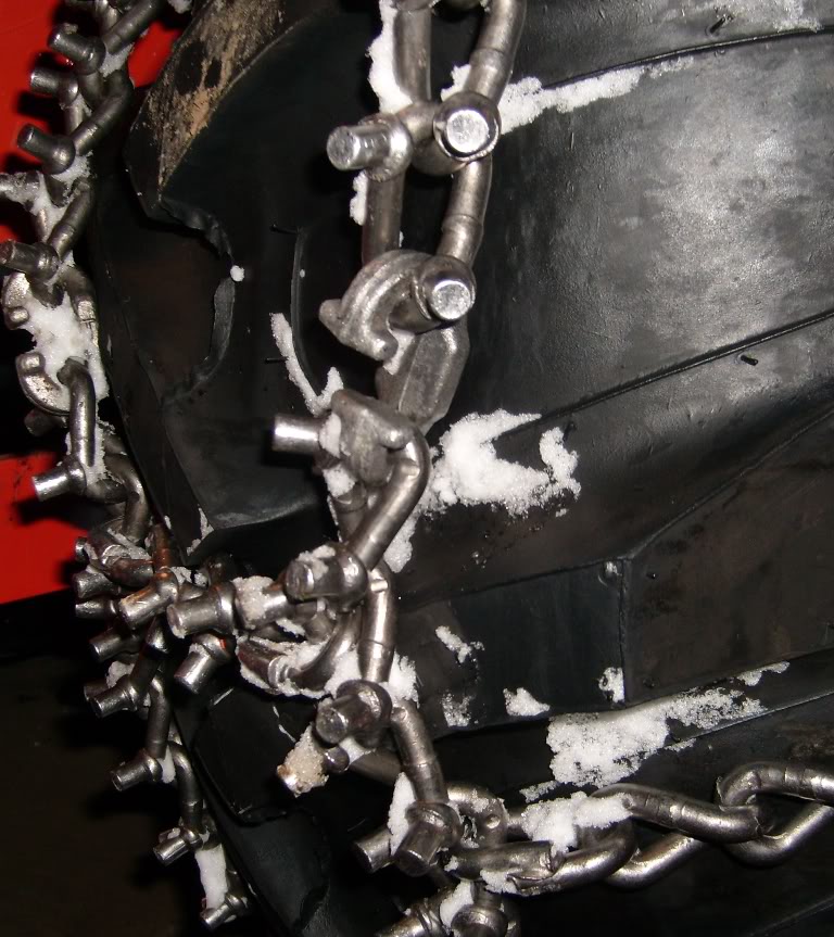

If you have hst then I wouldn't worry about going with the wider width. You can always set your pace or even stop and go on the really big storms to remove the snow. You will want some way to control the rotation of the chute, if it's not standard, get the option. The chute height being manual is not that hard to deal with. If you don't mind spending a little extra money on top quality tire chains the importer for Tellefsdal chains is in NH. The salesman drives to Vermont on a regular basis so I got free shipping (my set was over 200lbs) as the salesman just dropped them off. They weren't cheap but if your worried about getting stuck then these will put your mind at ease.
