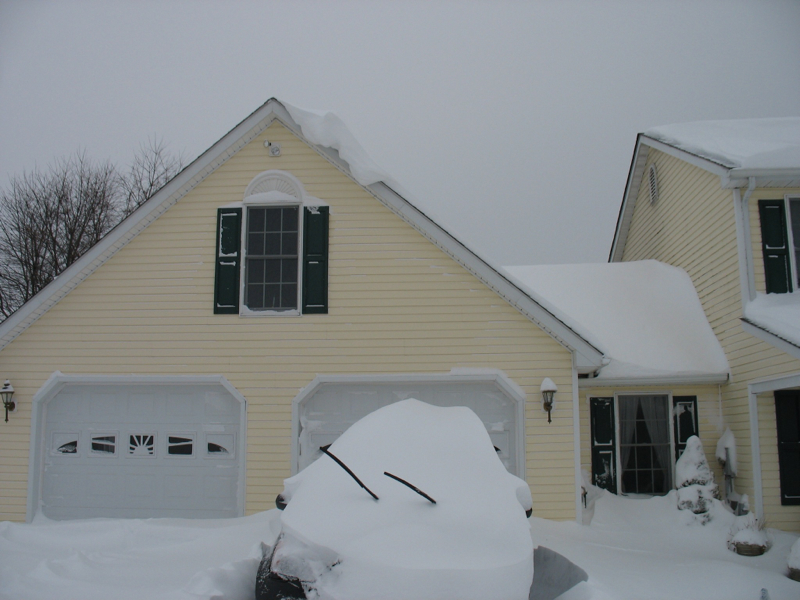

Millwood said:
Winter of 09' we had 67" of snow in three weeks w/ no melt. I plowed snow until I ran out of places to push it. I was forced to hire a skid-steer w/ blower to clear it! Stepped off the snow bank onto the roof of my house that winter. Now I have a Kubota 3300SU w/ FEL and just daring Mother Nature to give me trouble!
Do you have any pics from that winter, here's what I walked out to see after the first storm and drifting continued of course.
