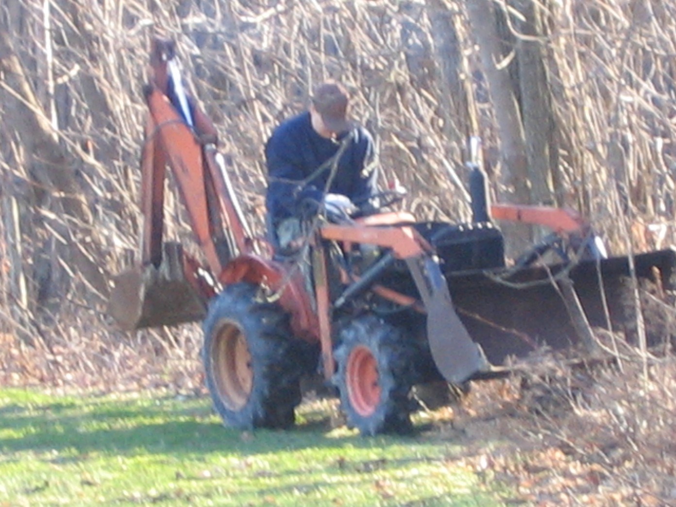

I have a 1977 Kubota B7100 that has 7549 hours registered on the meter and the meter doesn't work anymore, so hard to say how many hours are actually on this engine. My engine has a bad wrist pin, and I don't know how the bearings, rods, pistons, rings look yet. I took the head off and found the slop in the front piston, but not sure if it ruined the piston, rod or what.
This will be used on my own property, mostly for the FEL. It also has a BH on it but probably won't get used much.
My question is should I try and rebuild it or buy a used engine I found nearby with 2730 hours on it. The engine is out of a 1981 and will have a satisfaction guarantee for 90 days. He is asking $800.00 but can probably get it for less. Just seems like this would be a lot less hassle and probably cheaper way to go. We are also in the middle of selling our house and have to be out by March 30th, possibly sooner. We haven't got the closing date yet.

7549hrs vs. 2730hrs and $800.oo or less. I'd swap it and you have spare engine for parts.
/ Please Help, I need your opinion!!!!! #3
I don't see how you can rebuild it for less that $800, or even come close. If the engine looks to be in good condition, I'd swap it for the newer one.

$800 ain't to bad for a replacememt. Since you have the head off I'd spend another 15 minutes and pull the piston. Just have to pull the pan, easy on a tractor, then 2 rod bolts and pop it up and out. Not to much to lose to go a little deaper.
In my days of rebuilding I have neer seen a wrist pin fail, usually something else will go first. I have seen them fail because of human error, someone forgot the snap ring or didn't seat it properly. In that case the pin will usually rub on the cylinder wall, scoring it until the rings fail or something else. there is usually not enough room (I've never seen any), that the pin can slide sideways and come out. And in general the pin is never exposed at the bottom of the cylinder.
Got any pics?

I'll have to look and see if the oil pan will come off without pulling the engine. Not sure if there will be room to get the pan off because of the front axle.
I am quite sure the wrist pin is bad because when I turn the motor over and bring the front piston to TDC, then turn the engine over some more, you can feel the slop in the piston. Maybe it is in the rod bearing, but that would be even worse.
Looks like the way to go is with that used engine. I'll slap mine back together for now so I can at least start it to load on the trailer for when we move. Gotta convince the wife I need to buy that engine.

I'll try and get some pics for you tomorrow. I don't know if it will fit or not either, all I know is that the tractor is a 1977 with a B219 FEL and the backhoe is a B629.
I just bought this tractor used about a month and a half ago, so I am not responcible for the maintenance of it. Actually, if you ever saw the poor little thing, you wouldn't think it ever even had any maintenance done to it. It is pretty sad looking. I'll PM you about the price.
