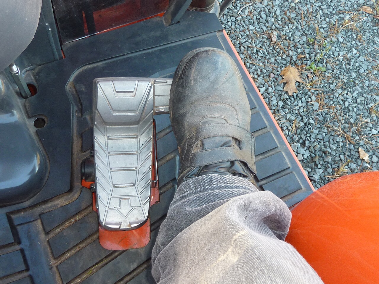

Did you try the rocker pedal on a Kubota Grand L? It’s way better IMO than the rocker pedal on the standard L’s. IMG_2690.JPG

Did you try the rocker pedal on a Kubota Grand L? It’s way better IMO than the rocker pedal on the standard L’s. View attachment 621349
Yes this is exactly like mine. Basically acts like 2 pedals. Sorry to hear there were no options for you on a lower end model. Glad to see you made a decision and are moving forward!

Did you try the rocker pedal on a Kubota Grand L? It痴 way better IMO than the rocker pedal on the standard L痴. View attachment 621349
Hmmm.... I guess it's time for another visit to the Kubota dealer for me. I've not looked at all their models, but just assumed that they were like mine & all had "upsidedown L" shaped type of rocker pedal shown in tractorable's post #43. Mine has that same pedal. and just like him I also use it in both directions by moving my foot so that I push it down in either direction using the front of my foot - just as jchonline described (post #42)....although I'd say he described the motion better than I have.
Anyway, when used that way, the pedal is a reasonable compromise between a true rocking pedal and two different pedals like most of the world prefers. And it has safety advantages for the transmission; it's impossible to push both down at once. Think about that....
What I'm saying is that I thought that ALL the Kubota models had that same upside down L shaped rocker pedal. Is that wrong?
rScotty
Unfortunately you are wrong. I personally know the L4701, MX48,52 and 5800 all have the rocker pedal and I was told because of the way they hook up they can't be interchanged with the pedal like you have. Also the tractors that do have the pedal like yours they either don't fit me or are way to big for what I need. As far as the JD vs SS Quick Attach debate my one half cent (because I am by far no expert or even a novice) based on the research I've done you can have a million implements available to you but most people only need a select few. As for me at this point I only need/want 2. That's a bucket which will come with the tractor and a grapple. Now I asked what the difference was to get the SSQA vs the JDQA and it was about $600. I just don't see paying extra just for the possibility of being able to buy something I may never need. Everything Attachments charges $50 extra to make their grapple JDQA compatible so for me whenever I get a grapple I'll just pay the $50.

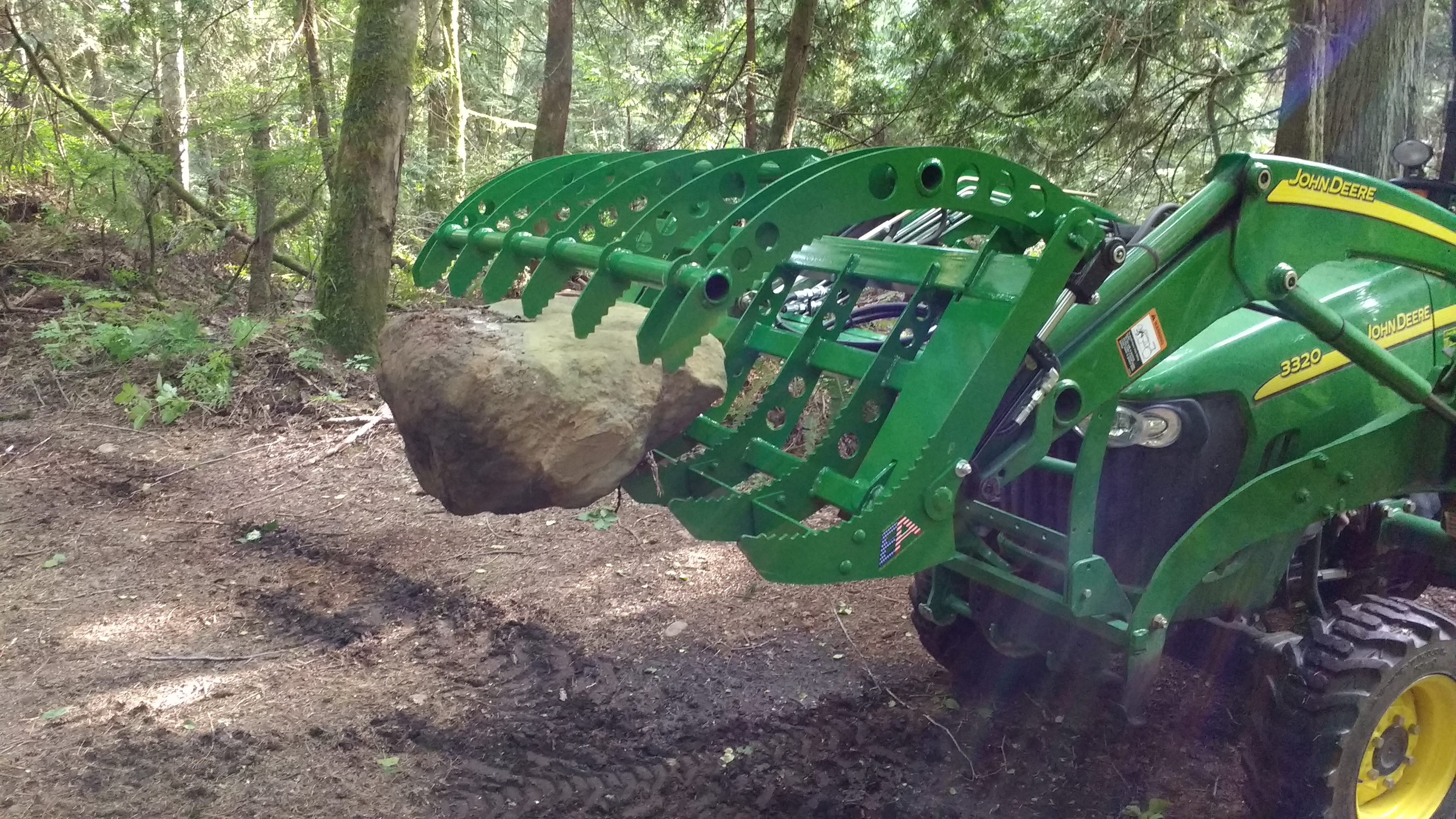

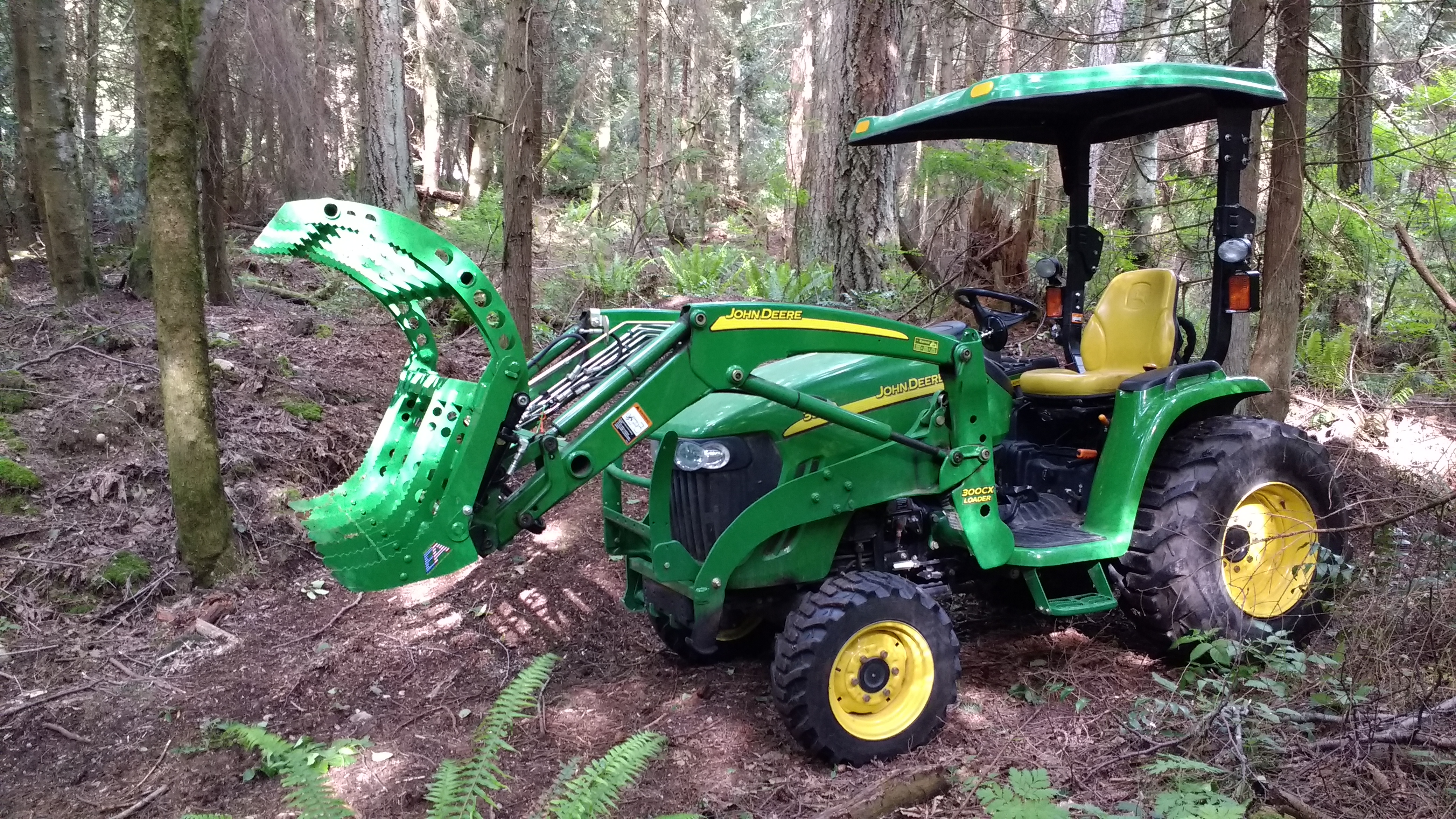

Or you could buy a skid steer quick attach plate and weld it to your grapple. The Deere quick attach has two pins and two cuffs, that can be removed. I was going to do this to my grapple when I sold my Deere 3320 a few weeks ago. But the guy I sold my tractor to wanted the grapple and gave me what I paid for it 12 years ago, which was enough to buy a Titan Implement grapple for my new tractor.
