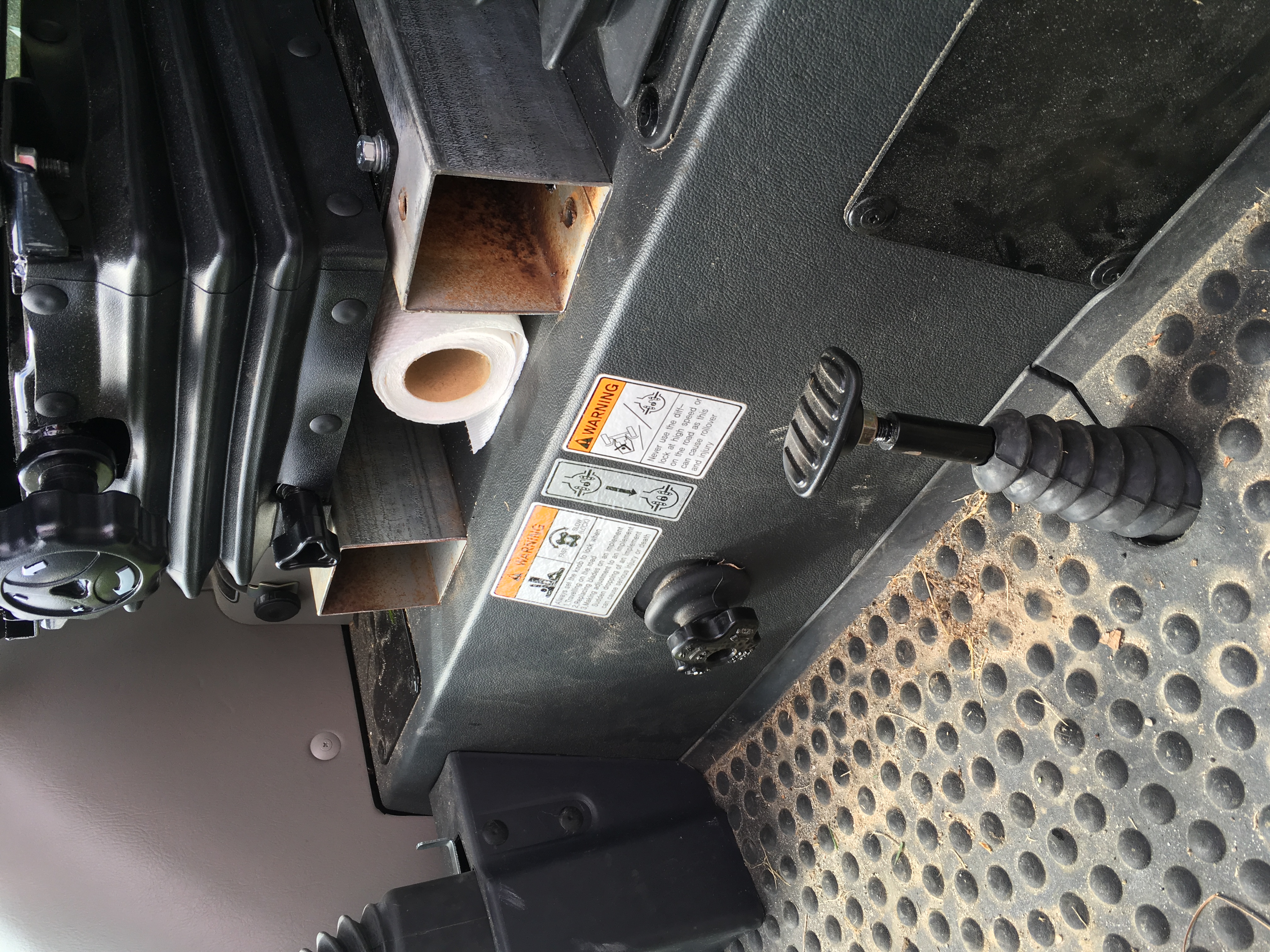

I went with the Everything Attachments 55" root rake grapple on my JD 3320, they can do JD or skid steer attach. When I bought it a couple years ago it was around $1,600 delivered.
