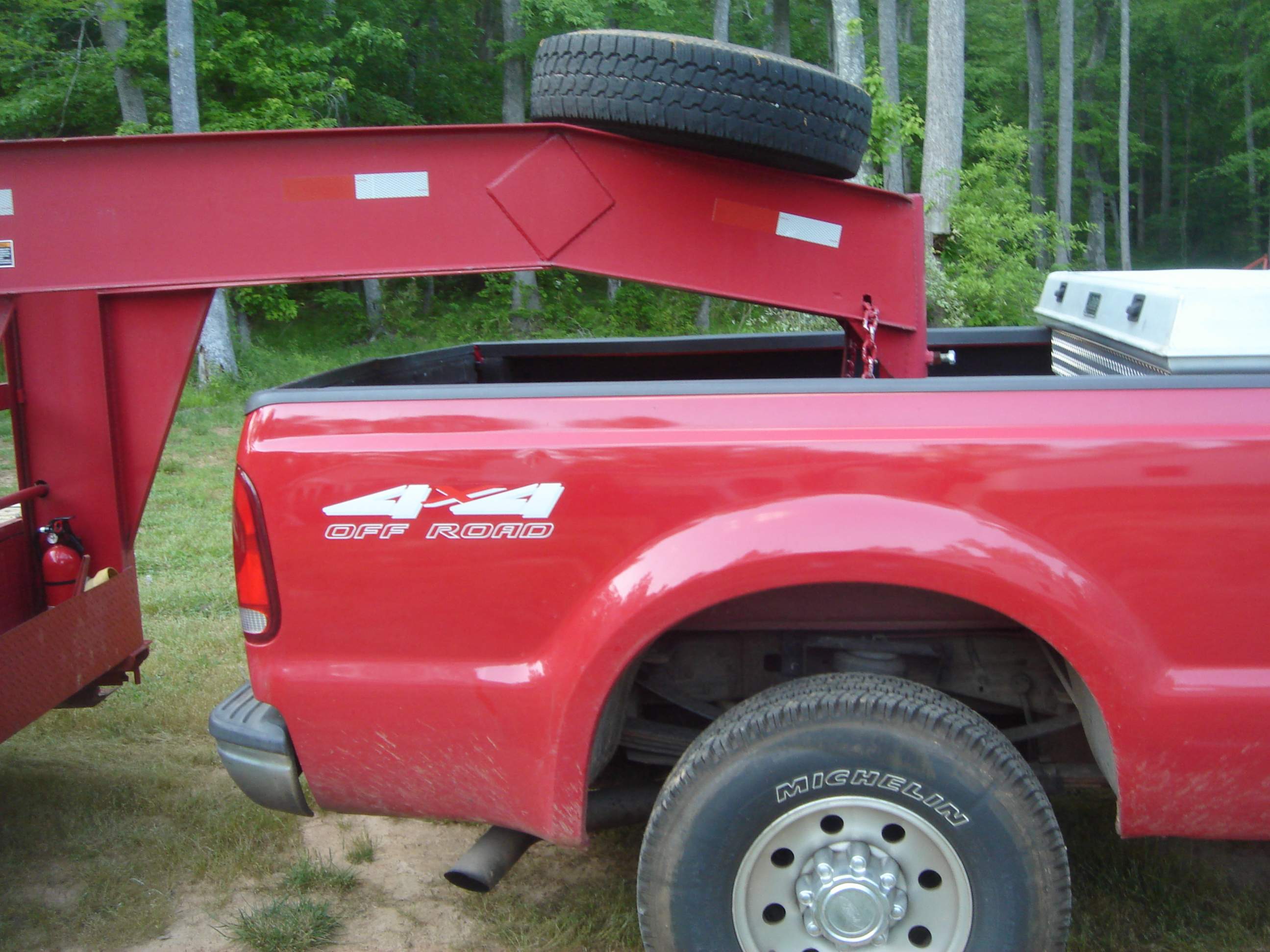

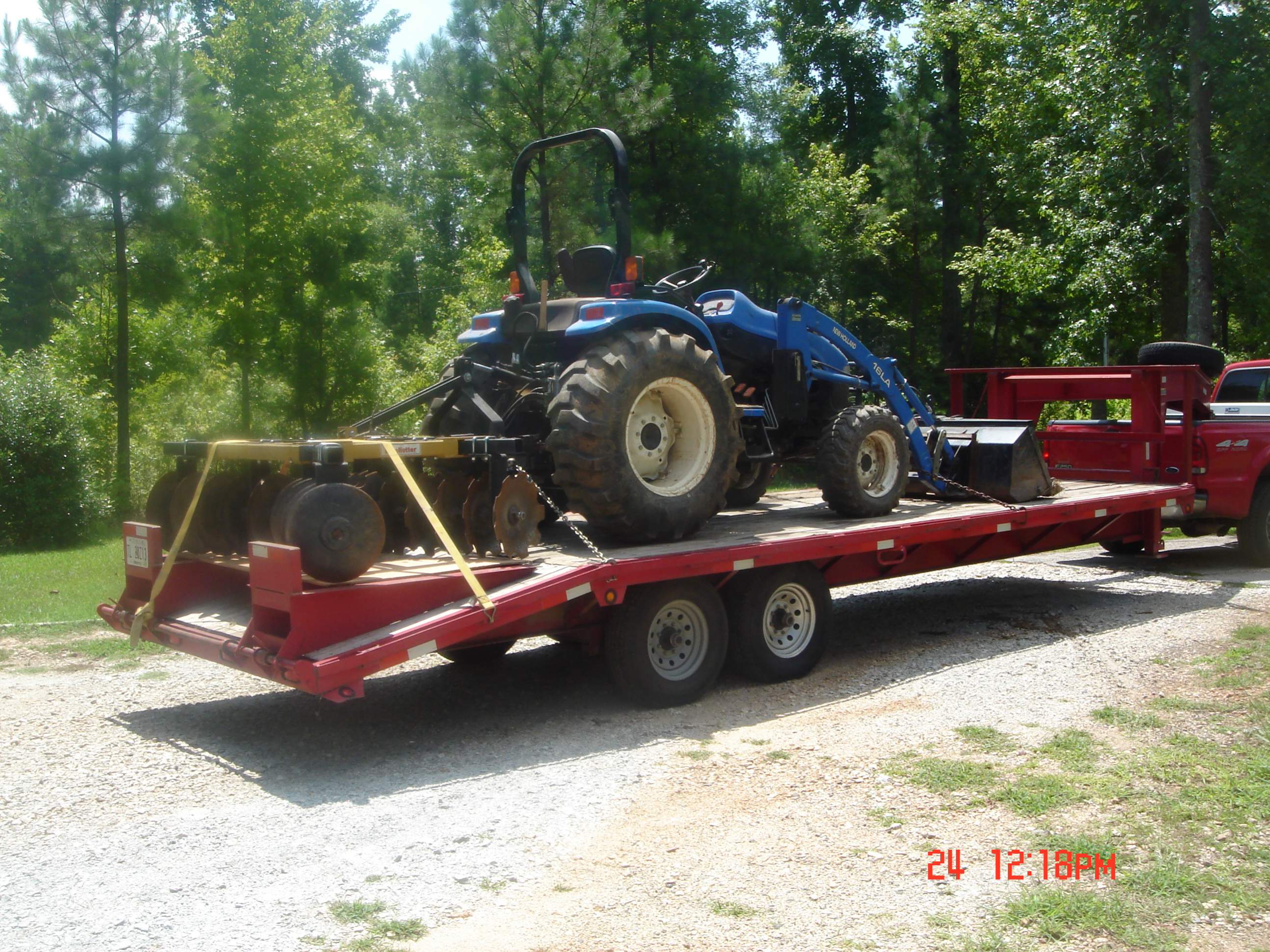

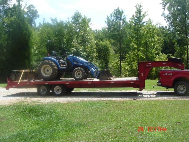

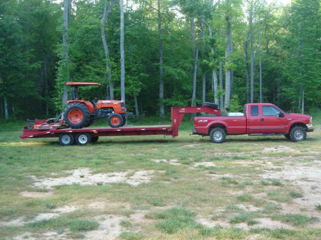

Runner..............some pics. Old trailer like you are considering, and two different tractors on gooseneck trailer. I thought I had some with Bobcat and several buckets / grapples stacked on the front but I can't seem to locate them.
Your height is fine. Our trucks are nearly identical. I have air bags on the rear of mine. In these pictures they have little to no air in them. Air bags were really installed for my travel trailer.
Trailer in picture is a "North Alabama" brand 20 + 5 deck 8 ft wide. fold flat ramps 7,000 lb axles-brakes on both.
BTW this thing pulls like a dream on the Interstate, 65 - 70 mph is like riding on air.
If you have questions...........let them rip.

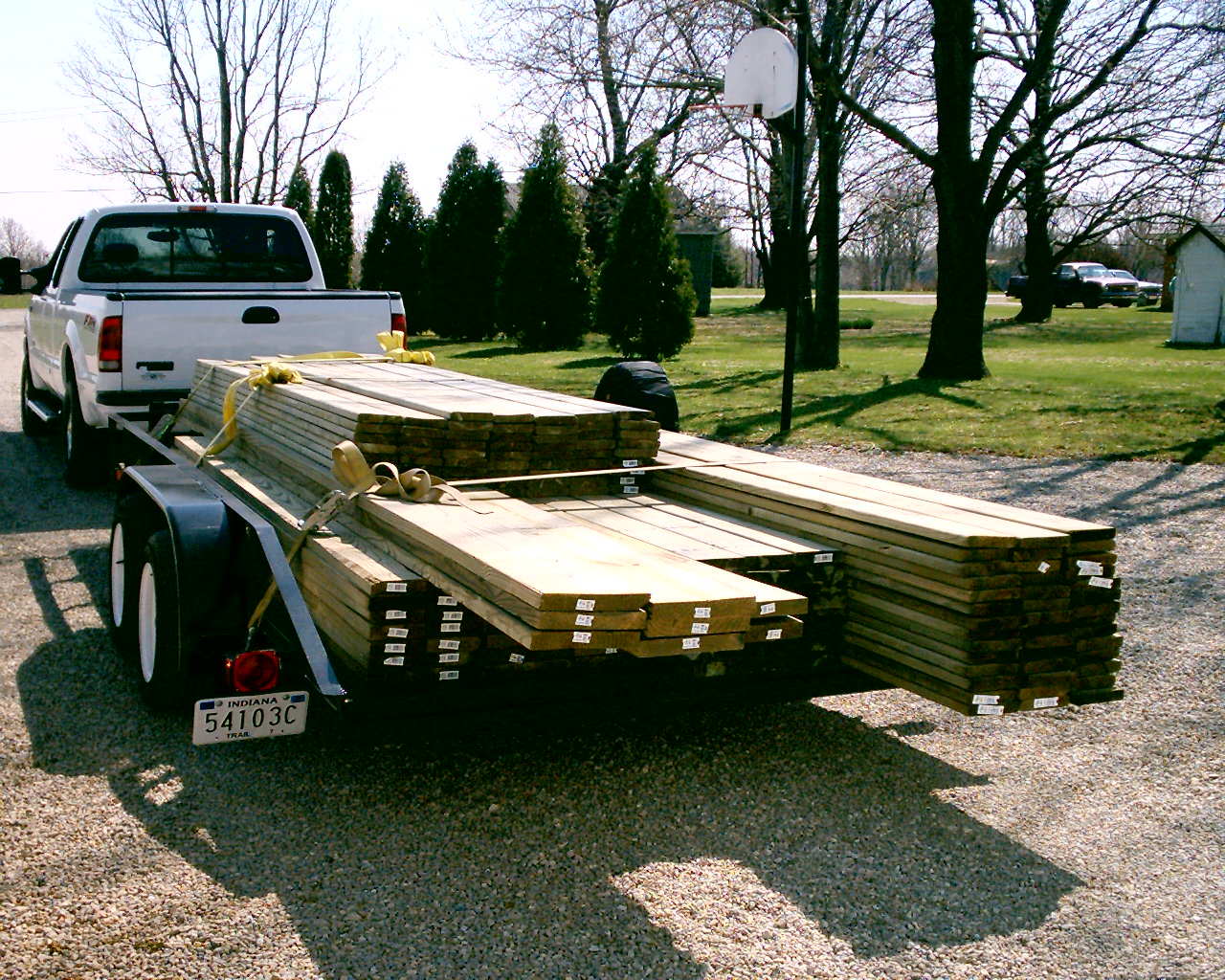

No open center. I guess its not a car hauler but a landscape trailer. Most landscape trailers are only 76" wide but this one is 82" wide and most are only 16' long and this one is 18'. I ordered it new in 2004. It has 2 3.5K axles and I had it weighed the day I picked it up. It was just a tad over 1,200# I have since added a winch, and electric brakes to bring the weight to just about 1,250#.
I have hauled my 5,200# tractor on it tons of times. It last job was rescuing a Chevy 1500 with a bad fuel pump. It has also been to Chicago to get a Hyundai, take a Suburban to Terre Haute, went to Detroit to pick up a Lincoln Aviator, and pulled about 20 cars around locally including both my uncles and fathers Corvettes. I would guess it has well over 3,000 miles pulling cars and another 3,000 miles hauling boats, furniture, tractors, ect.
Here it is behind my wifes 2004 F-250 4x4 Powerstroke. You can see how wide it is.
Chris
