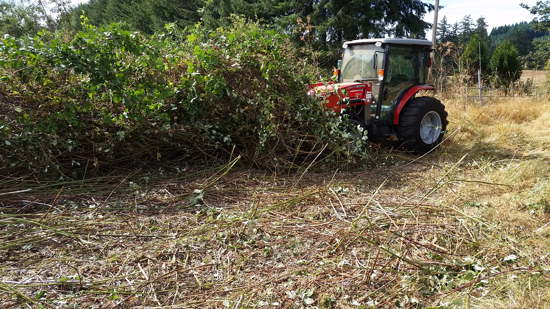

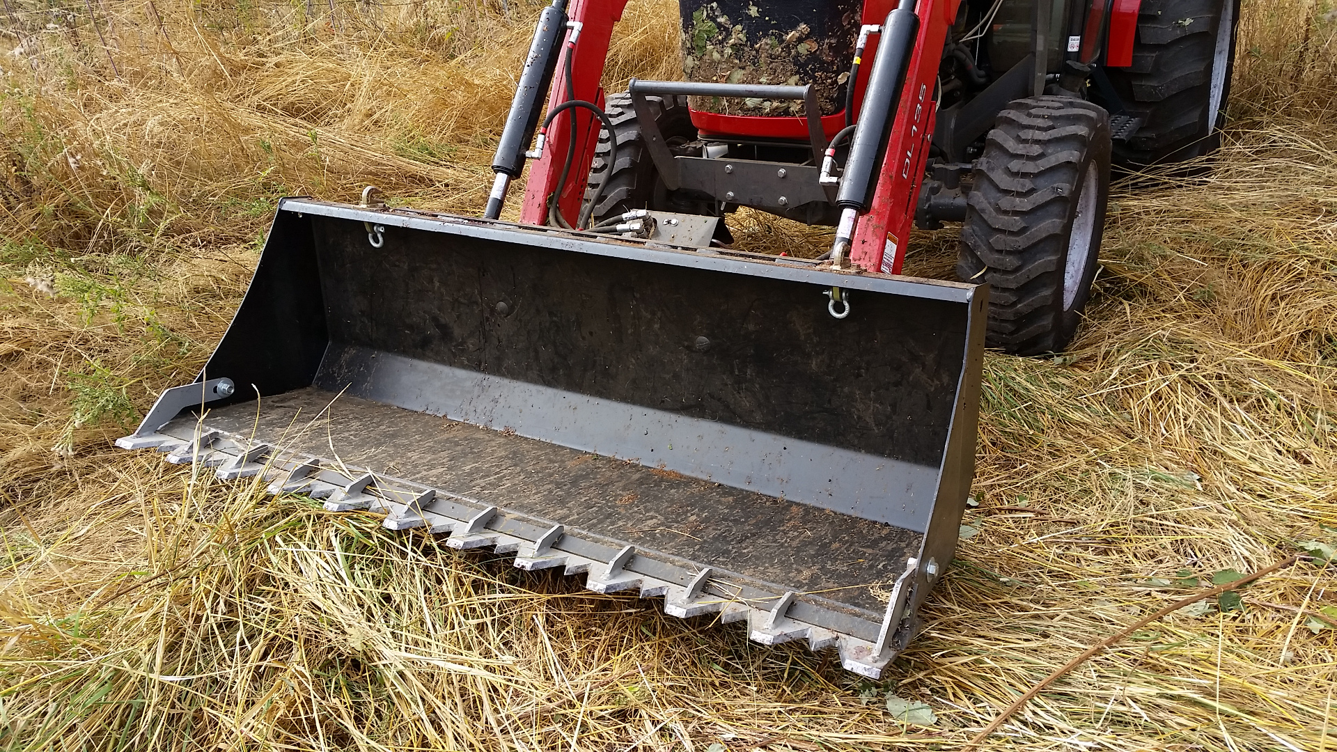

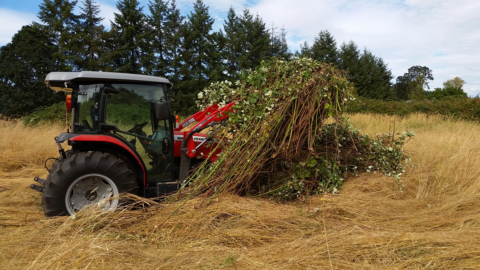

First job with the Piranha I cleaned about 80' of blackberry vines with some small trees grown up in the middle. There is a definite learning process. I managed go get one 4" diameter maple up by digging in from all four sides and then backing up a couple feet and ramming under the tree. Then wiggle the front of the bucket with the curl. Took a few minutes but finally tore the tap root and up it came. The vines were removed by scooping an inch or two under ground and doing the same wiggle. The job took two days and I did twice the work in half the time the second day after I learned a little.

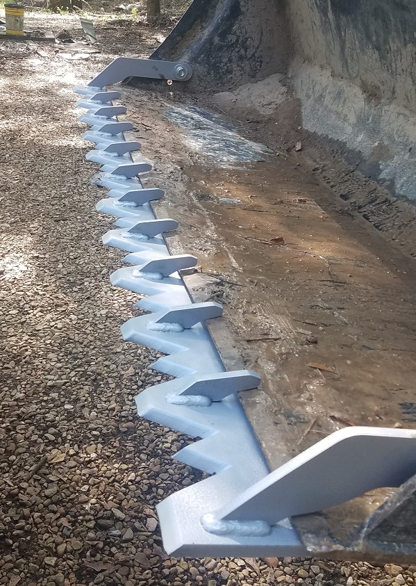

I'm on a 4145 so I'll see how a larger tractor works vs the small orange yard ones.
Got my bar last night, got up early to put it on. I work nights so 4hrs sleep is gonna be ruff tonight.
My bucket is a bit bent so getting it on was a task. I got a couple of tabs over the lip, clamped it then drove into a large oak to seat the bar.
I ordered up a gopro because I have not seen any good vids on the bar actually working. Vids to follow
