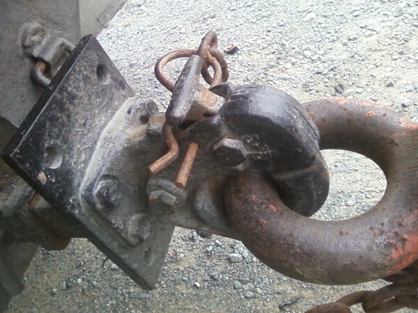

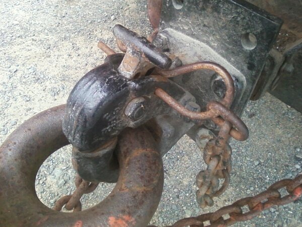

Ok here are two pictures of the lock lever locked open. The other picture is lock lever locked closed and the other without the clip installed (locked closed)

I am going to weld a bar across in front of the lever so it can release the arm but not give enough room to be able to slide the pin behind it to lock it unlocked. Then it should be idiot proof.

Neither of my two pintle hooks can have the pin put in it unless the spring loaded latch is in the locked position. Both will either lock it open or closed. But it's still not hard to see that the latch is open. You could paint the sides of the latch red or orange so if you can see the paint it's not securely latched.
If you weld it be careful what you weld as it's most likely either cast steel or ductile iron. While you're not going to be welding the hook part you are still welding a part that is integral to the hitches function.

NoBull1, Looking at your pictures it appears the safety pin is inserted under the lock lever thus holding it in the Unlocked position. Remove the pin, Push the lever down and reinsert the pin so it passes through the hole visible in the lock lever.
This lock lever should be spring loaded to the down position.

Think that's what he meant - locked open - on the posted pix.
Jim
Correct
As I said to start the pin should not be able to be inserted to make the lever "look" locked when it is not, to the untrained eye.
I would never pull the lock lever up and install the pin but two different employees of mine did.
I would think as a safety issue they would not be able to sell a receiver that being used by an untrained person, could by accident, cause a major accident. It serves no purpose I can think of to lock open.
