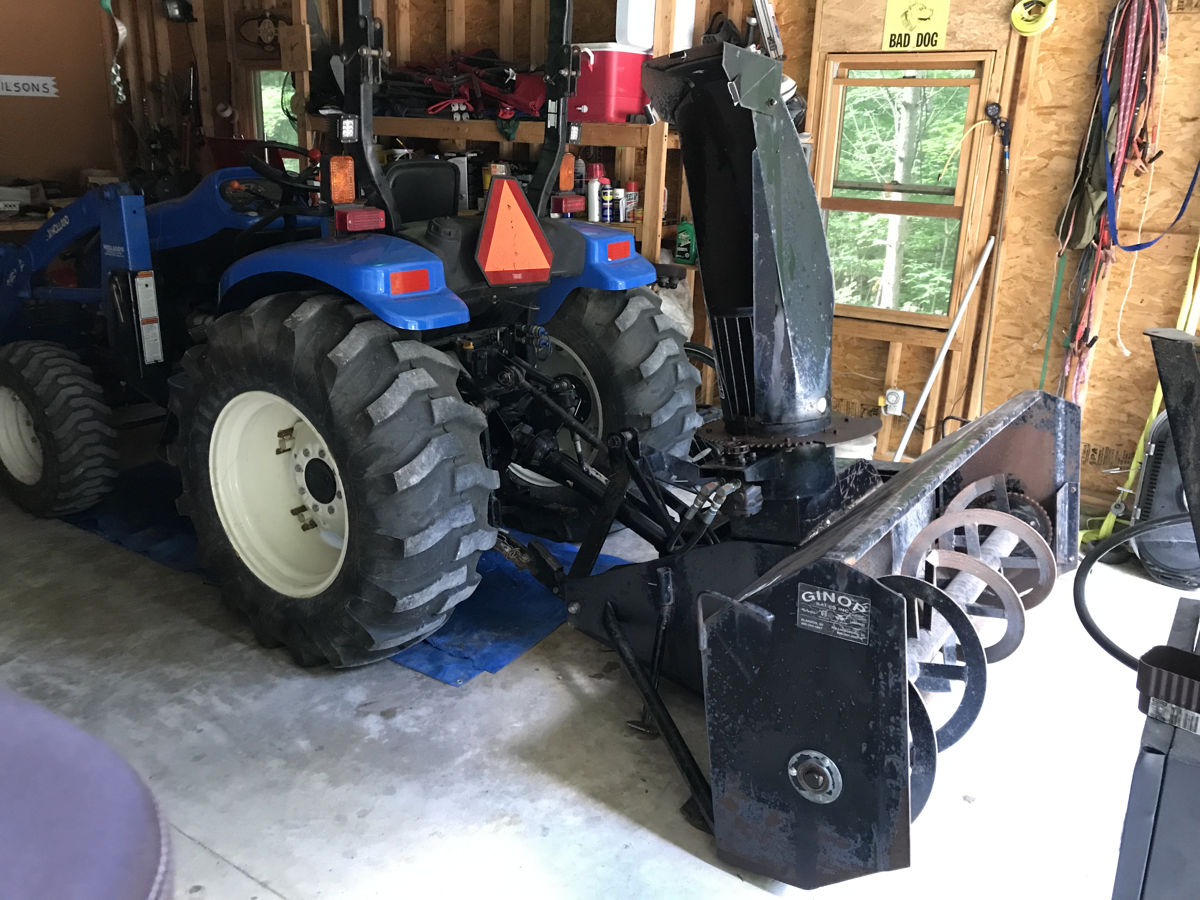

Put my blower on last week.

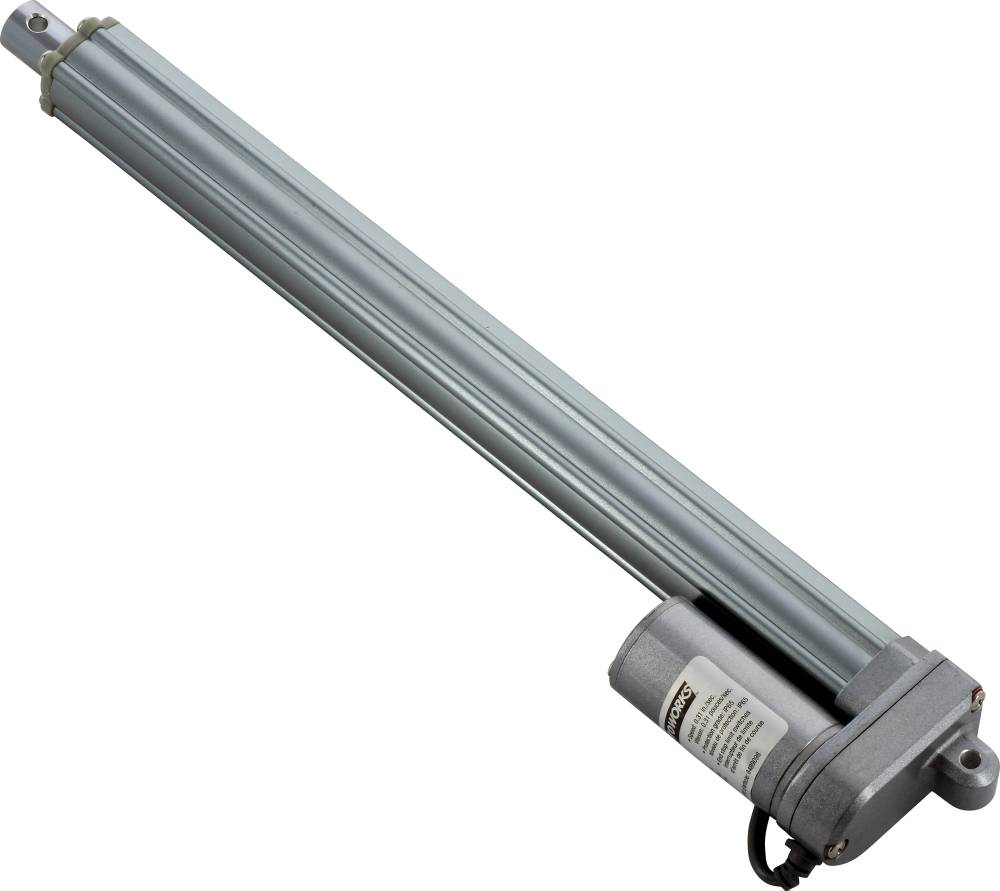

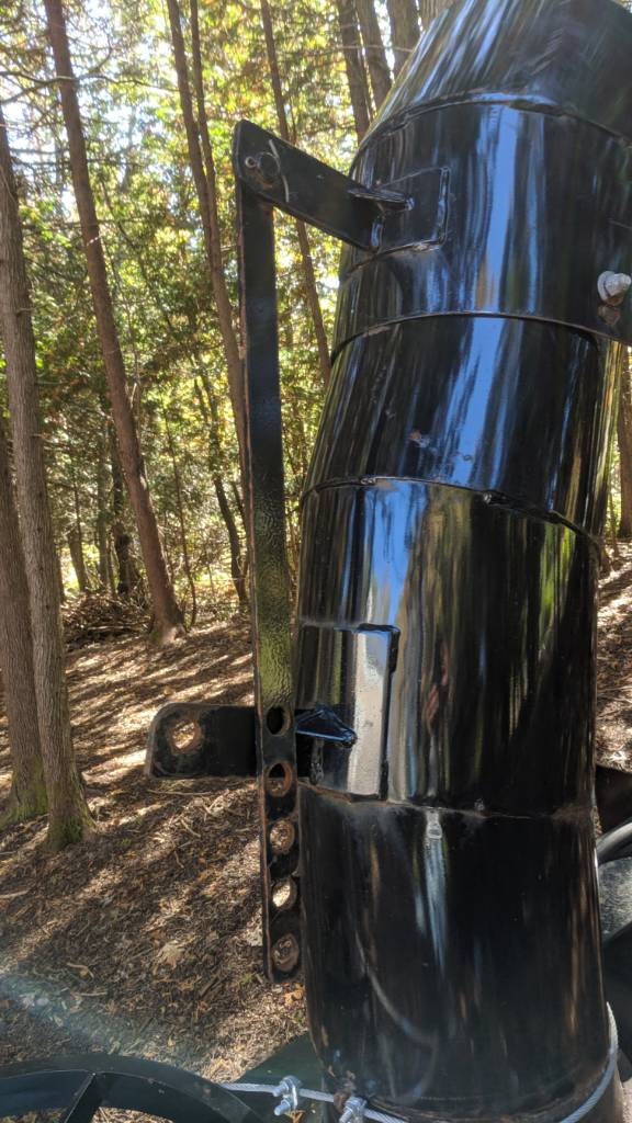

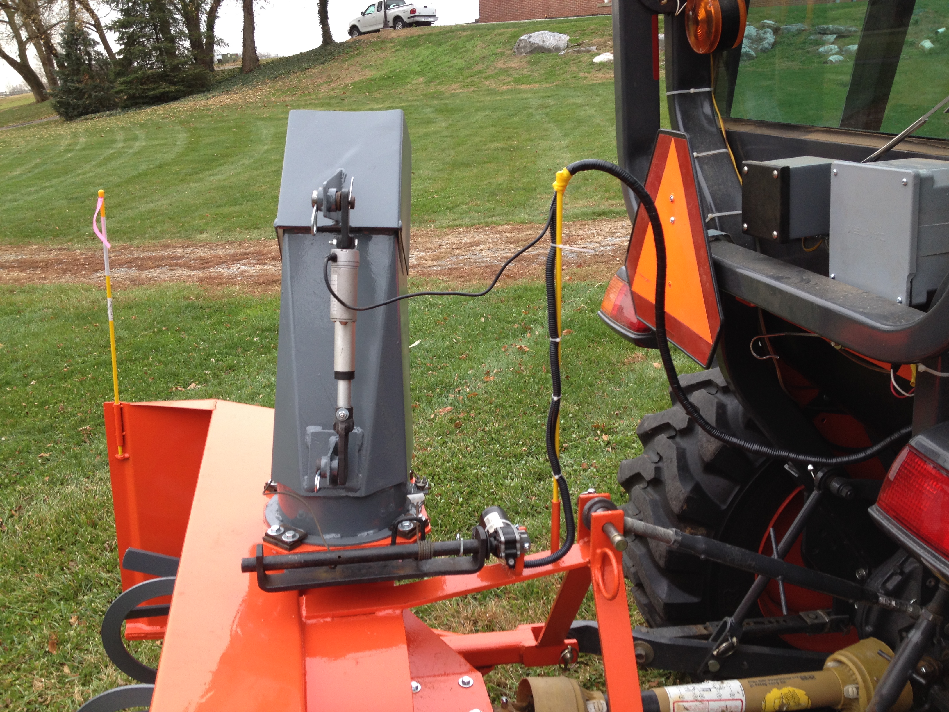

I want to replace the chute deflector bar with an actuator (see photos). The welded brackets have large holes for the pins while the actuator has small end holes. I am looking for an easy to build attachment solution.
I am sure some have solved this problem. Why reinvent the wheel. Please share photos of your solution that might work for me.
   / Pictures of your snow weapons #5,624
Drill your existing brackets for a short extension mount your actuator to the extensions.
Or if you are going to make a yoke for the actuator bolt the yoke to your brackets and set the actuator in the yoke with a small pin.

If you can weld and build some mounting brackets, this should not be a bad job to get done. Mount the screw shaft down to reduce water contamination.

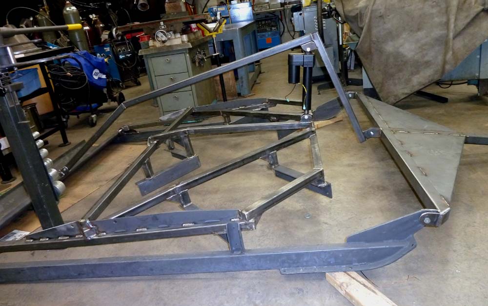

Here is a photo of an actuator I added and I built the brackets for it.

I adapted the ends to fit larger pins.
