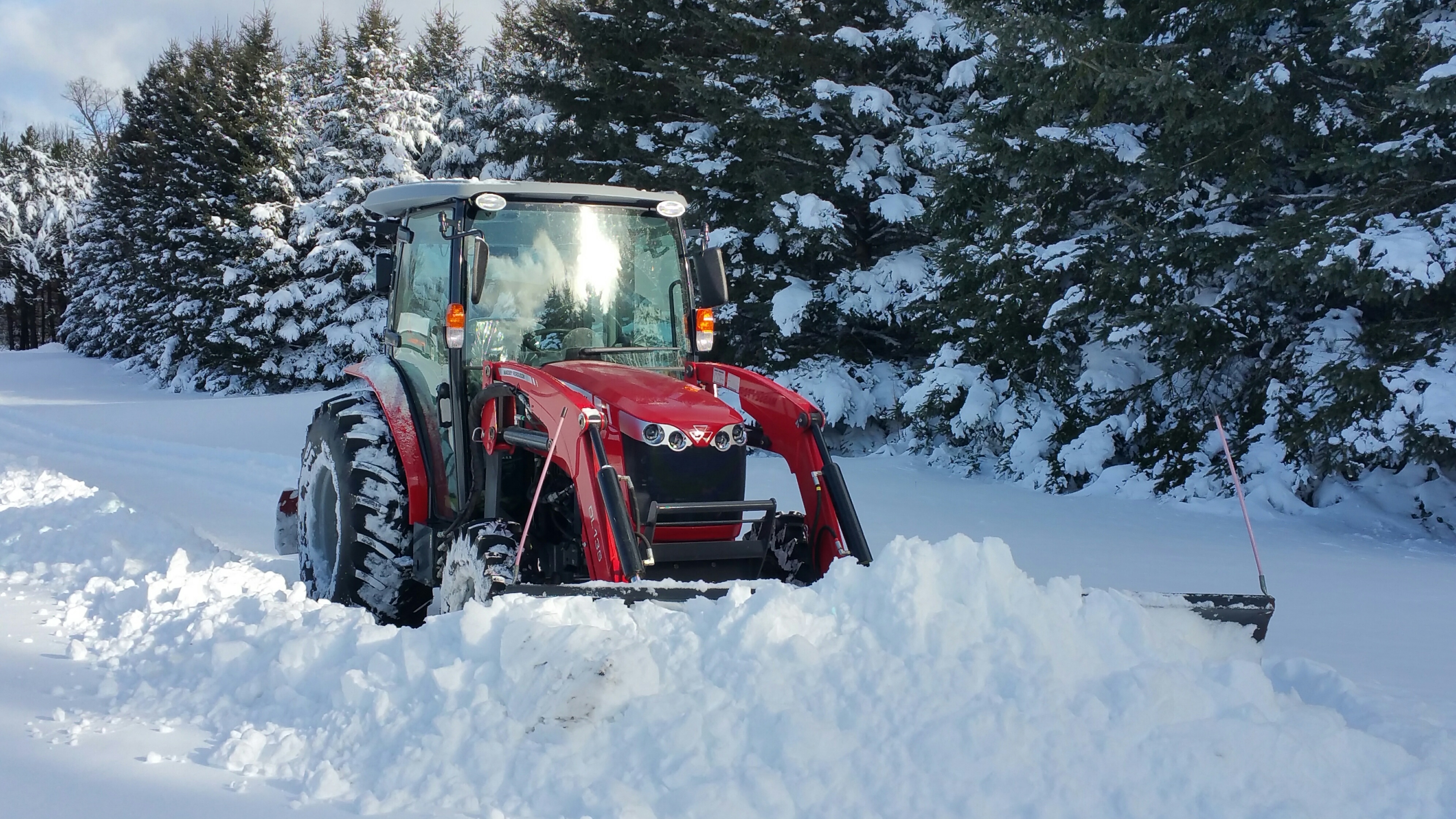

It can be fall 3 feet of snow in only 2 weeks during the winter, so I decided to be well equipped!
/ Pictures of your snow weapons #3,063
I removed the FEL to attach the subframe. I will take other pictures this week if I have the time.

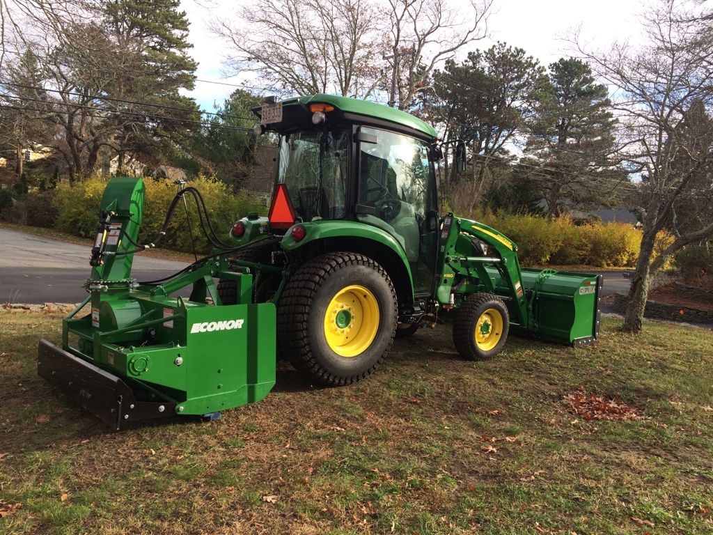

very nice, is that that the econor 68 inch inverted?
Its funny i saw a posting by you yesterday about sheyanne loader blowers and was about to ask you why you had not considered inverted - i guess you had
I love my 74 inv pronovost i think you'll really like your normand
What push box is that?

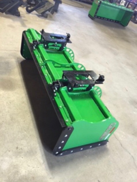

The snow box is a Grattex, I looked at a lot of snow boxes and Grattex seemed to have good design and my 6' box weighs in at 500#. The 6' scraper on the bottom is actually two 3 foot pieces and they are trip edges. IMG_4748.jpg
I wanted the 74" Provonost, I just do not have the recommended pto horsepower. I have to say the 68" Inverted Econor is really nice for half the money and they even made mine as requested with a bolt on scraper bar, which I adapted to Tivar. I ordered it last April and got it in September. I can't wait to try it out.

strictly speaking- i don't have the recommended horsepower either (jd 3720) but it works quite well and i like that i could go up a size in tractor and it will work well. Pronovost has rear push blowers with same size auger and fan that don't show the same hp requirement.
i think the reason for this is that the primary market for inverters is commercial and there is an expectation of fast blowing speed in that type of use.
I got a great deal on my blower i (spring leftover) so everything worked out
1 thing i have noticed is that the weight of the blower leaves the front pretty light so scraping with the bucket and blower raised means i end up steering with the brakes. Would love to add front weight but it looks like the loader blocks the mount
I am about to put some flow restrictors in the chute and diverter hydro lines because they are operating way too fast- have you noticed any issue with yours?

I almost bought the pronovost and ignored the pto hp requirement because I am not in a race to get my work done. You bring up a good point I looked at too, the weight for the Pronovost with all accessories was about 1100#, the Econor is 595# plus about 150# for the back blade which makes it nicely balanced with my front end loader bucket or snow box. I have to say I am completely happy with the balance of my machine and the Econor blower, it is a very heavy duty blower.
I do have restrictors on the chute deflectors and they seem to work at the right speed, the chute rotators do not have restrictors, they work fine without them. We actually have 2 exact machines set-up identical, it is a lot easier with the rear blowers than the old front mount John Deeres we had, they took all day to set them up and we lost our loaders for the winter. The rears just hitch up to the Imatch, attach your hydraulic lines and your mostly good to go.
