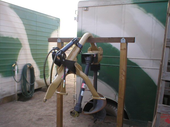

Here is a pic of mine. All Land Pride stuff.
