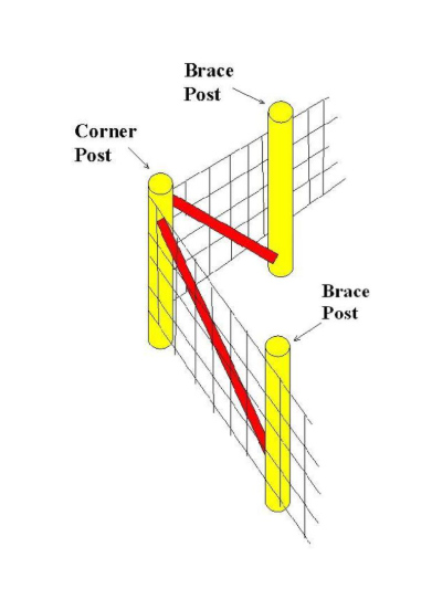

OP 1) put your fence on the outside of the posts, as the staples will work out over time, when on the inside.
2) Are you using treated timber? I have been told that horses chew treated timber for the salt in the treatment.
3) I am in New Zealand. We always run fence in straight section with stayed/braced corners. Going in a curve means you MUST stay each post otherwise the post will pull in over time and you have a slack fence.
4) Note,Deer farmers have found that slack straining internal netting fences for deer mean that when deer run into the fence they are tossed back without breaking their neck, like with a traditional tight strained fence. Would this work for spooky horses as well?
This thread is the first time I've seen the suggestion (saw the same about the boards/nails above). Everything else I've read states that putting the wire and boards inside is stronger as if an animal leans/presses against it, it's the strength of the boards + posts that resists them, vs just the staples or nails holding the board or fencing to the post.
Are you suggesting the staples will work out over time only if they're on the inside? Or that they're going to do that no matter what, so being on the outside makes it less of an injury risk for the animal?
Yes will be treated lumber. Most likely we will have a coat of black paint over it so hopefully any salt or other minerals won't be as obvious from a simple "lick" or the board :)
This makes sense to me, but in practice I wonder how much force is really exerted on each post for a gentle curve if they're spaced 8' apart and it's a 5" round post. Regardless I'm going to do my best to keep runs straight and used braced "corners" for any change in direction.
I believe it was the Bekaert installation guide that suggested if you are installing on a curve, to angle the posts 2" towards the outside of the curve. Here's the quote:
If your fence must curve, reduce post spacing in the curve area. Keep fence wire on the outside of the curve. The spacing change required will be determined by the severity of the curve. The sharper the turn the more posts it will require. A very gradual curve will not require post spacing to be greatly reduced. Set posts on curves with a two inch lean to the outside of the curve.

If you are doing any radiuses (radii) [as opposed to hard 90 corners] have the posts in the radius pitch out a few degrees (3-5 ballpark) otherwise when the wire gets pulled around the curve the posts will get pulled less than plumb creating over time both out of plumb posts and loose no climb. We were on 15 acres with 1.5mi of fence/cross fence and used a mower mounted string trimmer so the radiused areas were purposely chosen to make string trimmer easier. Choose your donkeys carefully (likely geldings for this job) and they really need to be raised with the animals they are guarding. Lots of anecdotal stories about donkeys using sheep and goats as playthings. We raised mini donks for a long time so not quite the same as standards in terms of herd protection capability but personality and temperment is everything for herd protection. Pyrenees, Maremma, Anatolian all better choices than donks. We did our no climb 20 years ago but the 2 options then were either 25 or 50 year galvanized wire or 50 and 100 year - we went with the longer and it was still good 17 years later when we sold. This was in FL only 20 miles from the gulf.

If you have curves, a fence under tension will ultimately make it sag, regardless of how you set the posts unless you put braces (standoffs) inside the curves. Not a problem if they will be on your side. They don’t work as well on the outside of the curve. The problem here is mowing along the fence line where the standoffs are.
