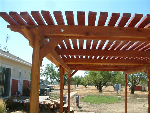

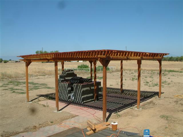

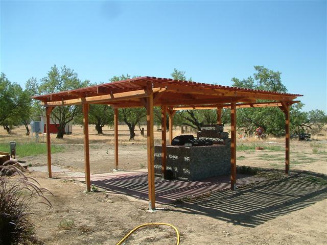

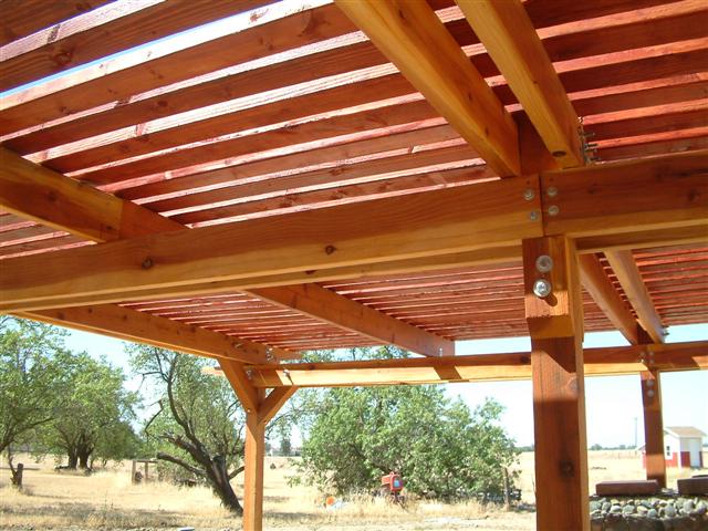

Here's the 20x20 ft pergola I built 4 years ago to shade the patio.
4x4 redwood posts
Doubled 2x6 redwood beams
2x4 DF lath stained redwood color
Simpson post bases
1/2" dia bolts/nuts
1/2" lag screws in the knees
Good luck with your pergola
