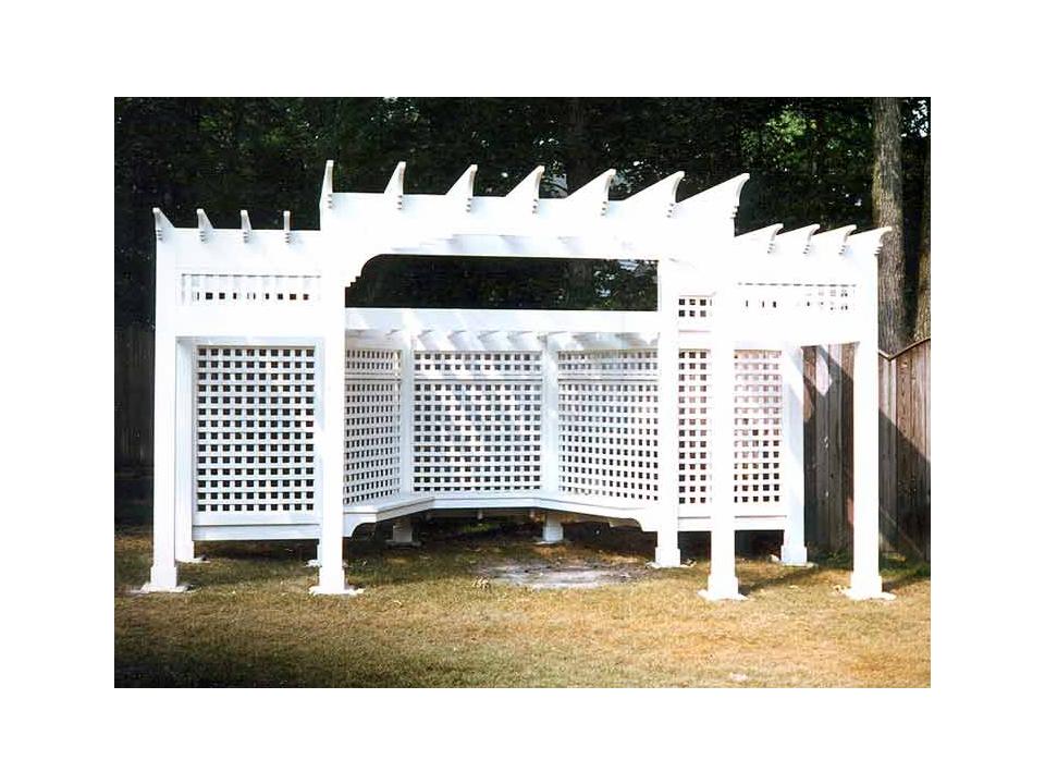

Tollster said:
We would like to put a gazebo type structure over the seat and grow some wysteria. Along with some type of japanese garden and trees.
With some minor modification, something like this maybe?
Hard to believe the crew had never done anything like this before. Absolutely awesome job!
