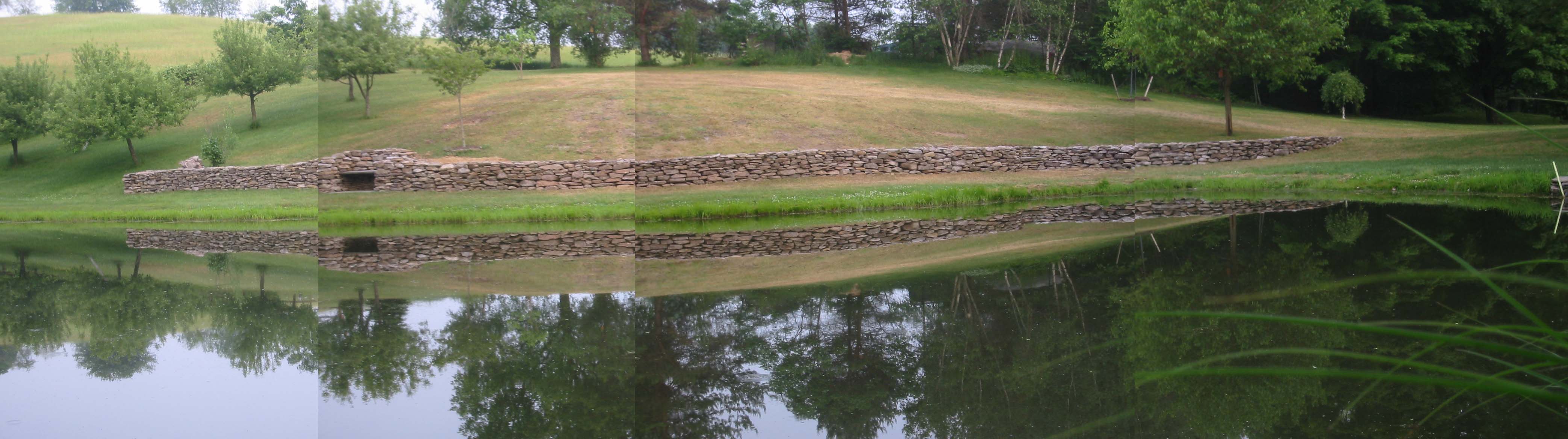

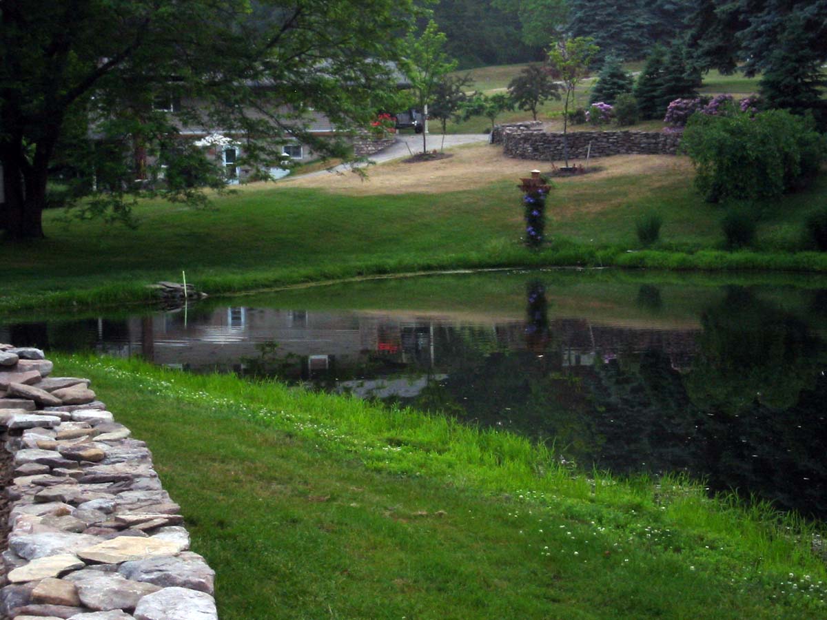

I have pics on my home computer, I had to merge the pictures in photshop due to the length of the wall. I looked around at the local stone yards at pallets and they wanted 139.00 per pallet for 3000lbs. The I was out riding my motorcycle in the country and saw where they where harvesting the stone from a local farm. I stopped in and asked how much a pallet if they load and I haul. Price was 80.00 a pallet. Thats where I met the workers and hired them on as they where off memorial day weekend and the following saturday.
I made allot of trips but cut out allot of overhead and the middle man...Total was around 4k for 260' of wall install. I backfilled on my own with 2b, roughly 16 tons. Still waiting for my account to stabilize before I order the topsoil triaxles.
My wife was apprehensive about the second wall, but at that price I had to move. Funny thing is, those hands had never built a wall before. I cannot wait for ya''ll to see the pics. I watch them from a distance and they did not pick up the first rock they came to, they actually found the ones that fit, which is why I wanted to show some courtousy. If I had hire someone else I kind of feel like it would not have been as nice and 4 times as much. Customer service seems to be lacking aorund these parts. Close to wilkes-barre red-rock area in NEPA.
Heres the pics I promised.

WOW. It looks to me like they did a great job. The wall really sets off the rest of the area. Nice looking property you have there.

Very nice. Pond pic looks real peaceful. Any plans for a gazebo or something down there? Were the guys that layed the stone masons or something, a stone and cement gazebo there sure would be nice.

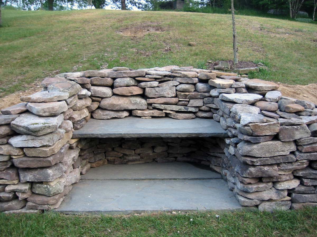

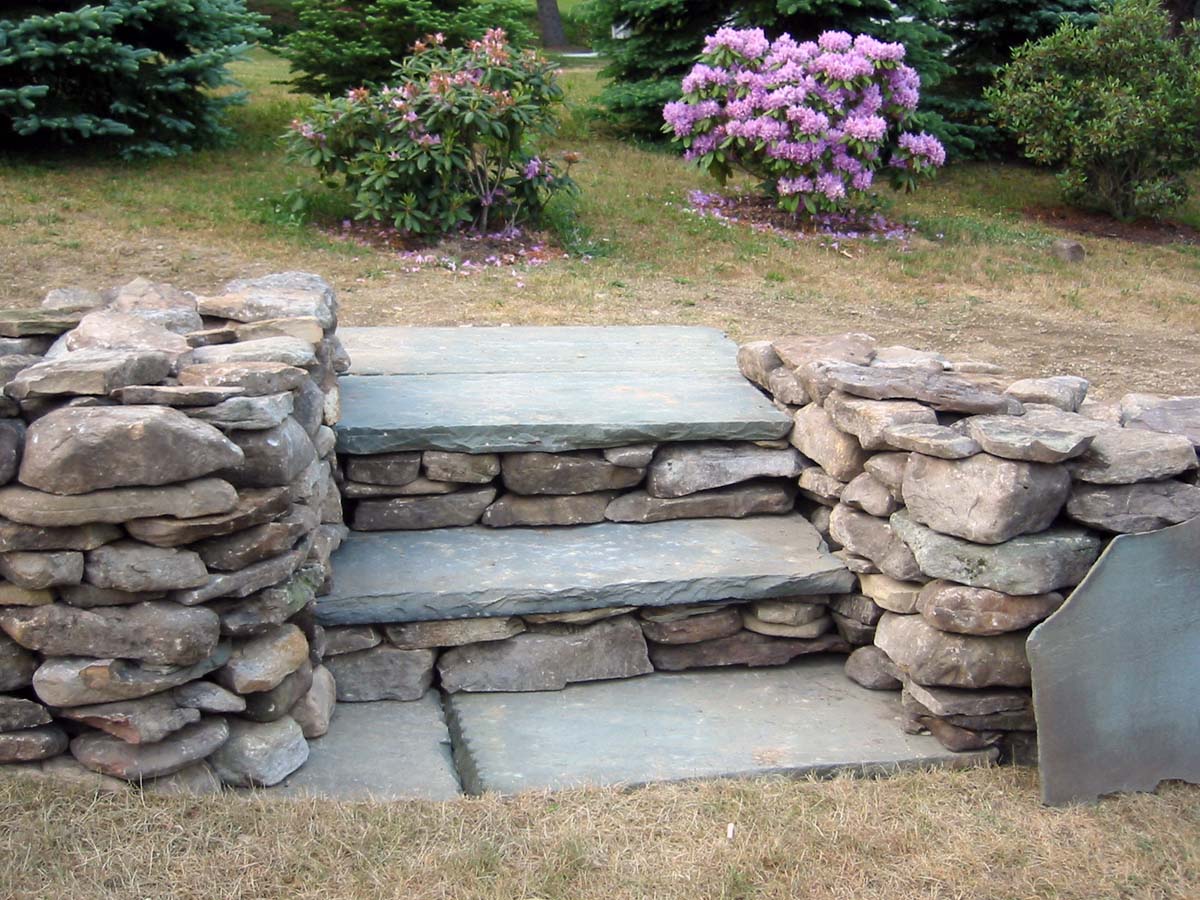

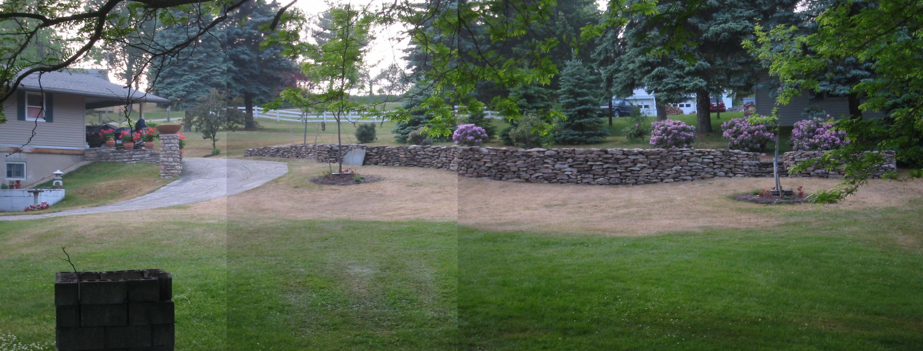

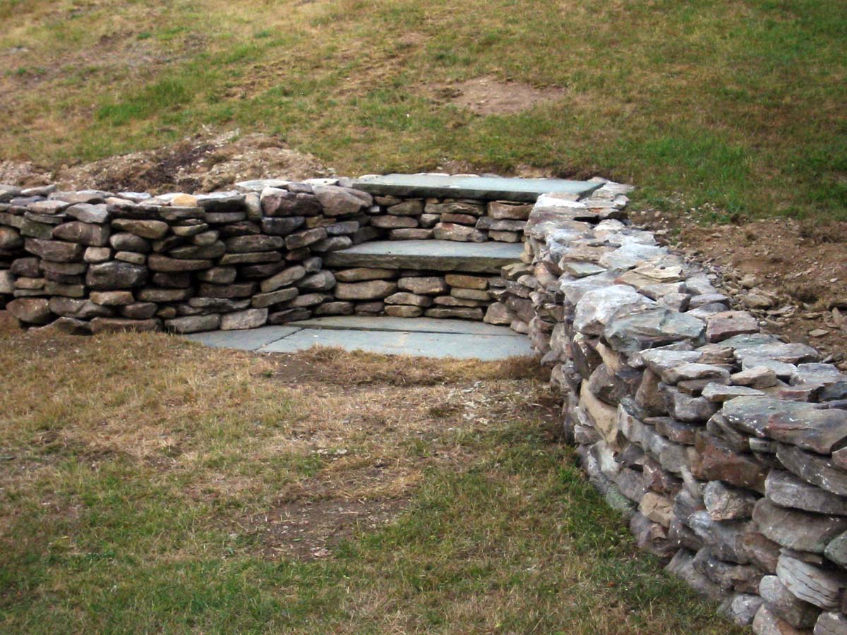

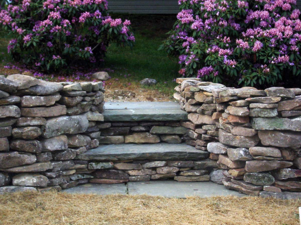

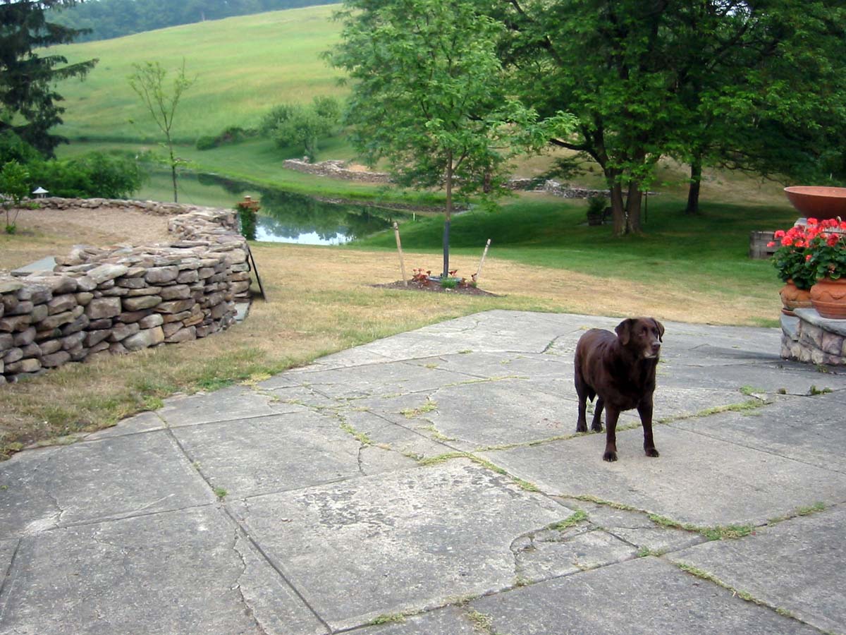

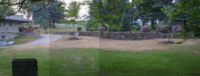

Thanks guys, it was a good find and I often do not have much luck with finding much help. We would like to put a gazebo type structure over the seat and grow some wysteria. Along with some type of japanese garden and trees. Both hills are full sun, well drained shale type. So we have had little luck growing much. You can see the grass is burned and its only early june. On the upper wall we plan on screening out the neighbor with some evergreen type shrubs and trees. I would like to have a couple of ordimental evergreens and perhaps some red twig dogwood to liven up the winter scene. Then we plan on placing a quit bench in the middle of the upper wall overlooking the yard. IIts hard to see how massive the walls are from tjose shots as theres nothing to really reference in the pics. Here are a couple more of the finer detailed work.

All around nice looking place you have. The wall is really pretty. You did indeed get a uniquely inexpensive wall.
Stone like that is about $US250 per nugget (round wire enclosure, not even the size of a pallet that I envision by your description). Labor? it's expensive here and very shoddy to say the least.

Project looks great!!! Fine looking work that was done there.
On another note, your pond looks great. How do you keep the algae under control. Having a heck of a time with the pond here in SW PA.

Oustanding work! In VA that stone would be about $400/pallet. Don't even ask for the labor... That's a nice place you have, you should be proud to show it off.

In these shots the pond is really a mess, I only had given it the sulfate, but recently used the aquashade and the results are very dramatic. 1 gallon of aquashade runs about 38-44.00. 1/4 gallon will suffice at first for a pond my size.

What a nice quiet looking place you have. Beautiful wall!!! It's all loose fit right? No mortar? How about a footing? Gravel?
Just asking because I have a ton of shale on my property and was thinking of starting a project alike yours.

Yes, it is loose, no base prep besides cutting the sod and a wide trench with the back hoe. The ground is well compacted and has a high drainage. The previous owner used to work for the DOT, so he filled in allot of the yard`with the road gravel and ditch scrapings. Also by the pond the hill has a shale content about 6" down at most, I think there may be a shale ledge there somewhere, fortuately I did not get into it on this job. Backfill was 2B stone tapered in to the hill, to a height of within 4-6" of the top (16 tons total, 8 trips with trailer). This also filled in some of the stone gaps in the walls tightening it up some.

Very impressive. One of my favorite things is a dry stacked wall that follows the contour of the land, and yous does just that!!! When done right, it looks like part of the landscape and becomes a thing of beauty. Your wall is all that and then some!!!!!!

Well, that's a fine looking section of wall. There seem to be a lot of places where two stones come together right over the joint below and even over two joints below. Not perfect, but for a lot of walls it doesn't really matter. A dry-laid wall is a beautiful thing to see, and the price you paid is amazing.
