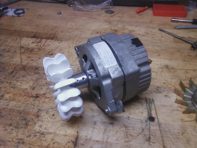

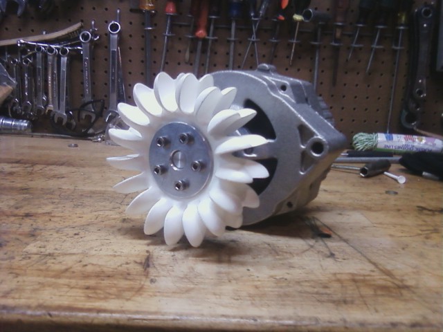

Pelton wheel project to generate power from a stream. The elevation from the small rock dam to the camp is about 60 vertical feet. Should be enough to spin this baby pretty fast, hope to make enough power to run 6 60 watt light bulbs. I am planing to have 2 water jets at 90' apart. More photos to follow as I progress along.

Have you done you homework to see the that Pelton is big enough diameter wise. Sometimes it is better to have an alt that is wound for low speeds.
   / Pelton wheel project #3
Are you going to be make 120VAC?
What is the volume of the stream?
Is the stream on private or public land because there can be enviromental issues, ie you might upset the mosquito pond down stream.

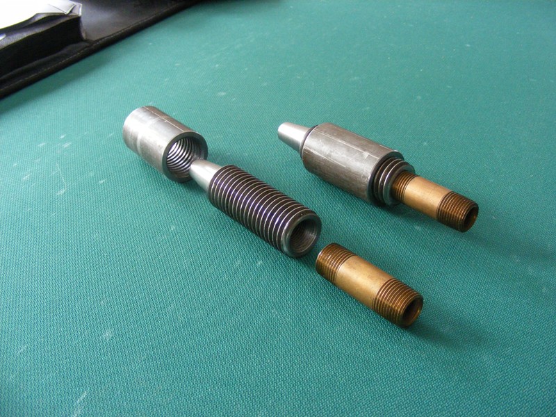

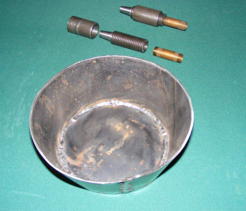

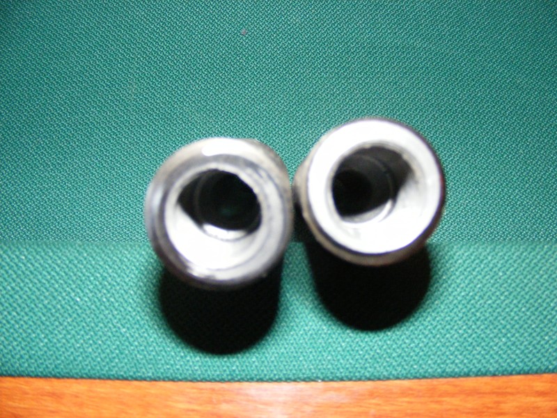

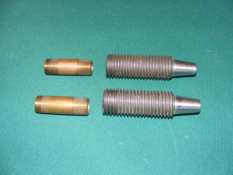

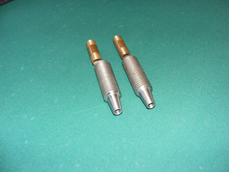

I had the time to make the nozzles today they are threaded to take the 3/8 NPT. The photos were hard to take to show the inside but the ID is tapered at 7 degrees down to .345 at the outlet. I used 1" treaded rod. I plan to have 2 nozzles directed as close to the wheel as I can without touching it. I will post more photos as I progress. I wish I was retired so I would have more time to play with this stuff. You know how it is? enjoy

Took the time to make the bushings that I will weld into the shield of the project. I have one photo assembled and one not so you can see the parts in detail. Will post more when I get the shield completed.

I'm lost here. What is the amp rating of that alternator? In order to get the max amps you will have to spin it at about 5-5500 rpm. With only thirty odd psi behind those nozzles I fear that you'll get not much from that rig.

Question: does any one know if an alternator needs to turn clockwise or counter clockwise or does it not matter?
thanks in advance
   / Pelton wheel project #16
i built a water wheel for my camp.Alternator would not work.If the batteries went down below 9.9 volts the alternator wouldn't generate power.Alternator needs power to generate power.easier to use a 12 volt or 24 volt motors.you can buy off ebay really cheap.Also an alternator needs lots of rpm's .DC motors generate power as soon as they are started up

Fascinating project! Thanks for taking the time to take the pictures for us to follow along. I hope that we get a follow-up as it gets installed. It sure sounds to me like someone has done a bit of figuring out on the numbers. Seening things as definite as a 7 degree taper and and 11/32" nozzle orifice in a replaceable nozzle tends to make my head swing around and ears go up.
