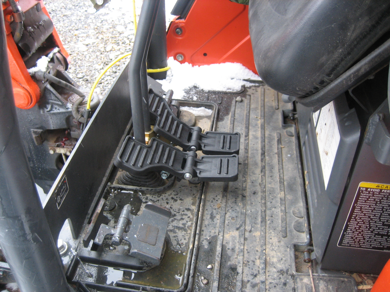

Mar 13, 2023 / Pedals for Kubota U25 Thread Starter #3 OP J Jw5875 Gold Member Joined Aug 27, 2005 Messages 414 Location NW Pa. Tractor Kubota L3400 Purchased a set from Coleman Equipment, Kubota part K7420. Listed for the KX018-4, U27-4. Fits my U25 perfectly!! Attachments IMG_6304.JPG 2 MB · Views: 276
