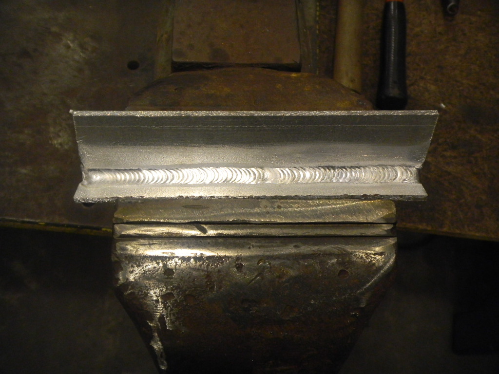

Tell me this kid isn't a natural! This is with about 2-hours of hood time:shocked::shocked:. His only problem, he forgets to back off the pedal at the end of the weld, (far left side). Color me impressed!:cool2::cool2:
Okay. I'm sold. Sign me up, let me know when classes start and where to send my money! :)
Terry
I had very little to do with it. I really believe the Miller Dynasty 300 makes it so easy to weld aluminum. I surely don't want to take anything away from this kid. First thing this morning we fired up the Mig welder. I had him run some .045" Metal Core, and some .035" Mig wire. He did excellent with both.:cool:

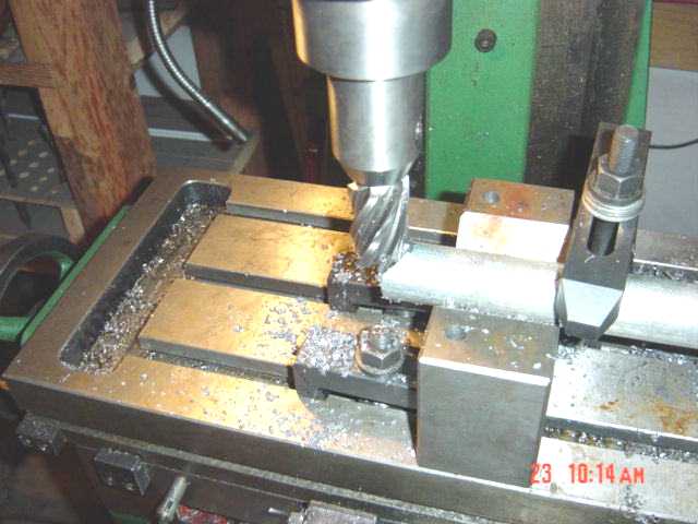

I showed him how to do it with a hole saw. He about fell over! :laughing:

Shield Arc, do you have a link to how you use a hole saw to cope tubing? I searched the forum and there are a lot of great ideas, from hand grinders to joint jigger and aven HF tools. Did you use a jig of some kind?

Hi Steve! Welcome to the site!
No I don't have any links. I just use the same size hole saw as the pipe / tube it will saddle. I generally only cope into the pipe / tube 1/3 the diameter of the pipe / tube.
