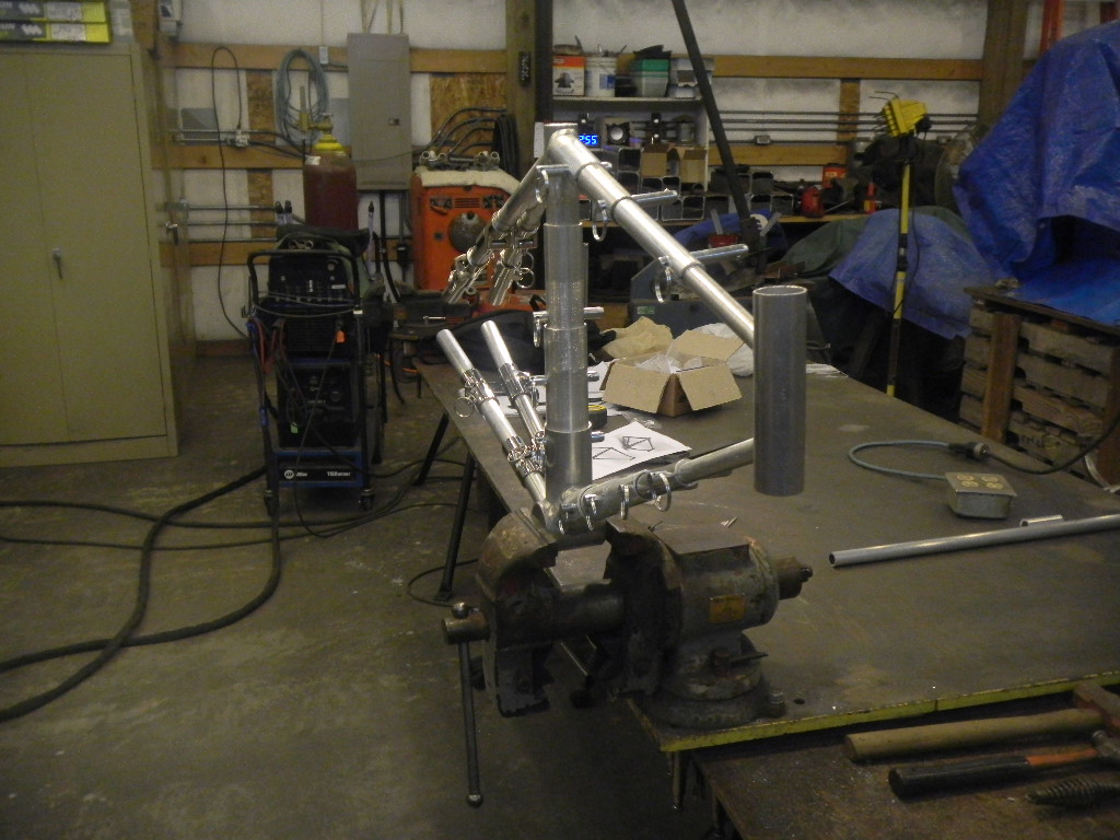

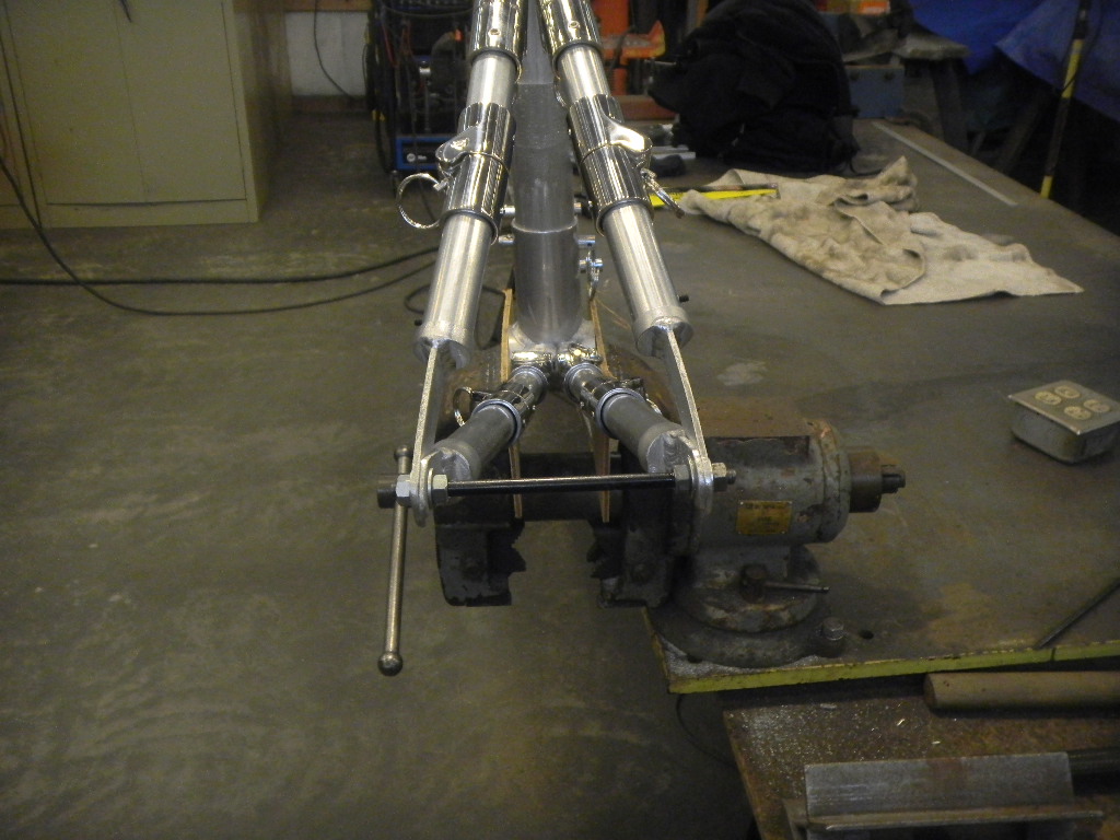

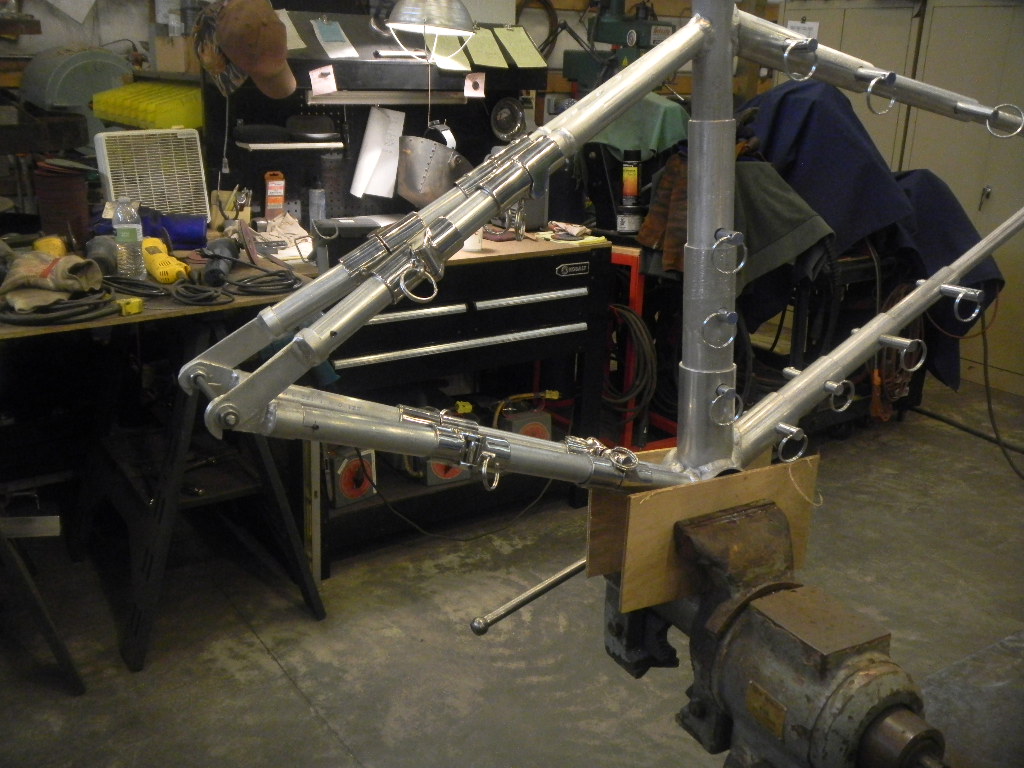

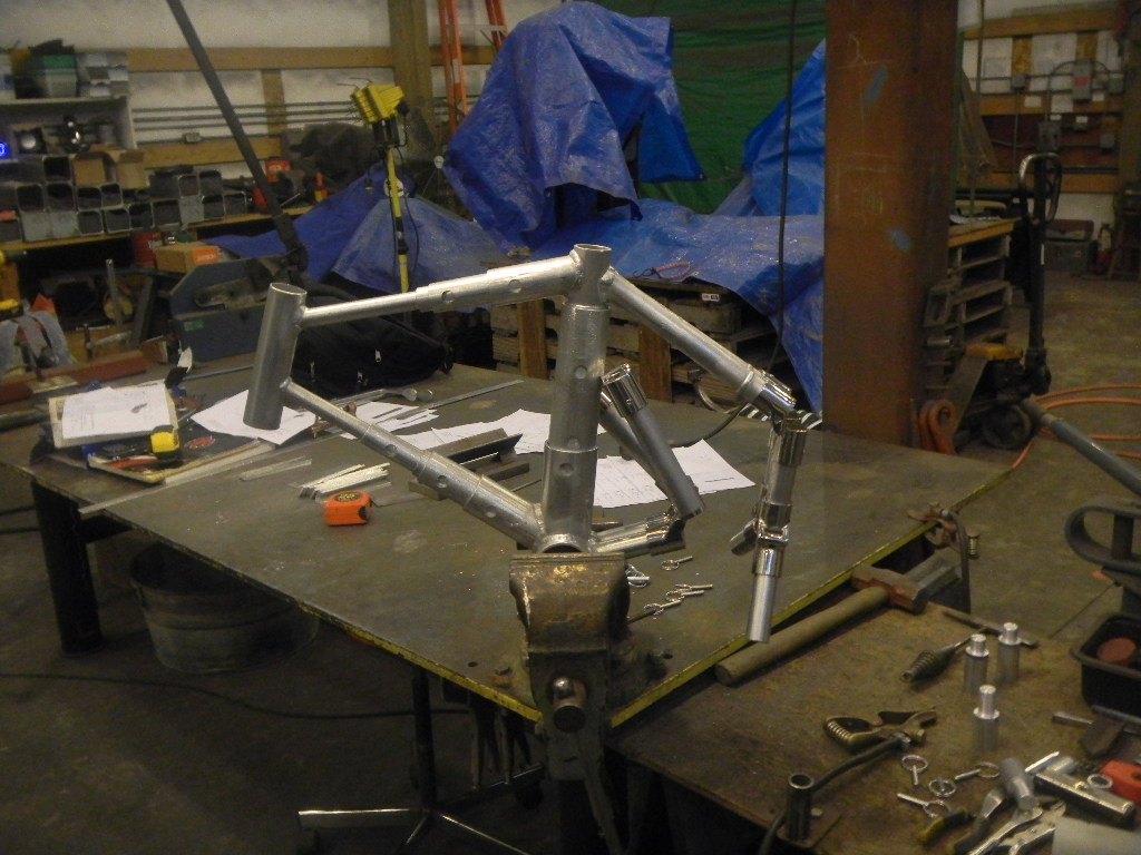

Personally I don't think it will telescope in with out pivot points. :eek:

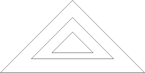

At first glance I thought the same thing. But once I was able to open the first two images side by side, it seems like it should work if all three tubes can be made to collapse simultaneously. The finish on the ID and OD better be pretty good to do that, because if the tolerances between the ID and OD are made large to let them slide against each other, there'll be so much slop the frame will lose rigidity.
I'd be more concerned with the direction of the front hinge in the chain stays. It will tend to open under load, so it better have a strong locking mechanism.

That is correct but there needs to be two pivot point at the front fork tube for this design to work. Top and bottom tubes will need to pivot.
As I see it, the angles for all three corners can stay the same as long as all three sides of the triangle can shorten in unison (which it looks like they can per http://www.tractorbynet.com/forums/files/welding/414321d1425159143-pay-forward-frame-2-jpg).
Here are 3 nested triangles, the outer one is has 3.5" sides for the top sides, the middle one has 2" sides and the inner one has 1" sides, the angles between the lines are the same on all three triangles:

Yeah, I want to get him behind the hood and welding before this is completed. I can tell this kid is a sponge:cool:, he is just amazed at how I'm building this frame. It's easy to see he has never got his hands dirty before. I think this is a real good experience for him.

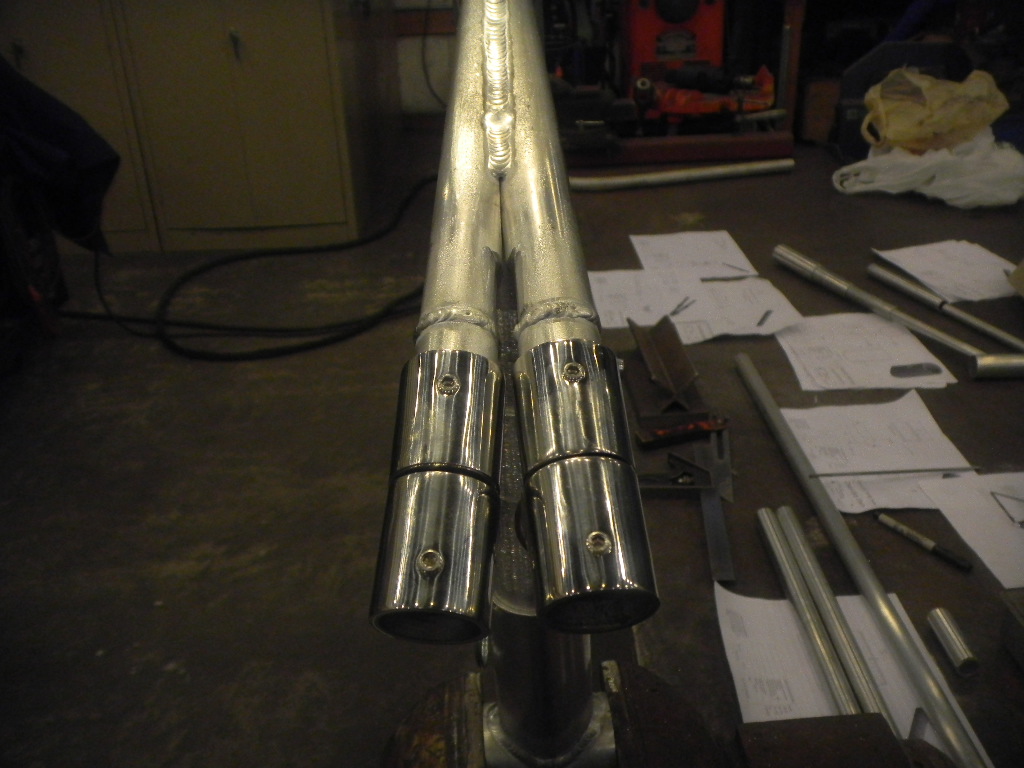

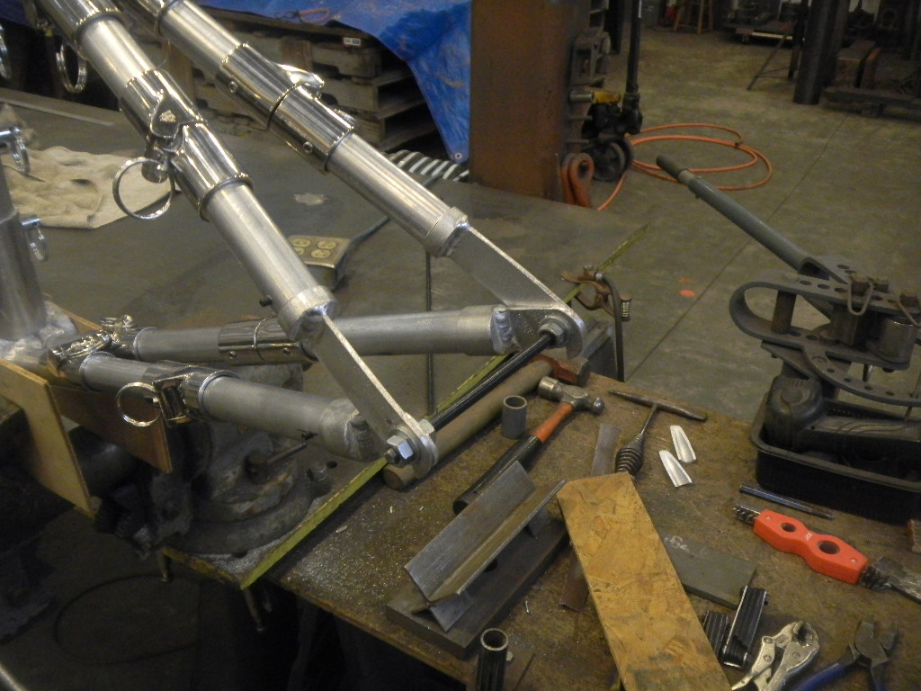

He has made some miscalculation, he didn't allow enough room for the wall thickness of these couplings. I tried to shave the wall thickness out of the aluminum pipe. But got afraid I was going to cut through. So we had to add more pipe, so the couplings would clear each other.
And you're just hating doing it aren't you.:D:laughing:
Arc weld I love the look on his face, like Christmas morning! :laughing:

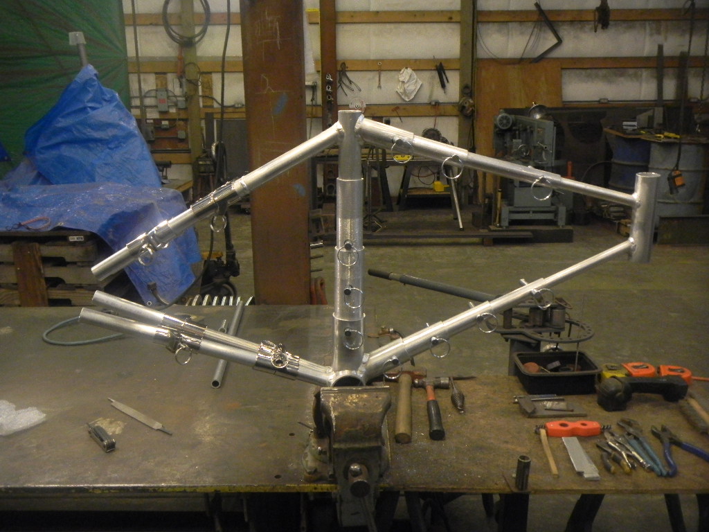

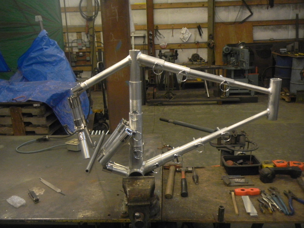

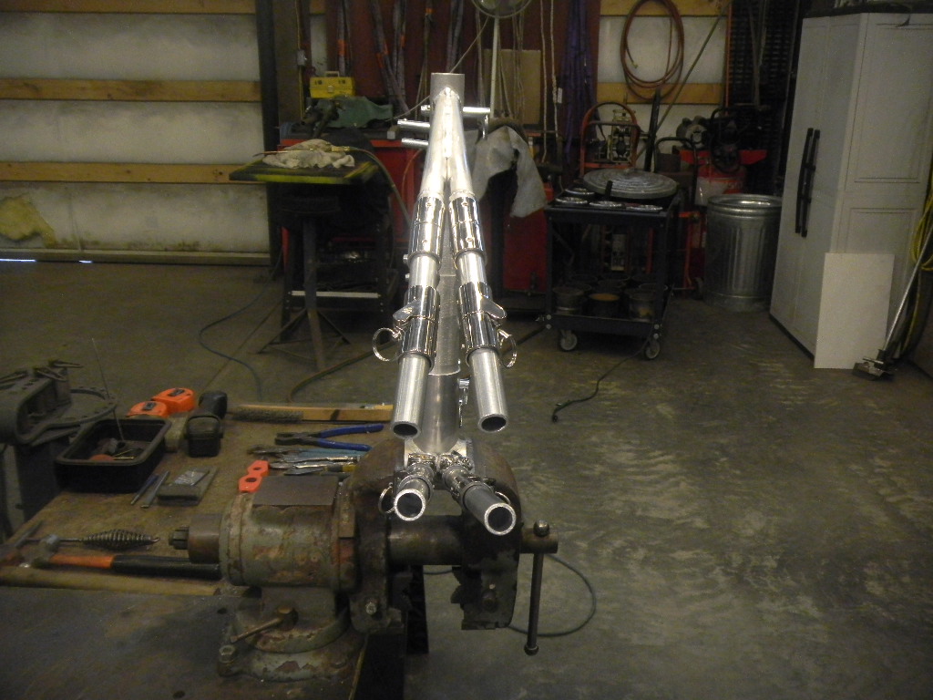

Welp, I was wrong!:eek: It does collapse. He had to get back over the mountains for class tomorrow morning. So we'll finish it off next week end. I sent him home with some 100, and 320-grit emery cloth to clean the pipe up better. Along with a round, and flat mill file to take care of any burrs.
Did get him to play with the Dynasty a little bit. Pretty quick learner.
