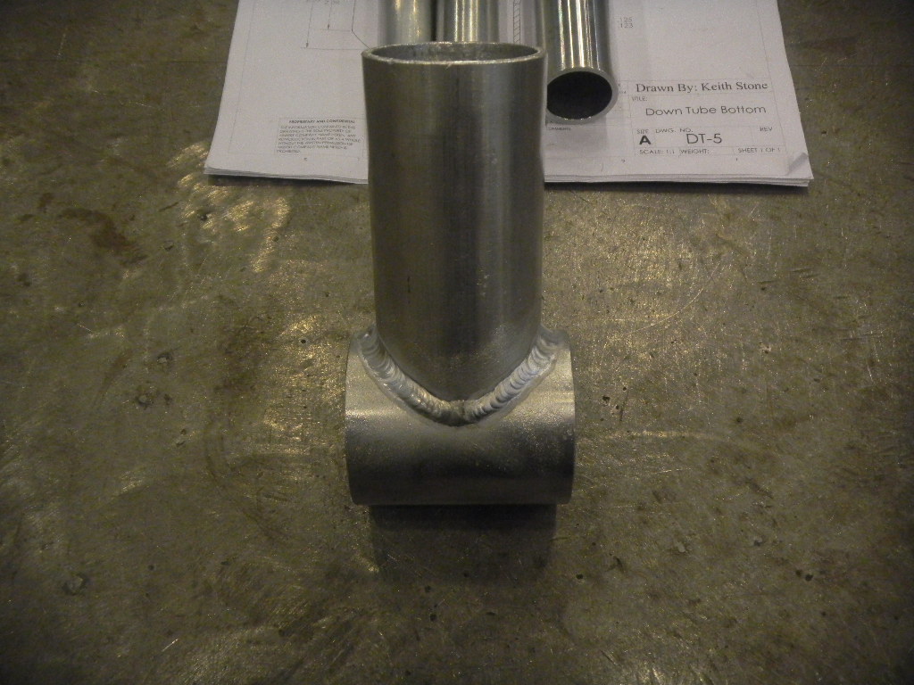

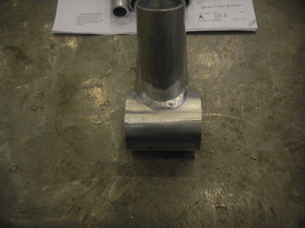

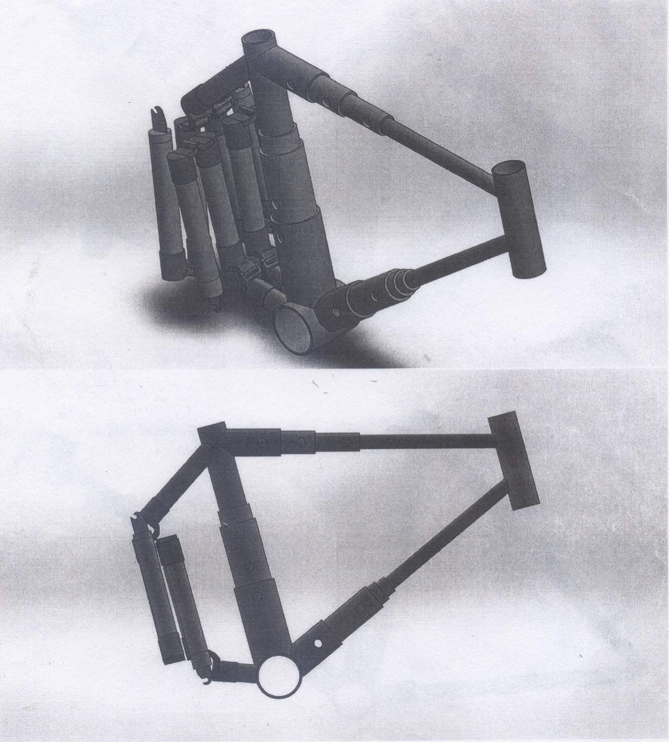

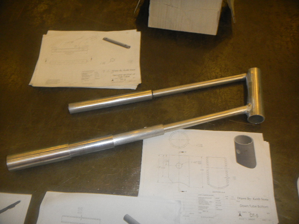

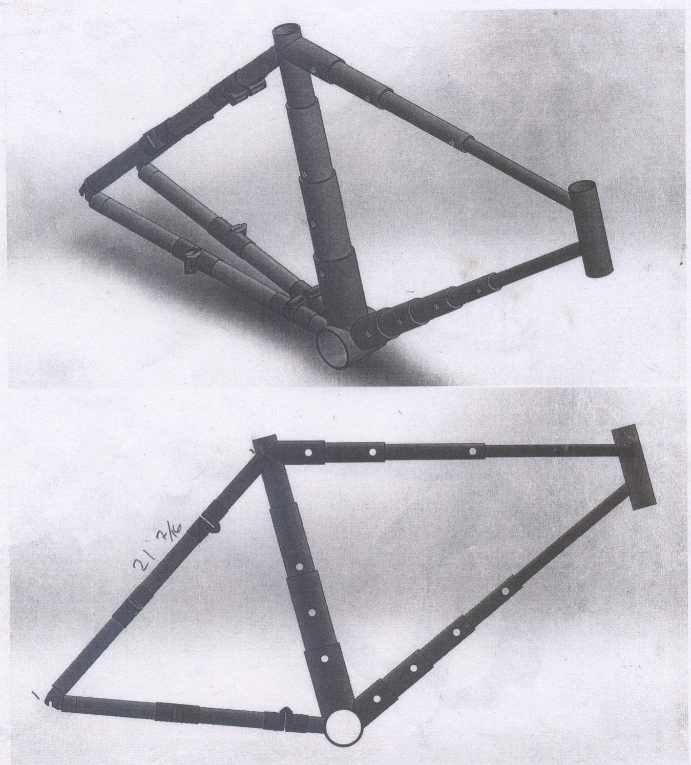

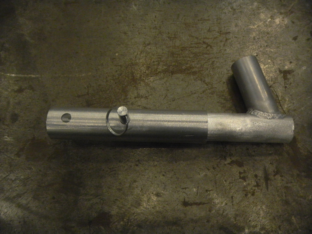

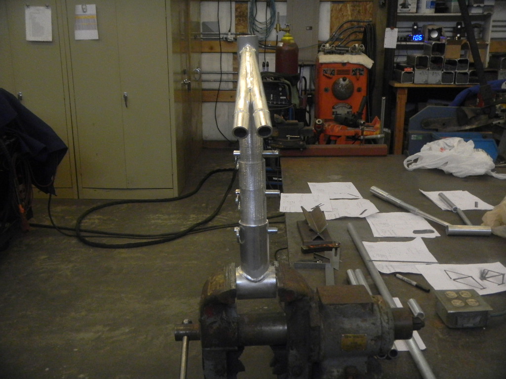

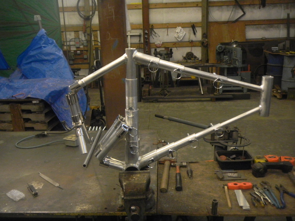

A friend of my wife ask me if I would help her son-n-law with a project. He is in his senior year to be a mechanical engineer. This is his senior year project. Make a collapsible bicycle frame out of aluminum pipe. This is all we got done so far. Personally I don't think it will telescope in with out pivot points. But who am I? I can't even spell engineer. :eek:

I agree. The front top bar and bottom angle bar have no place to go unless disassembled. I hope that is aircraft grade tubing. There are eight load points on that frame not counting the telescoping sections.
Good luck.
Nice welding by the way. That part looks good.
/ Pay it forward. #3

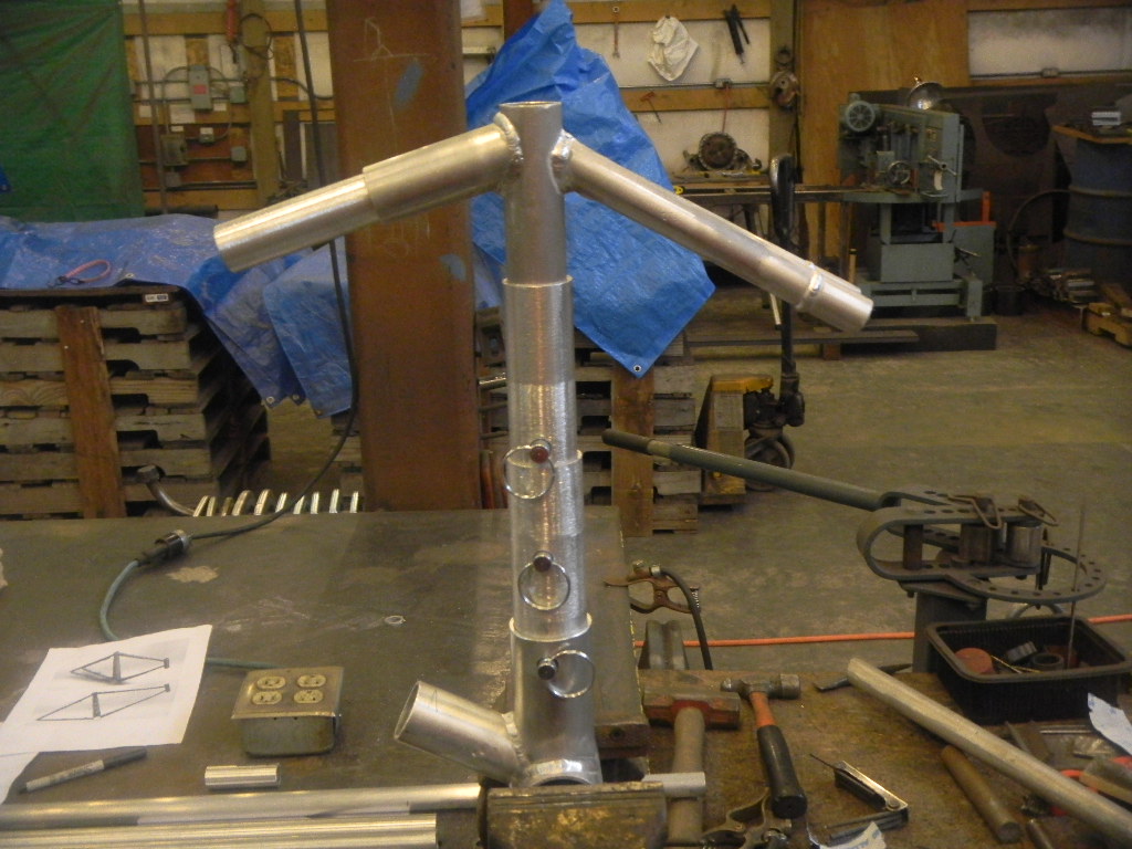

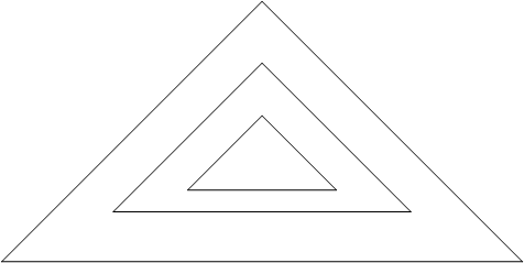

A triangle with rigid angles will telescope using 3 sides at the same time. Just 2 sides telescoping won't work. The 3rd side has to get shorter, too.

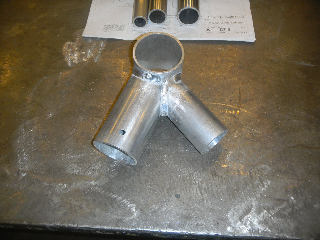

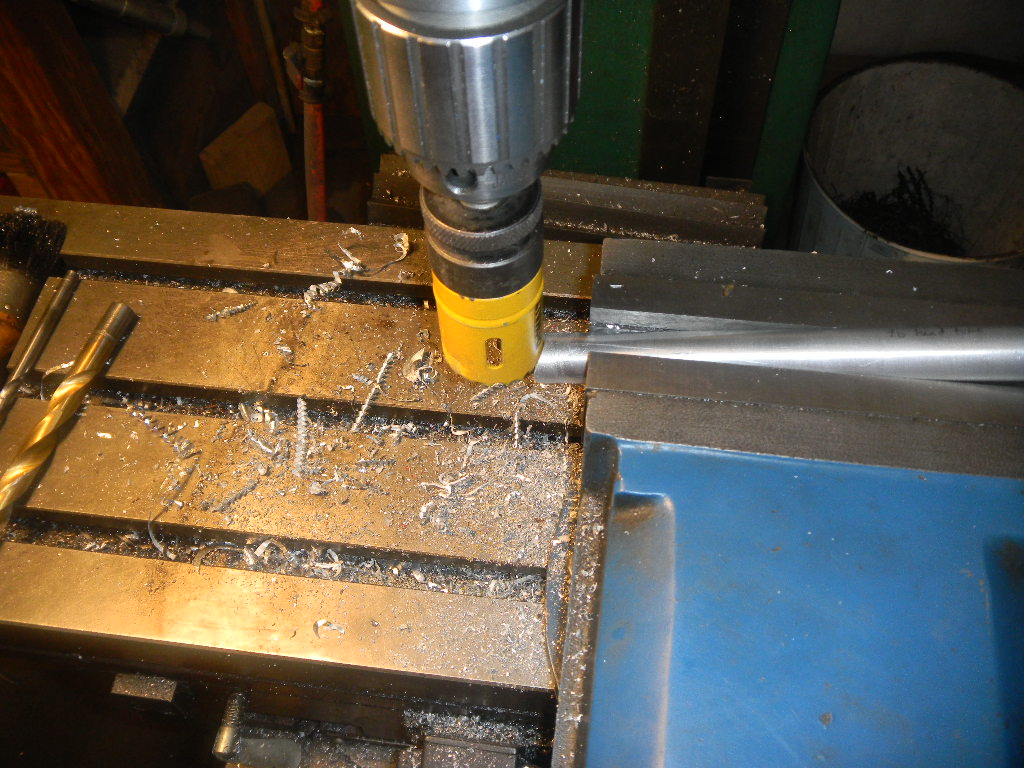

He has made a few miscalculation so far:eek:. He said the first cope he made by hand took him 45-minutes. I showed him how to do it with a hole saw. He about fell over! :laughing:

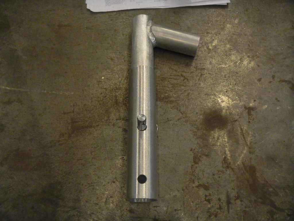

Looks like that is being done for the front triangle, the seatpost and the other two bars all telescope...
Aaron Z
/ Pay it forward. #8
Aaron Z
That is correct but there needs to be two pivot point at the front fork tube for this design to work. Top and bottom tubes will need to pivot.
That's the way I see it too. But I'm just a rigger, sometimes weldor.:eek:

Personally I don't think it will telescope in with out pivot points. :eek:
At first glance I thought the same thing. But once I was able to open the first two images side by side, it seems like it should work if all three tubes can be made to collapse simultaneously. The finish on the ID and OD better be pretty good to do that, because if the tolerances between the ID and OD are made large to let them slide against each other, there'll be so much slop the frame will lose rigidity.
I'd be more concerned with the direction of the front hinge in the chain stays. It will tend to open under load, so it better have a strong locking mechanism.
As I see it, the angles for all three corners can stay the same as long as all three sides of the triangle can shorten in unison (which it looks like they can per http://www.tractorbynet.com/forums/files/welding/414321d1425159143-pay-forward-frame-2-jpg).
Here are 3 nested triangles, the outer one is has 3.5" sides for the top sides, the middle one has 2" sides and the inner one has 1" sides, the angles between the lines are the same on all three triangles:

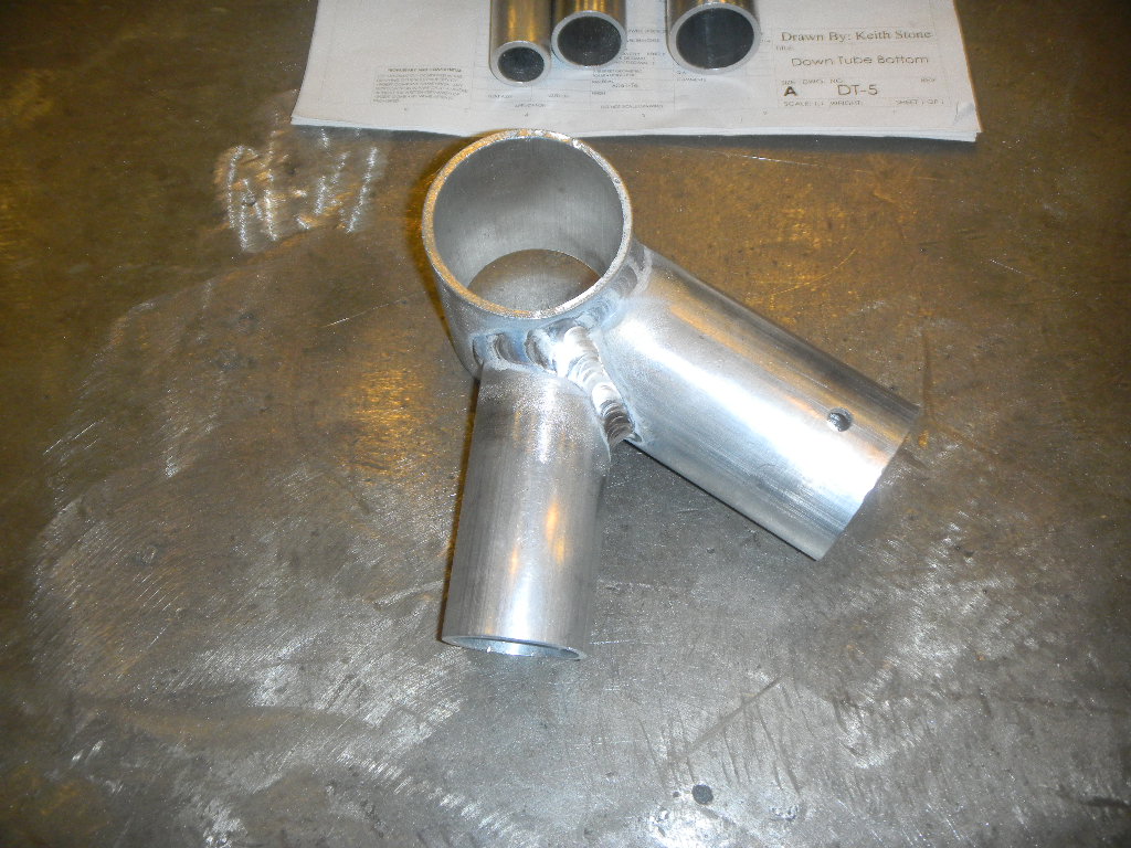

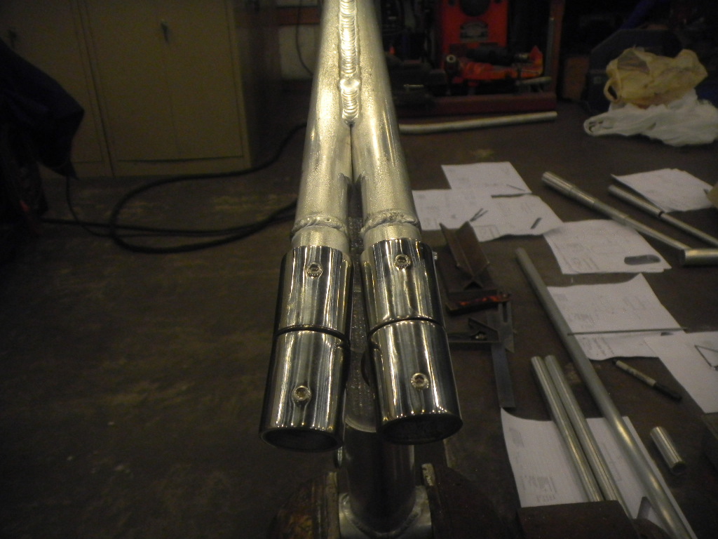

He has made some miscalculation, he didn't allow enough room for the wall thickness of these couplings. I tried to shave the wall thickness out of the aluminum pipe. But got afraid I was going to cut through. So we had to add more pipe, so the couplings would clear each other.

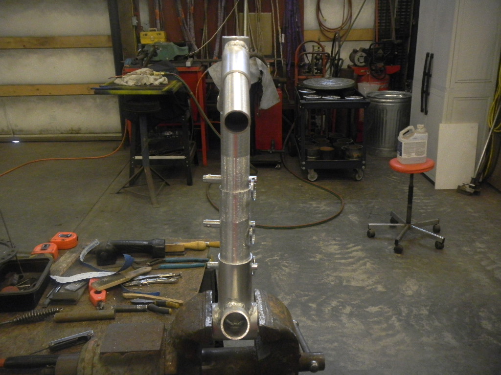

Welp, I was wrong!:eek: It does collapse. He had to get back over the mountains for class tomorrow morning. So we'll finish it off next week end. I sent him home with some 100, and 320-grit emery cloth to clean the pipe up better. Along with a round, and flat mill file to take care of any burrs.
Did get him to play with the Dynasty a little bit. Pretty quick learner.
