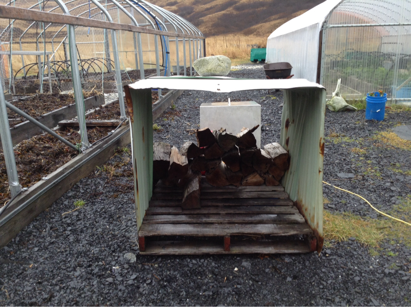

I salvaged a bunch of tin from a residing job at an old cannery around the corner. I bend 2 sheets around a tote and attach them to a pallet( as I come across freebie plastic pallets I am switching them over) it holds about half a chord, split wood goes right into the mini shed, I store them with the openings facing east/west, my prevailing winds. It dries just fine in our soggy climate. As i need the wood I just park the pallet right next to the door, so it really cuts down on handling.

Interesting, so you're using a sheet of tin with the ribs running vertical up the sides and across the top?

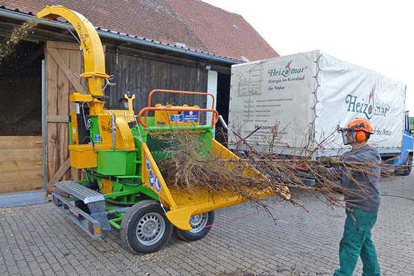

haul logs to a chipper, chip into hopper(with blower for drying), auger from hopper to woodchip boiler. Europe has this figured out:HM6300.gif

Yup, I set a fish tote on top the pallet and bend the two sheets of tin over it, take the fish tote out and screw them into the pallet.
Unless the wind catches an empty one and sends it flying, they hold up great til the pallet rots, hence switching to plastic pallets. I can usually get one or two of those a year beachcombing:)
If I was using them where someone was concerned with ascetics, a little 2x4 frame, add a peaked roof, and new tin and you'll have something pleasing to the eye.

how do you figure that?
downunder they do this too.
My intention was a joke here but lets take it further if you're being serious about this being a viable wood burning method for the average wood burner. You cut 5 or six cords of wood and then rent a log truck. In the picture is my average size wood I skid out. You bring them to a "chipper" and for the life of me we have no chipper stations per se. A chipper than can do an entire tree costs 250-300K and about a hundred fifty K for a used one, so I'm thinking they have to get a pretty penny for chipping your wood. So now you have all this chipped wood that you now have to bring back to your place and pay the truck freight and store it where after they dump it? Giving you the benefit of the doubt, lets say this tree chipper comes to you if such an availability exists so the cost of trucking it back and hauling it there is mitigated. I'm thinking at least a thousand bucks to rent such a beast if there is such a rental capability. Now you have to have a heat conveyance that burns chips. A place to blow in the stored chips. You have to have a hopper that automatically feeds the burner. You also have to have a generator to move the auger should the electricity go out. You're probably at 10k at this point.
This is getting way too complicated and the expense is enormous. $200 for a ton of wood pellets and a pellet stove cannot keep up with the radiant heat of a wood stove that didn't cost me 5 bucks in fuel to make a ton and a half of firewood.
If Europe has this "figured out", I can guarantee you that there are so many things different as to be almost impossible or at least infeasible to match by your average USA wood chuck.
