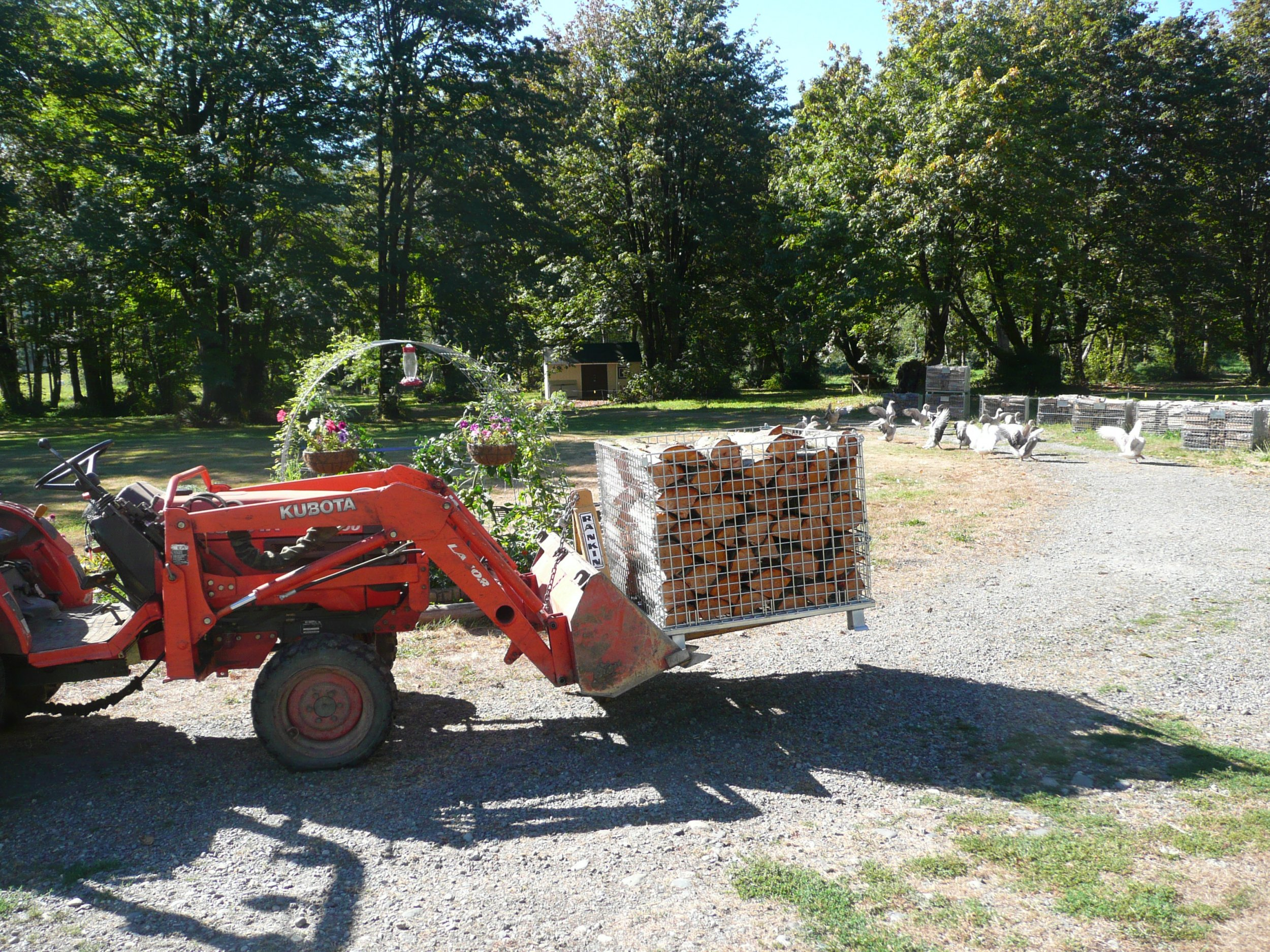

Sometimes I think so much outside the "box" that I completely forget that there IS a "box!" :LOL: Not recommended for the faint of heart, but in a pinch:
Note the stacked crates in the background. Yup, managed to lift and stack- ONCE (and only once)! When shopping for a new tractor guess what was on the top of my priority list!;)
Where do you find those metal pallets?! All our firewood goes in wood, sided pallet and they’re starting to deteriorate. The metal ones are awesome.
