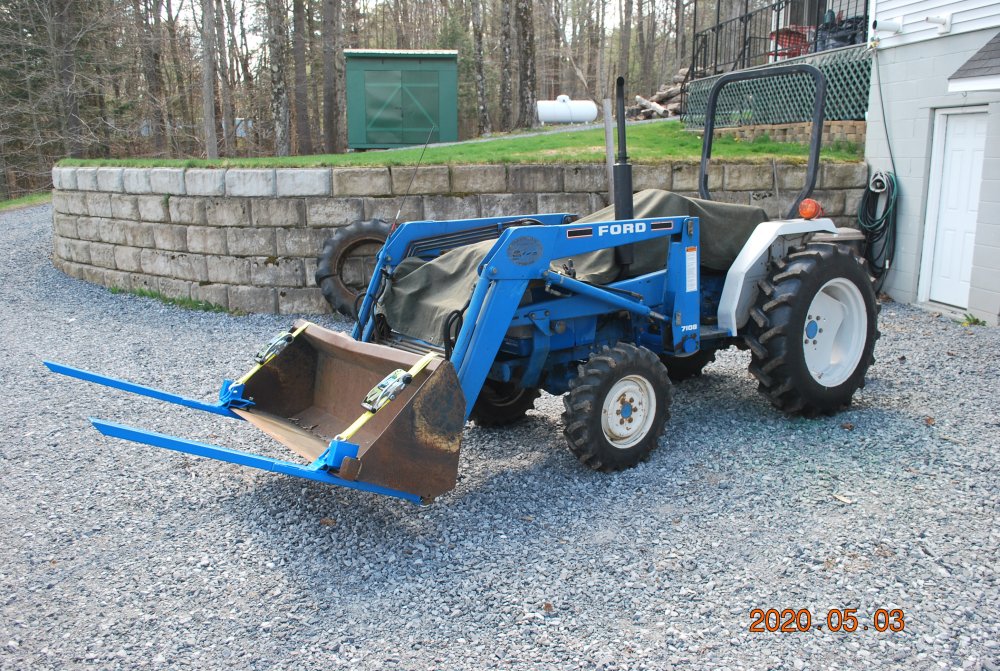

You have a picture of your forks or description?
Here are mine. :thumbsup:
/ Pallet Forks ... yet another home made set. #26
Wow someone else with tapered down forks, welcome to the Tapered Down Fork Club, so far it's a small club of you and me. Are these some you made or bought, does the square tube in between stop side to side movement?

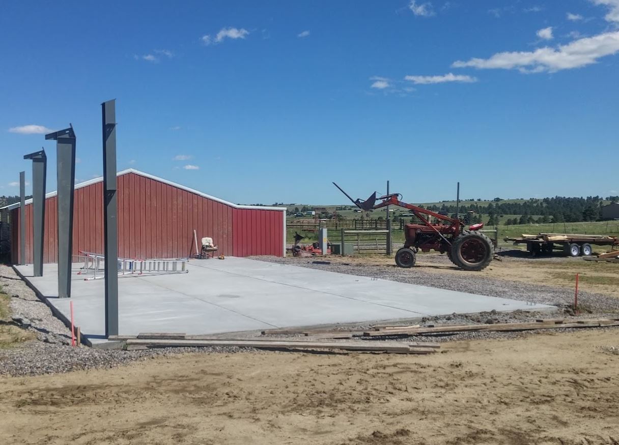

Looks like a nice 50s Farmall with add-on FEL post model and year so I can youtube it, then you stiffeners on the cutting, never seen that before must be you have lot of lift power, I could go on about the barn build and fantastic scenery but you heard it before.

I bought them from Here thought about building some for a long time and sure could of, didn't really have time so I forked up (ha) the money for those.
My Farmall is a 1944 M - she's been sulking some since I bought the diesel Agco that sits inside now, she's a tough old bird and has to stay outside. :)

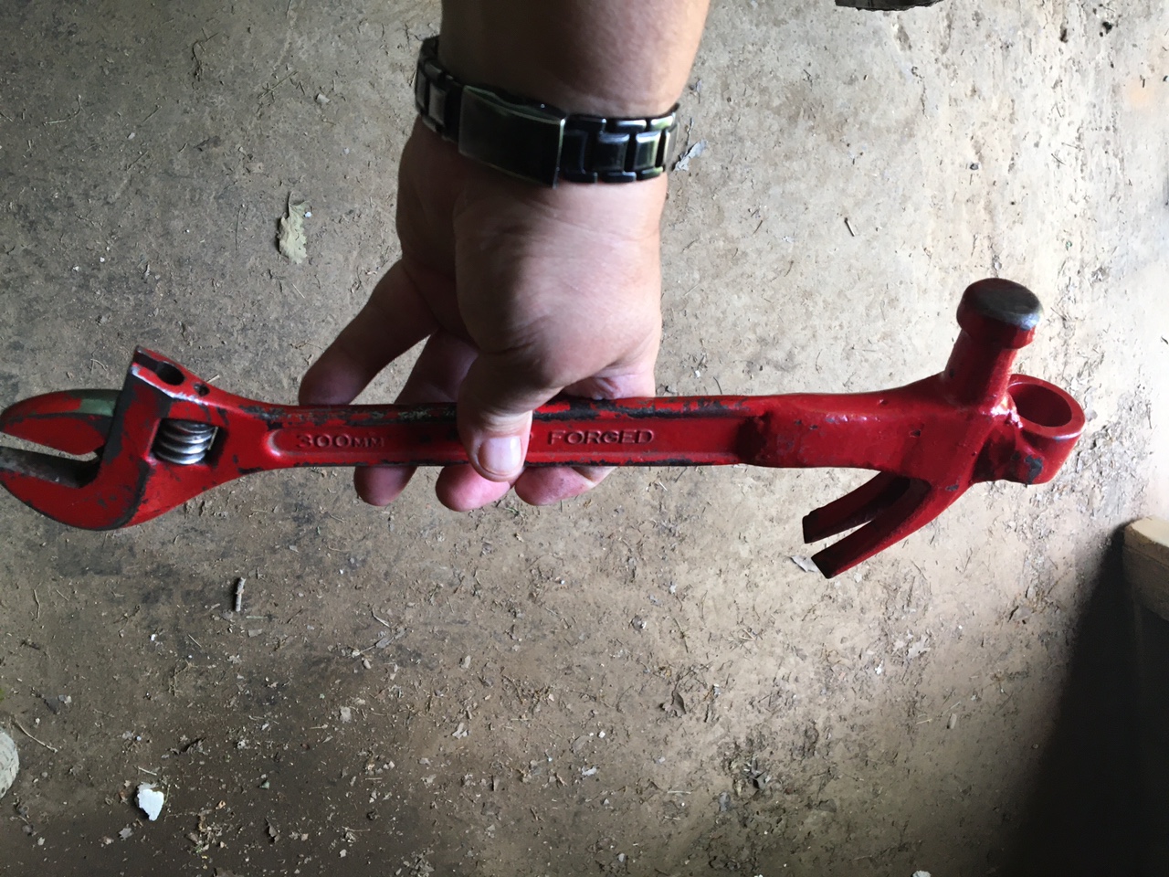

Tool I use to tighten the bucket pallet forks. The short thick wall tubing top of the hammer head fits the bar handle top of the clamping bolt. Rotates to always have a good angle on the tightening bolt. The extra leverage secures them better. Have the option to chain them down too but have never needed to.

Neat Swiss Army Farmer Tool. A tad big for the pocket, but one should have room somewhere on the tractor.
Love that thing Smokeydog. I have a small collection of multitools like that. They are always a bit compromised in function, but they can get the job done in a pinch. I carry a different one in each of my tractors, side-by-sides, etc; trying to figure out which works best and where. I would like to find or make the ultimate 3-point hitch tool.
