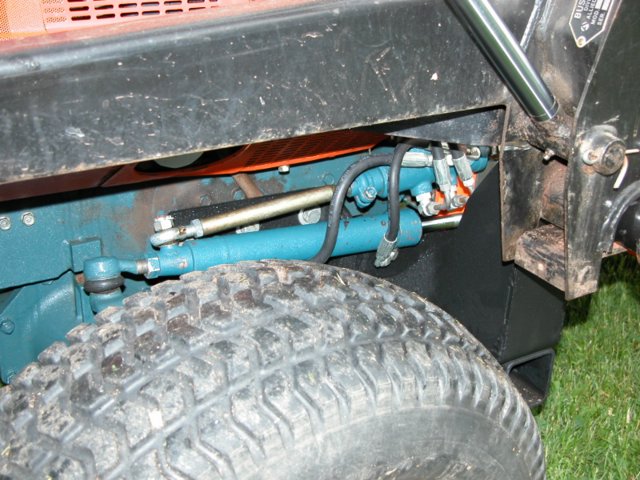

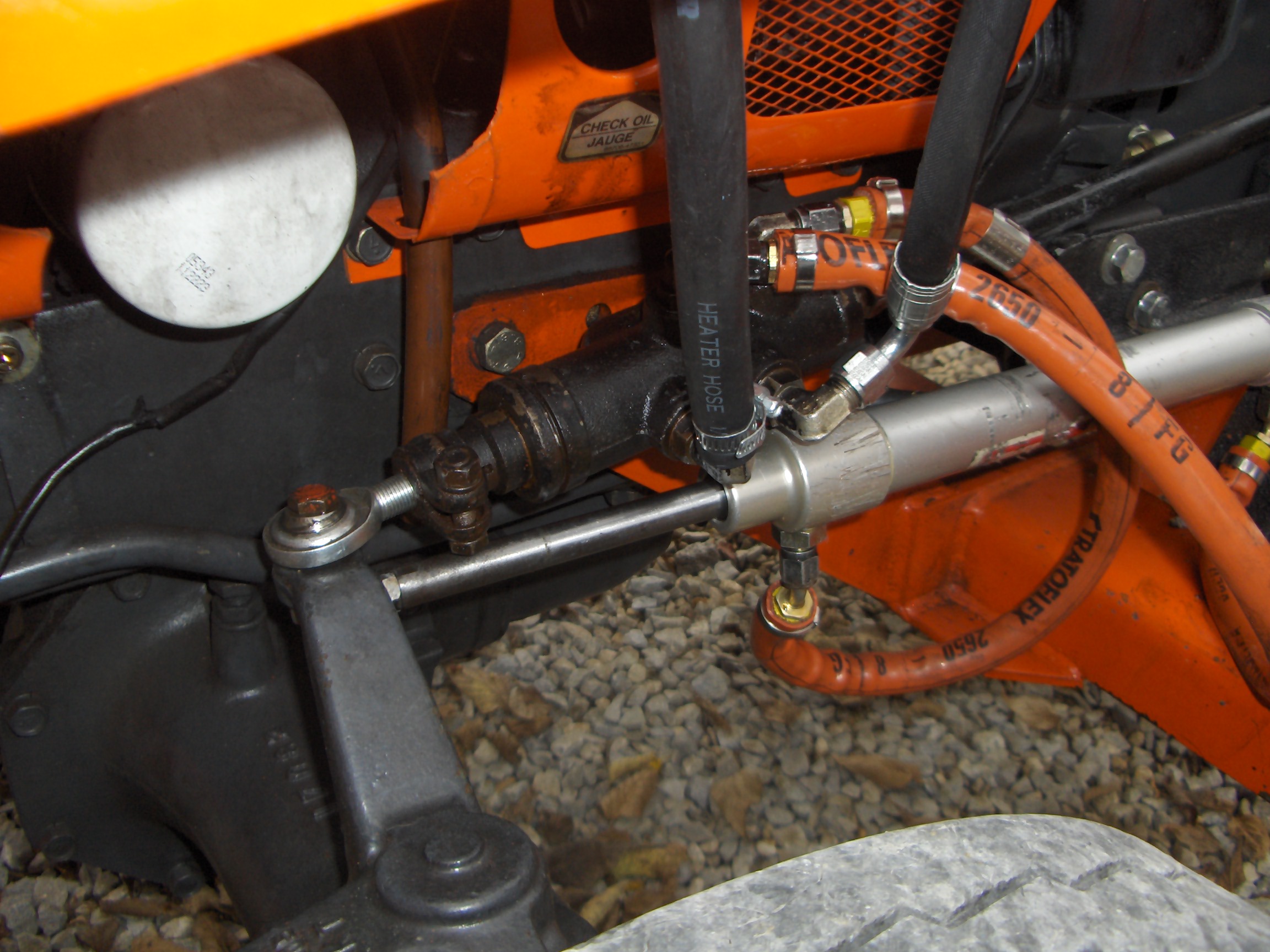

THE PUMP IS MOUNTED WHERE THE BELT TENSIONER WAS. A REMOTE FLUID RESOVOURE WAS MOUNTED ON THE FIREWALL. THE JD VALVE & DRAG LINK IS CONNECTED IN ORGINAL PLACE OF OLD DRAG LINK, WHICH ALLOWS FOR STEERING IN CASE OF FAILURE. A 1/4 INCH ANGLE WAS USED & BOLTED WHERE 3 HOLES WERE ALREADY THERE NEXT TO BELLHOUSING. CYLINDER WORKS INDEPENDTLY FROM THIS MOUNTING POINT TO FRONT STEERING KNUCKLE. BY THE WAY, P/S NEEDS ONE & HALF GPN FLOW CONTINUEOUSLY, WHETHER TURNING STEERING OR NOT, SO NOT TURNING WHEEL, WILL NOT INCREASE SPEED OF OTHER HRDRAULICS.

Thanks for the photos. Good looking system. I'm sure it works fine. Part of the difference between yours and mine is that my actuator valve and cylinder are one integral unit with no external hoses. I also chose to hook into the tractor's hydraulics which has worked fine for me, but I'm sure your axillary pump works well also. Like many things I have done over the years, I could do another one much easier. At the time I could not find a satisfactory flow divider, hence I used the hydraulic control unit off a B8200 that already had provisions to run my power steering. It also has outlets available to run any other hydraulic implements I might want to add in the future. I might tie into it sometime to run the cylinder that lifts my mower, but turning the valve under the seat to direct the flow from the 3 pt. to the mower has not been much of an inconvenience. Varmit's unit is a Kubota item, made for a B8200, but it is different from mine, which was also made for a B8200 and B7200. Apparently there was more than one available at one time or another.
