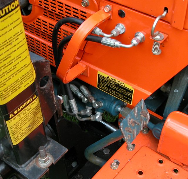

I know it's a bit far into this thread, but FWIW, here're some fotos of the official, made in USA Kubota aftermarket power steering kit I found and installed on my B8200 some years ago. Like everyone says, it's a wonderful mod., and if you can pull it off, well worth the trouble. Kits like mine are no longer available, but they were easy to install (I had to trim my loader's frame, and fab a strengthening bracket as a result, but that's because it wasn't a Kubota loader). As the poster said, long ago, it does sap hydraulic power at low engine speeds, but once you have some RPMs, everything works normally. If you could find to control valve, the rest of it would be doable.

Here are some pictures. This is my first try at this, so I hope it works. You can see I had to fabricate some attachment brackets, but hhis wan not difficult.
Thanks for posting the pics Elsie71. My only concern is the condition of you hoses, in some of your pics. Aren't they a little rough?
Fred
/ P/S B7100/7200 #147
I guess the hoses are a little rough. I had neve noticed. they have been on there somewhere around 20 years. ln any case they do not leak.
