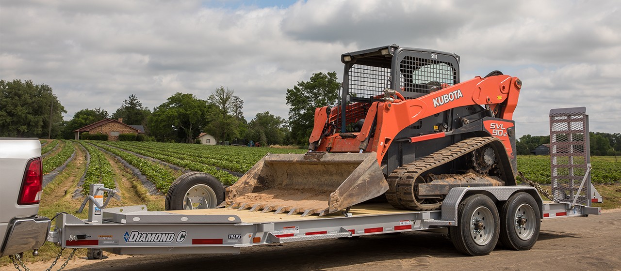

I am not sure who manufactures them but they are definitely over width and they make them with heavy 10,000lb axles and 17.5" tires as an option. People haul full size backhoes on them.
The law is the law but the reality is most law enforcement gets really suspicious when a load is protruding past the trailer. With a trailer like this, hauling equipment, everything will be way inside the fenders so I doubt they will even get suspicious.
This picture isn't one of the trailers in question but similar style. If you saw this going down the road would over width even cross your mind? I don't think just looking at a trailer anyone could eyeball it being a few inches too wide.
Worst case if you did get caught I think an annual overwidth permit is like $300.
I think the possible problem width the over width trailer would be the overall width compared to the tow vehicle. Looking from behind, one would realize it looks wider then most trailers against a normal pickup. Now a dually pulling it might have a better chance of not looking over width. Just a thought, Jon

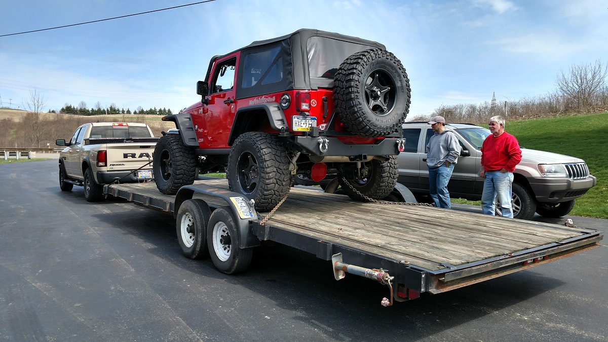

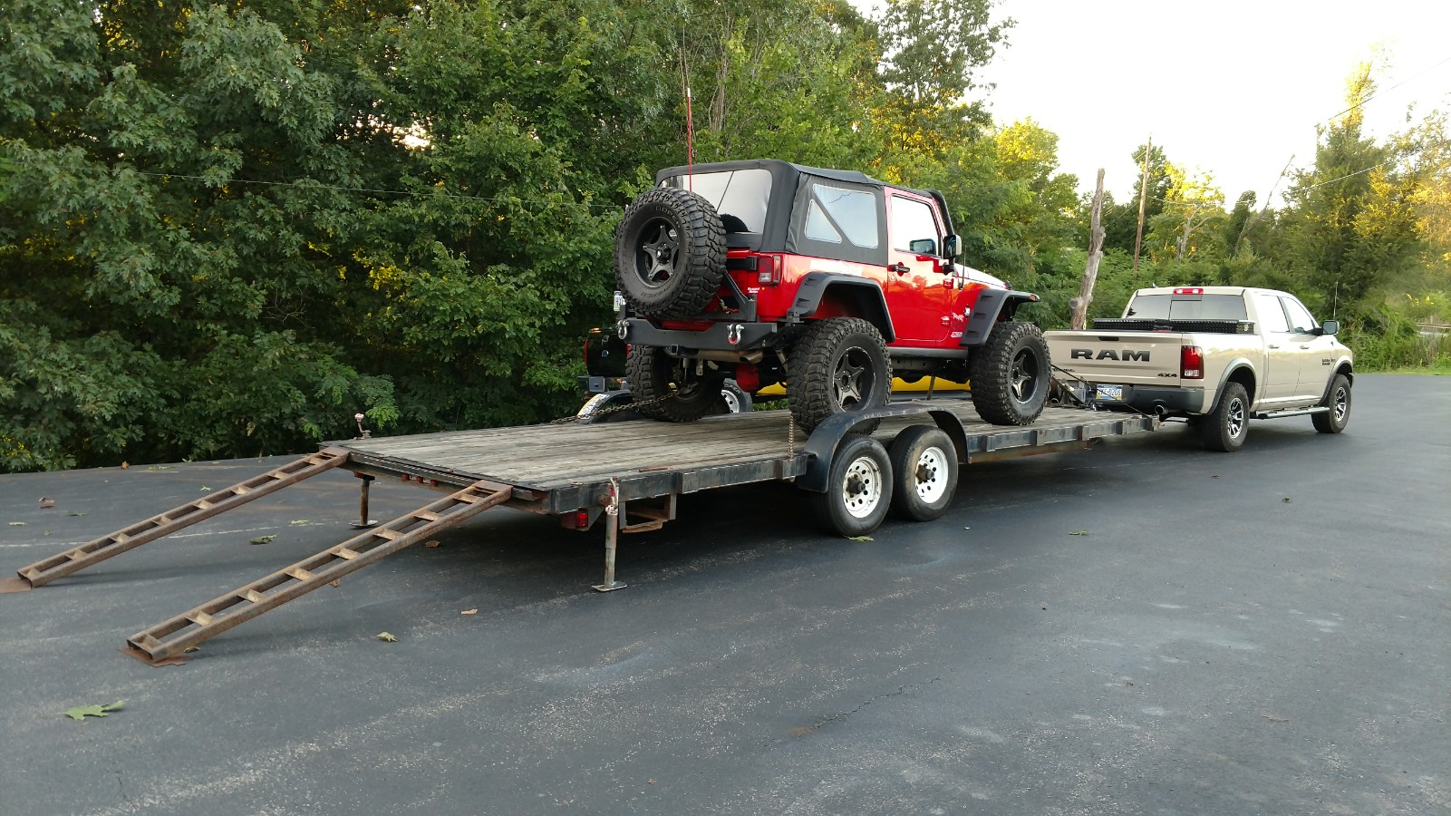

I have a 1999 flatbed equipment/car hauler trailer that is... lets just say a little wide. No, wider than that. NO, add more.
I've pulled my off-road truck and Jeep all over the country and even been pulled over for lights being out but no one has ever thought to pull out a tape measure to notice that I am 110" wide.... I do not know how this monster came to be, and I did not know it was illegal until a few years back I went to trade it in on a shorter trailer and the dealer measured it and refused to have anything to do with it.
Looking at it, you can see what was done. The base trailer frame is the max legal width of 102", then they ripped some 2x6 to 4" width and added angle sticking out to cradle it. Then the axles were cut in the center and opened up wider and a pipe/sleeve was used to cover the gap.
No one will get me axles made this wide. No one will take it in trade. And I'm a bit reluctant to sell it for fear that the next owner may not be as lucky as I have been. It's been a great trailer, but I no longer need to haul a full size truck with a 4'Tx4'Dx8'W shed built on the front of the trailer to house generator, compressor, tools and spare tires.

just don't. if the above post doesn't turn you off of buying a trailer over 102", the possible fine should.
there are a few manufactures that are building deck over's with a 30" deck height, and a 102" width.
I'm currently using a "car trailer" that is a 102" wide. I would like my next trailer to be a deck over that is 96.375" wide (3/16 rub rails) ;) why? cause 102" is a big fat trailer, and none of my stuff is wider then my 1/2 ton.
I think it would be a good idea to get that license tag off the fender, and mount it properly, on the rear of the trailer, with the required light for it as well.
You might get stopped for the tag location/no tag light, and then be questioned and measured for width.
