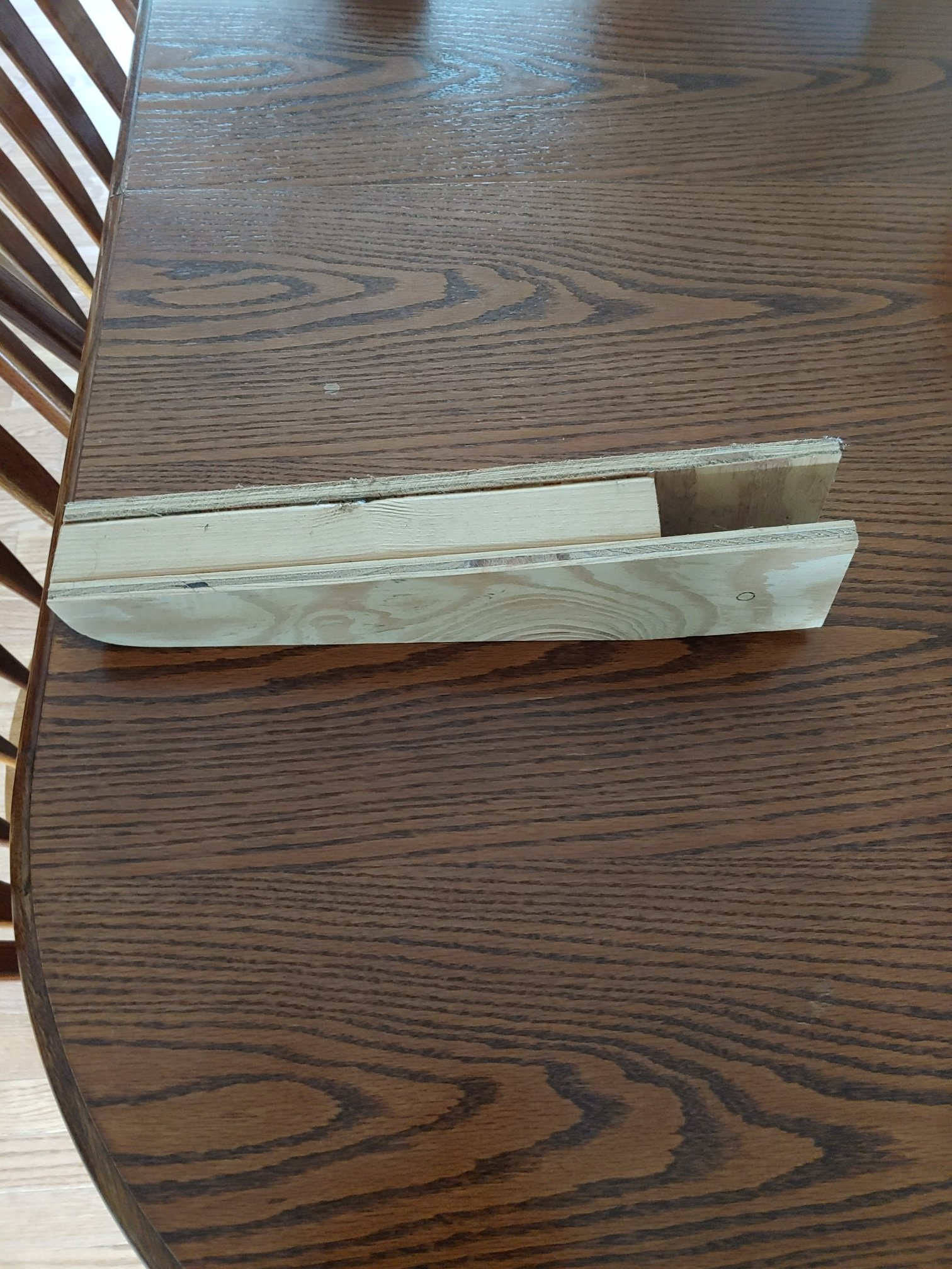

Bearsixty7 is correct about the size and weight of my grapple. For reference here is a "home made" support created by a friend of mine that uses a 2x4 and plywood as support. I used 4 modified (longer) supports than the one here that are bolted to the 2x4 studs of the shed. When pressed tightly onto the 2x4 framing studs and bolted they are quite sturdy. Certainly not a solution for a very heavy grapple though. These attachments are for a Kubota B2601 compact tractor.

I would want a diagonal brace going down to the sill plate just to make it stronger. There will come a time when engaging or disengaging the grapple to the tractor doesn't go as planned and extra weight is applied to the shelf. It is nice to stack items to make more room though.

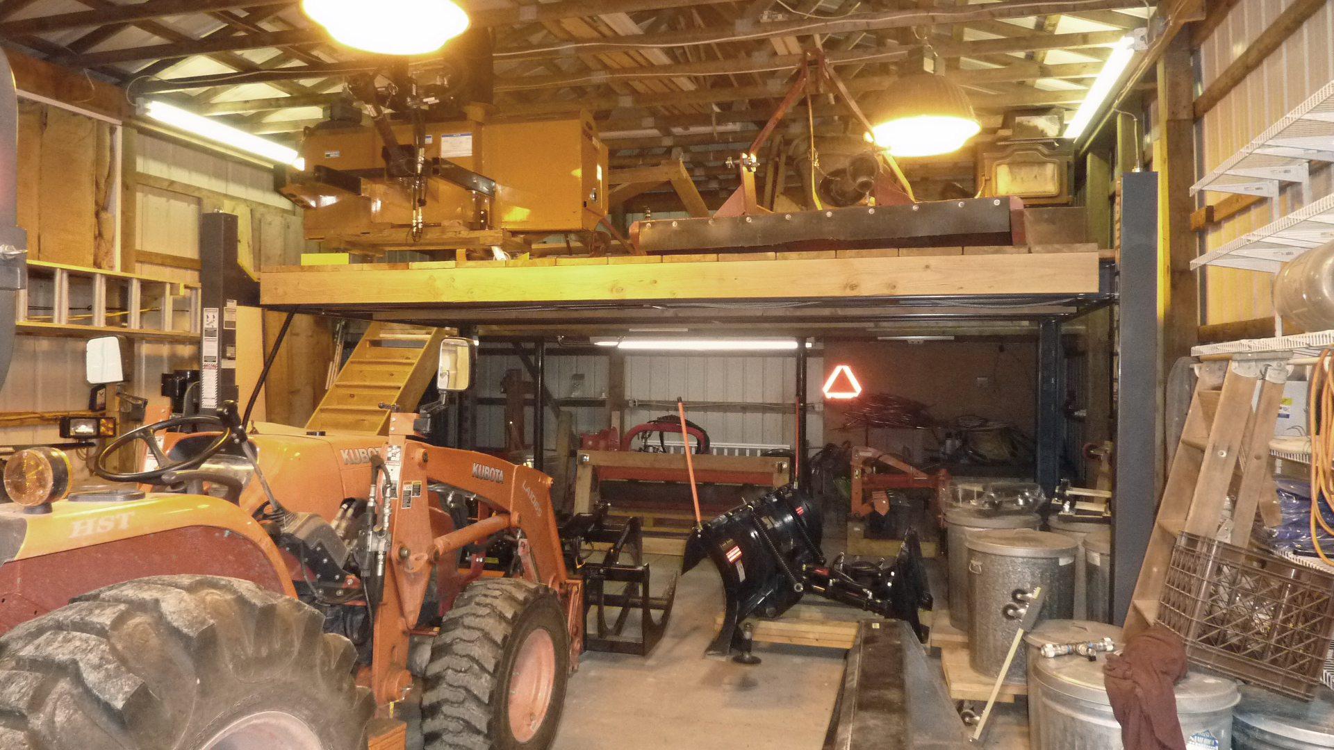

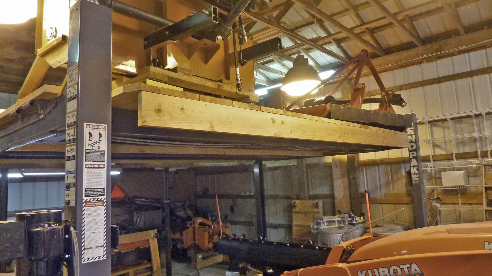

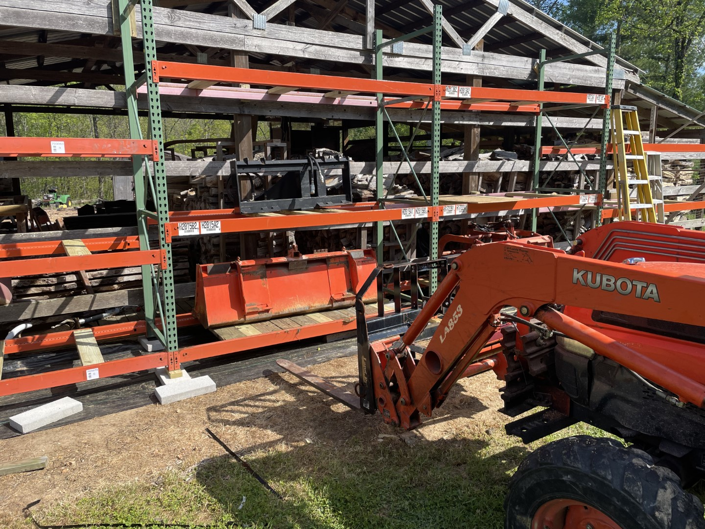

Nice project! Over / under storage is definitely the most efficient method.
This is probably overkill for most but if you have some $$ to throw at the problem, you could go the route I took. A couple of years back, I was faced with the necessity of putting up another pole barn for implement storage. I got some building prices and found I could buy one of these hydraulic service lifts for less than half the money. It made sense to take advantage of all the empty space from 5' to 12' off the floor.
I chose a 14,000# 14' X 10' model and installed a deck on top. I now store all my seasonal implements on it which freed up 40% more floor space in the existing building. It doubles as a grease rack to work on tractors.

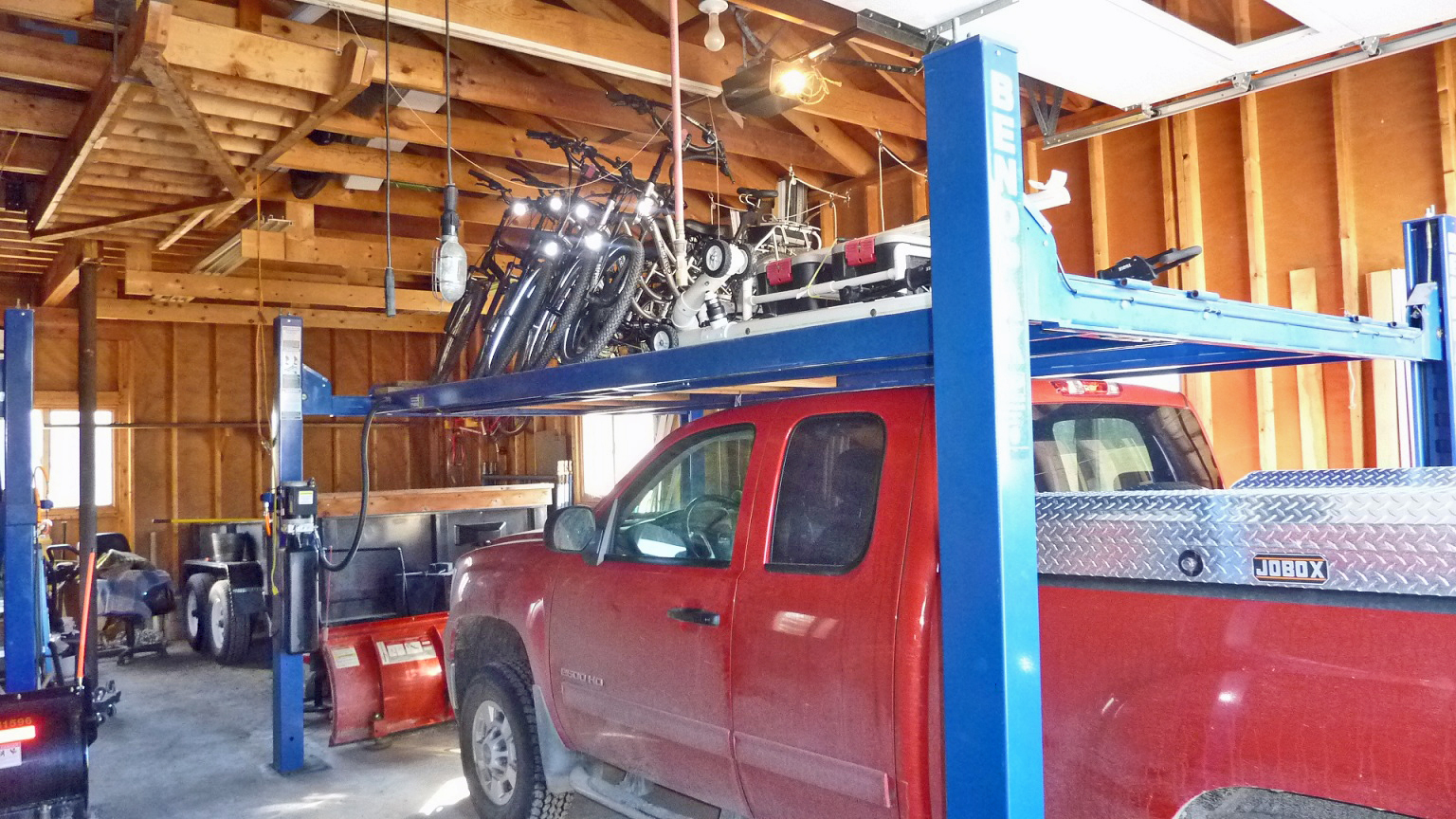

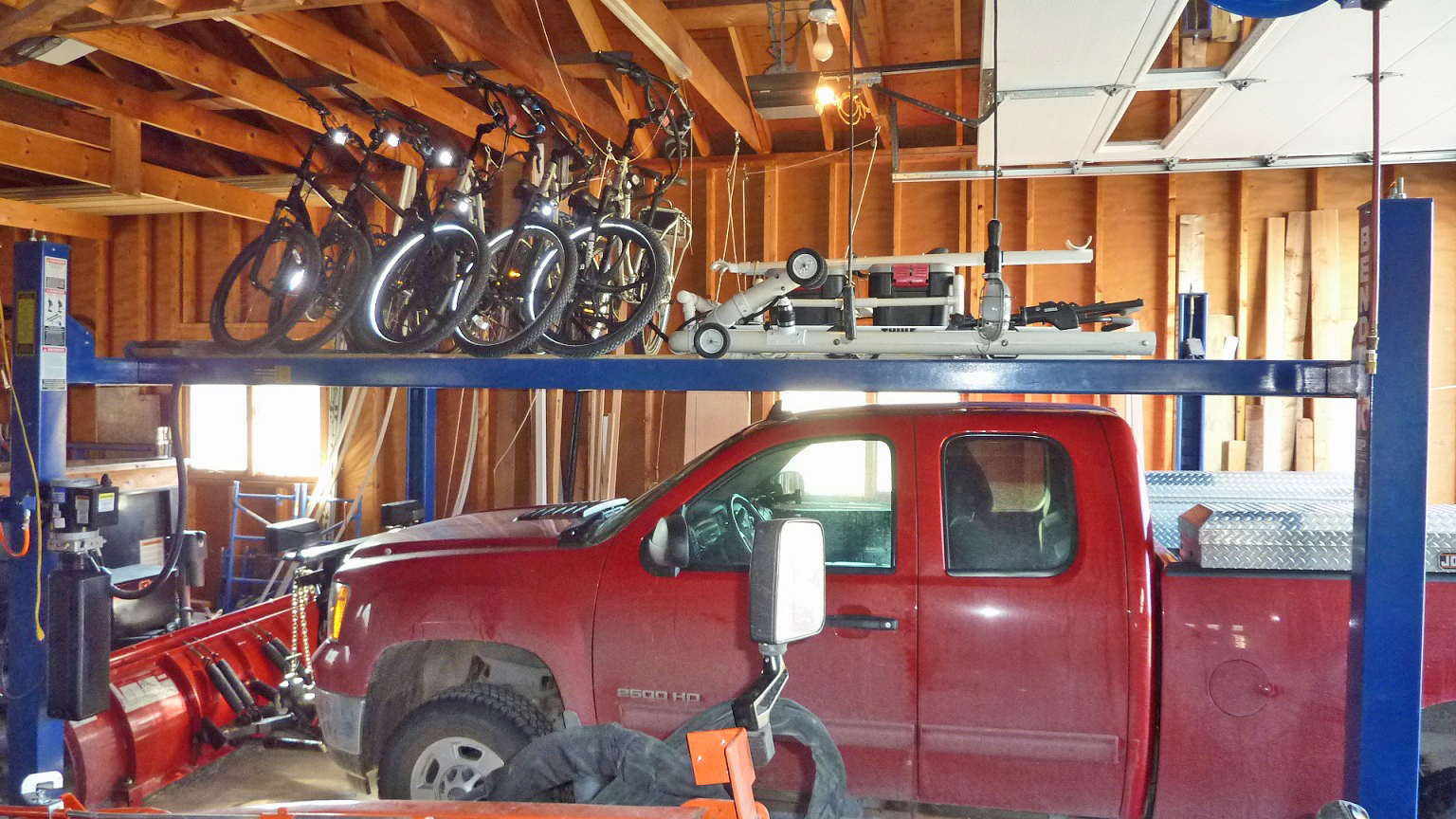

I use the same principle in my garage for other types of storage:
View attachment 710161 View attachment 710162
View attachment 710163 View attachment 710164

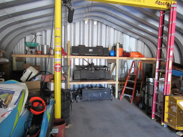

Here is where I keep my grapple and bucket when not needed.
Looks very nice, unfortunately my barns dirt floor and metal beams would make this a real bear to do. šŸ˜’
   / Out of room for your attachments? Adding a shelf helps. #18
   / Out of room for your attachments? Adding a shelf helps. #19
Now that's scary. As is do not put anything you value under that, or let your kids (or grand kids) climb up on that. At minimum it needs angled supports to the floor or some front legs on it.
