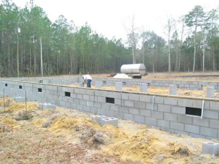

/ Our foundation getting dug and setup.

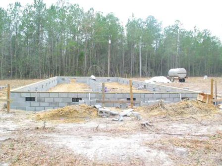

#42
Block work.

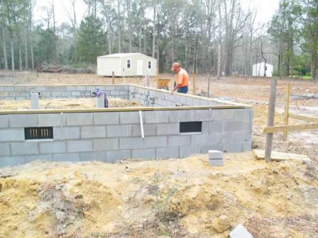

#43
Sidewalls.

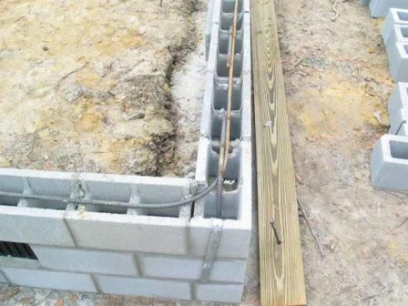

#44
More wall pics.

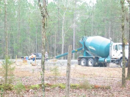

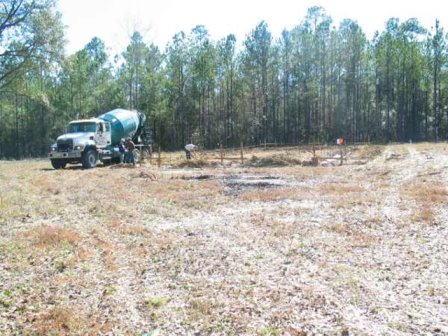

#47
Concrete truck for the foundation wall.

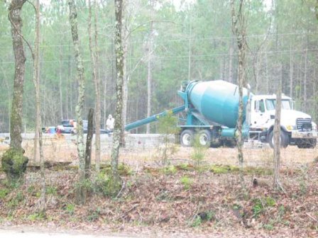

#48
Last one for now.
Will post more as things move along!

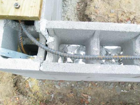

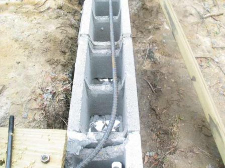

/ Our foundation getting dug and setup. #49
So, you lay the block, then fill it all with concrete? That's why the rebar is laid in there? Seems like an easy, quick and good way to do this..........
/ Our foundation getting dug and setup. #50
What is the shiney stuff under the block? Is this a metal shield or block? To stop bugs or limit the poured concrete to the upper course, or something else?
#51
</font><font color="blue" class="small">( What is the shiney stuff under the block? Is this a metal shield or block? To stop bugs or limit the poured concrete to the upper course, or something else? )</font>
Code here requires 6" min concrete embedment for the 1/2" anchor bolts to hold the sill plate. The shield is to hold the concrete in place.
#4 Rebar vertical wall reinforcement in fully grouted cells is also required every 4 feet.
/ Our foundation getting dug and setup. #52
I've not seen the rebar on top of the concrete blocks like that. It looks like you have vertical rebar bent over on top and tied into horizontal rebar. That ought to make for one tough wall, especially filled with concrete. Our code here calls for vertical rebar every four feet but nothing on top. Looks good. Keep posting pictures. I find it all very interesting. I'm currently putting in the blocks for my foundation.
Tom
/ Our foundation getting dug and setup. #53
"Code here requires 6" min concrete embedment for the 1/2" anchor bolts to hold the sill plate. The shield is to hold the concrete in place."
Sounds like the block cavities will generally be empty??? Seems it would be nice to fill it all in. We don't use blocks here, just formed stem walls. Anybody know why? With the blocks, a guy could use them as handy forms for the poured mud. We are seeing more ICF jobs than blocks.
#54
</font><font color="blue" class="small">( Sounds like the block cavities will generally be empty??? Seems it would be nice to fill it all in. We don't use blocks here, just formed stem walls. Anybody know why? With the blocks, a guy could use them as handy forms for the poured mud. We are seeing more ICF jobs than blocks. )</font>
The block cavities are all filled, but only the top 6" for the ones holding the sill plate bolts.
I haven't seen any ICF jobs in this area of Florida..... probably because most of the homes are built on slabs, and a few like mine are on crawl spaces.
