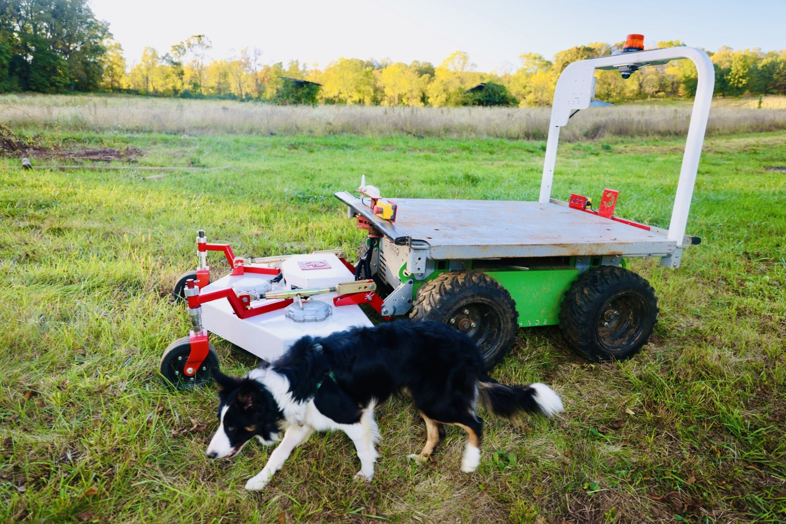

Not sure I have advice on this one. A lot of our customers are heavy production ag / nurseries, where mowing is just a lot of hours in labor / time...
Here's how it is looking now:

Are the blades really dull? Looks like it’s not a very clean cut.
   / Autonomous Mowing - Autonomous 36, 48, or bigger machine - would this have a need / interest for folks, or no?
#44
It has 3 different motor setups on it in abuse testing, so some of the spindles are not running optimally because they don't hold up in abuse testing.
In short, index on look etc, but the cut isn't shown beautifully in video.

#46
Here's waht these look like now:

#47
Running with a remote control in this video. Using it in areas where a tractor would tend to get really tippy or get stuck.

#48
What this looks like now:

#52
Here's what this looks like now. Can plant, move logs, do tillage, etc. and let the robot keep the mowing work clean always.
   / Autonomous Mowing - Autonomous 36, 48, or bigger machine - would this have a need / interest for folks, or no? #53
What is the mowing height? It looks a bit high.
Also, does it sense a heavy load on the mower? Does it automatically slow down in thick grass?

#54
2 to about 10 inches. Not mowing low here because the work being done is cutting brush cows don't eat!

#55
another video of one running
In that video it is running with sling blades (similar to a bushhog) so the cut is not as pristine as one might see with a fixed blade, but it is able to take rock hits and do up to about 2 inch thick brush.
   / Autonomous Mowing - Autonomous 36, 48, or bigger machine - would this have a need / interest for folks, or no? #56
I wonder what accuracy that mower would hold? I'd be interested if I could afford it, to mow my U-Pick with lots of rows of bushes, trees etc.
#57
These are sub CM in most conditions!
