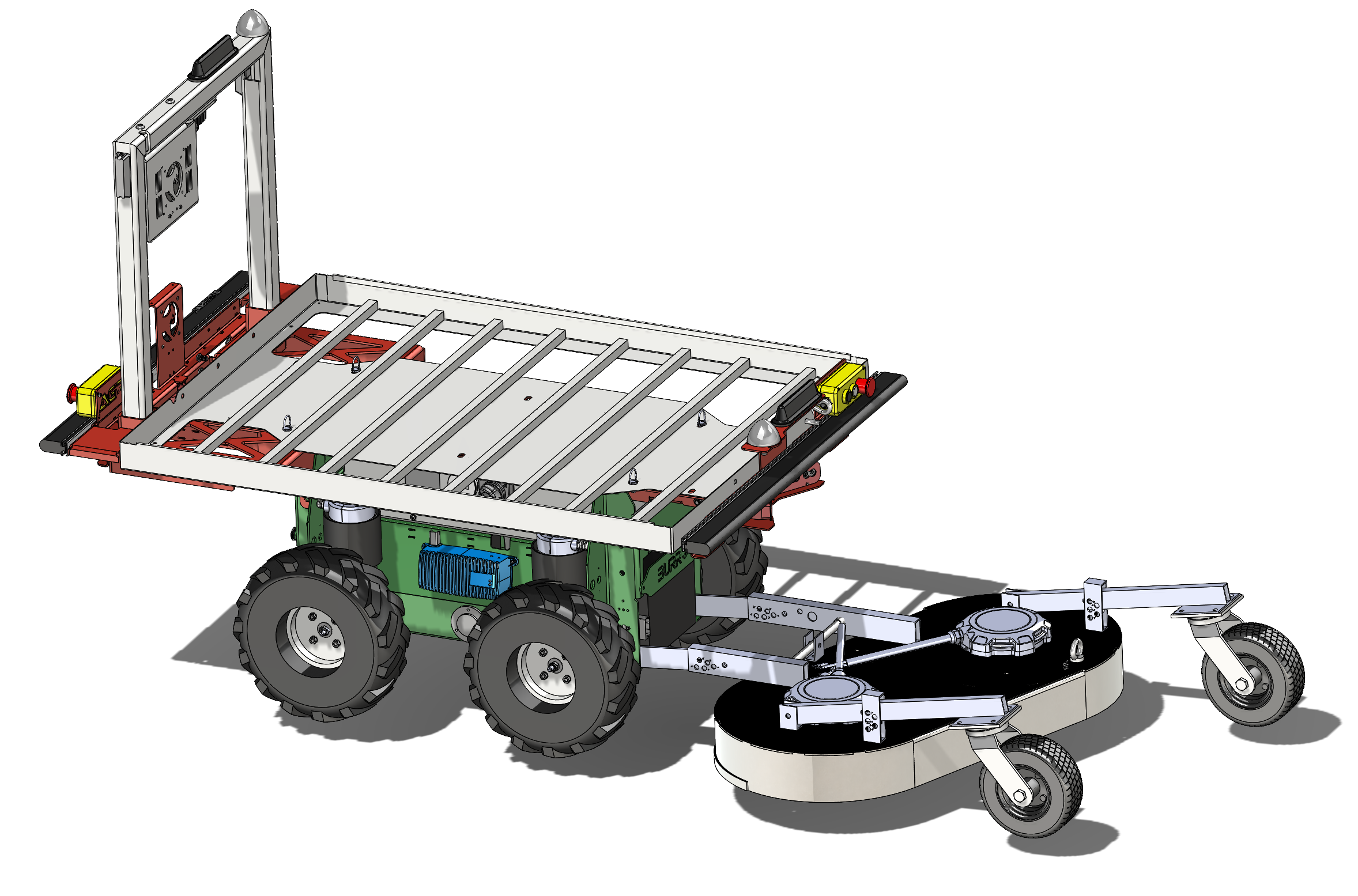

Here is about the size we are heading for (see image below) - likely starting with a 36 inch variant.
These are about 36 inches wide
dock to charge

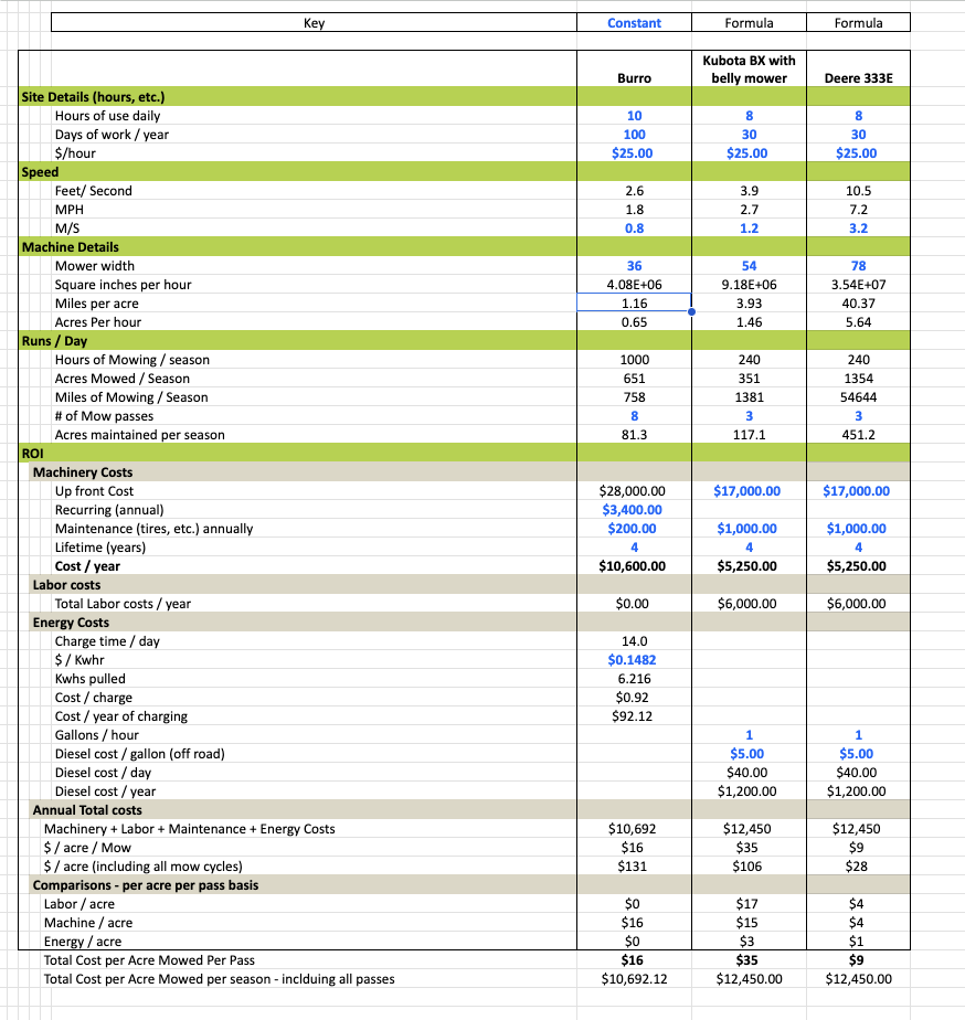

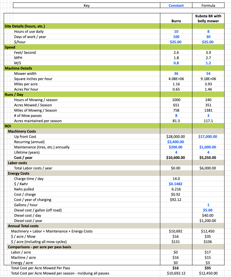

Ballparkish economics would be like 28K for system with autonomous charging dock, robot, and mower.
This could do about .6-.75 acres per hour, but run 3-4 hours per charge, so figure manage like 80 plus acres per seasons assuming 8 passes per year.
We are looking for a few early adopting customers in Pennsylvania (We are based in Philadelpiha) who would want to try this and share a ton of feedback.

no offense but a bx is going to last a lot longer then 4 years. it also doesn't have a limited life cycle pack like your robot, what is your typical charge life cycle 3k-5k charges? what are the wheel motors rated to in hours or miles?

I think your competition isn't the BX it's something like a Ceora by Husqvarna. Geofenced with DGPS and ground station. They say it "mows up to 18 acres" but they don't say if that's per charge, per day, per week. Cost is $32K.
   / Autonomous Mowing - Autonomous 36, 48, or bigger machine - would this have a need / interest for folks, or no? #20
It will maintain 18 acres running almost 24/7, these do not "cut the grass" they never stop cutting it to maintain a finish look all the time.
