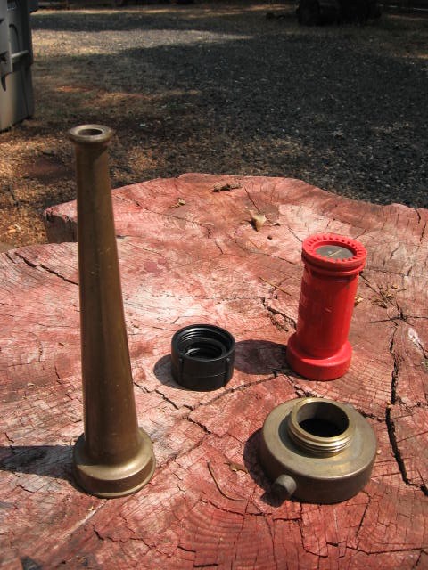

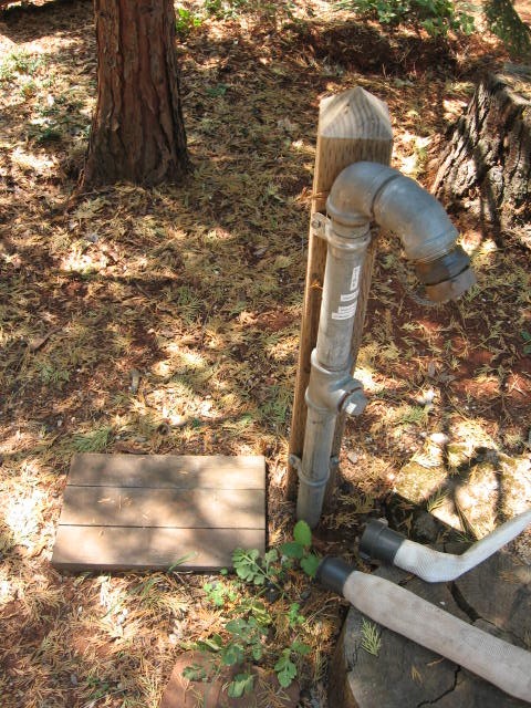

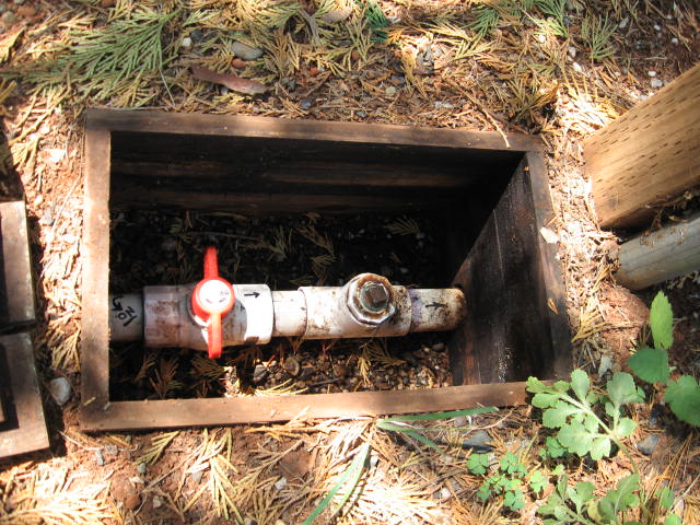

My hydrant stand pipe is just 1 1/2" galv iron pipe tapped into my 1 1/2" pvc main line. I used a 90 & 45 at the top to allow the fire hose to sweep to the ground. Note the fire hose adapter and cap. The low "T" is for an extra fitting should I want to add another. This would be an easy way to make your hydrant adaptable for 1 1'2" cotton jacket, then, at the low "T", add another "T" with two 3/4" garden hose adapters. I tapped into the main before any irrigation or house pressure reducers or back flow preventers so I get full use of incoming pressure/volume. A 4x4 PT post gives the stand pipe security.
The hydrant valve box is just a ball valve shut off. The plug is a drain so I don't carry water in the pipe during winter freeze.
Fittings ARE expensive but shop ebay and they are not too bad. Should be able to get for at least 1/3 of new cost. There are also good thermo plastic fittings that are serviceable and cheap compared to the brass fittings. I thought the old timer straight nozzle may give a farther stream but the forestry adjustable is just a bit farther and it has a shut off at the nozzle. The 2 1/2" > 1 1/2" reducer allows me to tap into the muni fire hydrant at my property corner

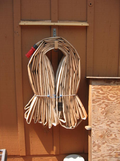

The hose rack is mounted on the side of the garage 30ft from the hydrant. There is 250" hose here. The plywood cover lifts off. This system is adequate but needs improvement. Hose should stream off rack just pulling hose end but I need to pay attention this one does not snag. I keep a couple hose washers right at the rack and put an old sock over the intake fitting to keep critters out.

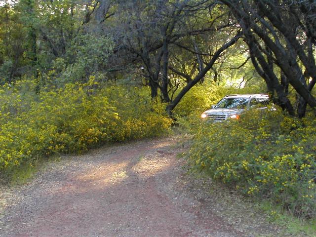

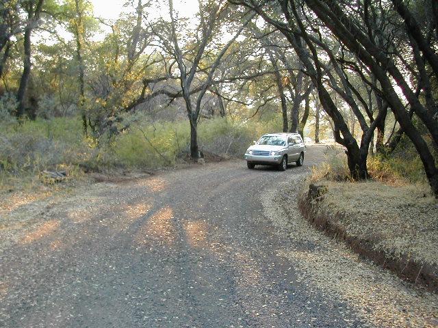

   / Our forest fire precautions #47
I can not emphasize this enough.
Fire engines are big rigs basically. It takes room, in width and height to maneuver them. If you can not easily get a concrete truck up to your house, you can not easily get a Fire Engine or Water Tender in there.
If we can not easily get in there, then it may not be safe for us to defend or save your house.
This thread has been a fire related topic. I must point out though, that this access is important in general. It may not be a fire the an Engine responds too. You may have need in other emergencies such as medical aid. The medic units, at least around here, are not small vehicles either. If there is an emergency, you will get an engine, maybe two, and a medic unit.
You should really have good access, that can be easily used at 3pm on a sunny afternoon for a fire, or at 2am on a cold, dark, rainy/foggy night for a medical aid or structure fire.
A lot of people have easy access for a compact car, or a pickup. It aint the same on an Engine...
Hotwheels said:
The Engine 83 guys are very helpful ... the emphasis was on access and defensible space..
Engine 83 and company have good access and egress. If they can get in but not out, then it becomes a different decision matrix for them and for me.

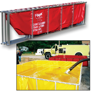

Tanks, would a fold-a-tank work for what you need? Fill it during fire season or when needed? Cheap, lightweight and can be used by the FD easily. Portable Collapsible Fol-Da-Tank | Water Supplies | Dump Tanks |

3. I like the folding tanks but they are just as spendy (or more) as a permanent tank. I found one on ebay last week. At $650 for 3000 gal still too much for me right now.

My nozzle is a forestry type, twist to adjust full stream to wide fan. It is pictured in the hydrant standpipe response to hotwheels above. My horizontal full stream reach is in the 65-75 ft range and the vertical stream is 25-30ft, maybe 35ft, so I can get up pretty high into some nearby trees. I may get another of these nozzles, they are only a few bucks on ebay and even quite reasonable new.

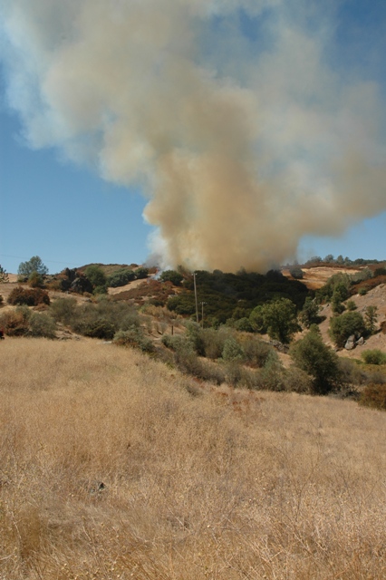

Not yet, thanks for asking. Pretty bad around here but at least the wind has stayed down. The air quality has been terrible for weeks but I favor that over fanning the flames. I think we've seen blue sky twice in the past three-four weeks.
We have a group of seven fires nearby, these are named the Canyon Complex fires. The closest is 3500 acres, six miles upwind, and we are watching that closely. It has jumped to the south side of the Middle Fork of the Feather River. We are a mile south of the South Fork so it would need to get up to the ridge, drop into the South Fork then get up to our ridge. Forecast is for light winds into next week so we are fairly safe...for now.
Just above that complex a few miles is the Concow fire now at about 40,000 acres I think and has been burning for about three weeks
Found a good website for monitoring the fires. Updated maps, sit reps, etc. It is a national map allowing pan and zoom right to your driveway. GeoMAC (Geospatial Multi-Agency Coordination) - Wildfire Support
