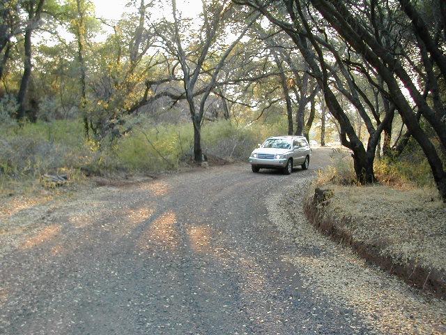

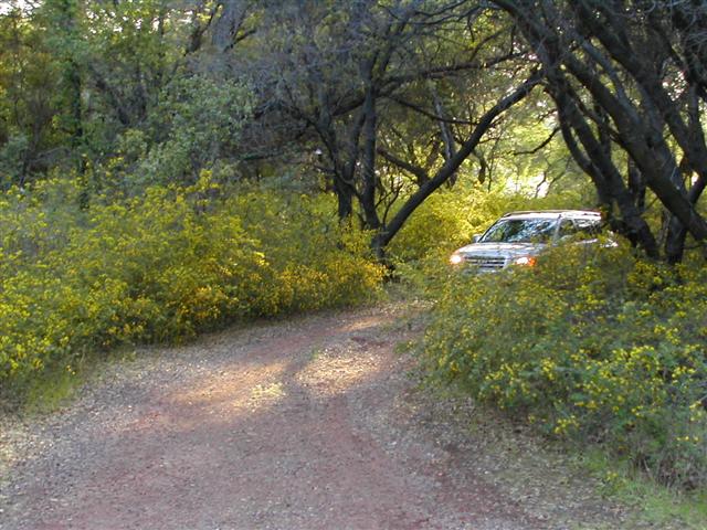

   / Our forest fire precautions #24
Here in Paradise today it's like sitting in a fogbank! Fortunately there's little to no wind. A dozen firetrucks just drove uphill past our office ... couldn't read the names but they were all from out of this area. One evac center is by our house and was declared "full" and now evacuees are directed to Las Plumas HS in Oroville.
It was just reported that our fires are #3 on the state's list.... meaning more help. The worst news is the predicted dry lightening for Thursday/Friday.
Access and defensibility are my top priorities too. I posted these before and after photos of part of my driveway on TBN in September '06. My goal was "fire truck friendly" and it was specifically for times like this. As it was "before" I'd have not blamed any firefighters for not wanting to get to my home.
Phil

I think rural folks have more leeway to prepare for fires and fire fighting...
I have had the police pay me a visit because "Someone" heard the sound of a chain saw and wanted it investigated or on several occasions for scraping the city mandated fire trail running through my land...
I can't even imagine what it would be like to be able to take out a dead tree or disc the soil around my home without a visit from the city...
Owning Acreage in the City Limit is turning out to be more of a liability every year...

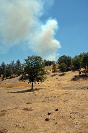

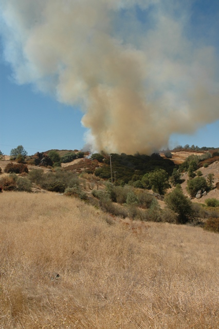

Charlie, I will try to post a pic of conditions near my place or at least from my driveway looking at smoke from a fire a year or so ago. For what I know right now, and believe me that is not much, I think I may get the most value out of the Barricade gel rather than the foam.
This is a learning process for me and I have more questions than answers, but glad to see others are interested in trying to do what we can as homeowners.
