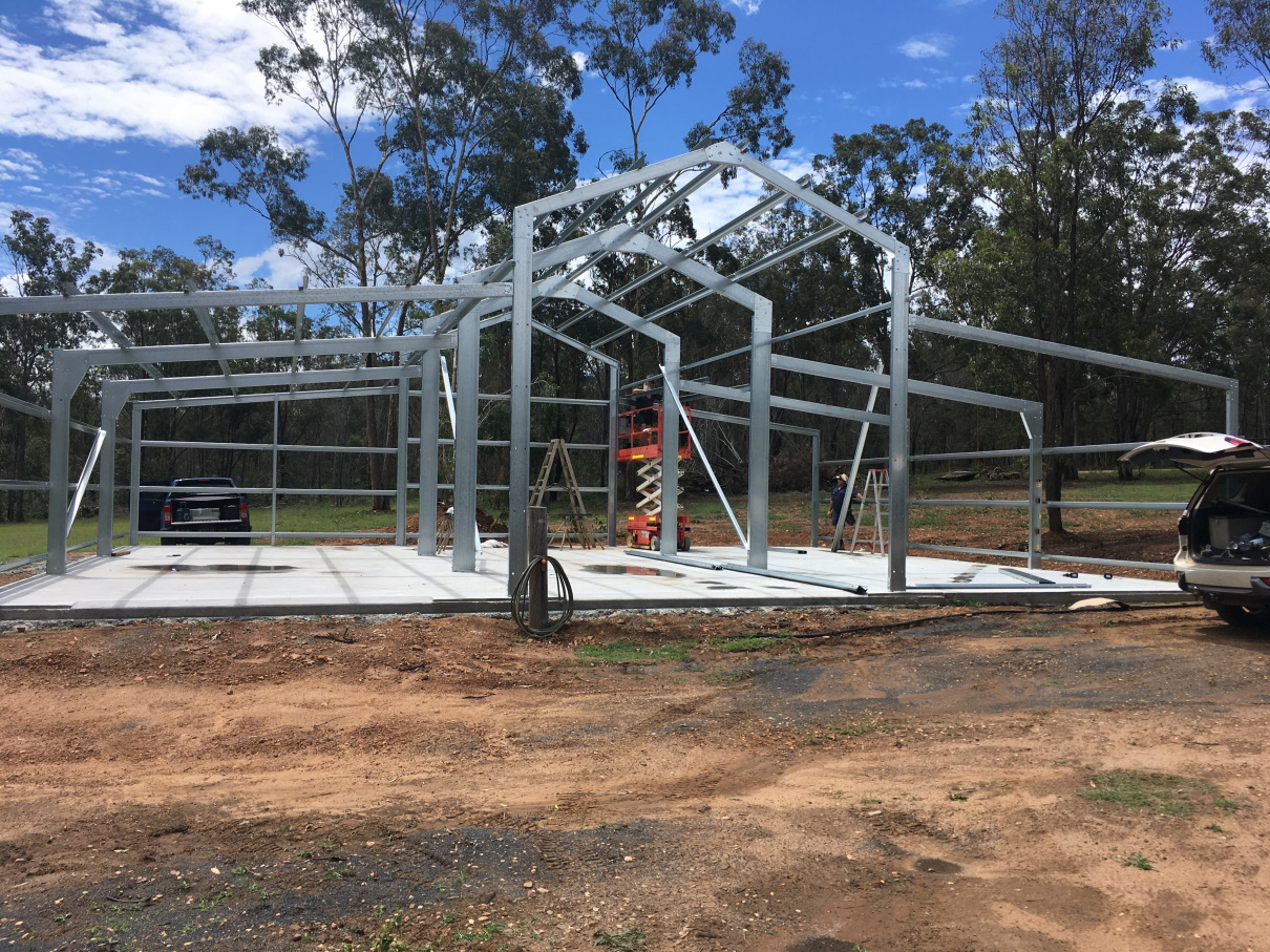

i was thinking steel to keep the overall height of the building lower and still keep good interior height for the center bay. also the cost for materials seems not that much different and the steel comes all ready to bolt together.
/ new barn design help #32
You definitely want to consider the interior finish issues associated with a steel building (I.e. installation/retention of insulation, installation of drywall/OSB/Plywood, running of plumbing and or electrical in walls, etc.).
I’m not sure you’re going to get a great reduction in overall height with steel- I have a 4/12 pitch roof designed for a 65psf snow load-with 14’ walls the peak roof height is around 24-25’. As can be seen from the photo, color selection and siting has a lot to do with how much ‘presence’ the building has.
You certainly won’t go wrong with steel. I do think the permit/inspection process was easier as pole barns are common construction around here.
