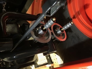

Well after a a 10.0 on the Richter scale it finally came off. LOL I broke 5 filter wrenches in the process
1 with the fabric type band that you guys showed, snapped in a heart beat filter never moved
2 of the metal ones that bind against the filter, I guess i don't know my own strength, not bad a 73 :cool:
2 of 3 prong types that you use a 1/2" long bar bracket. Those were the best but due to their Chinese origin the gears stripped due to my superman like grip.
Finally I drilled a 3/8 hole in the far end and with a long beefy screw driver and the simultaneous cranking with one of those O'Rielly filter metal band wrenches, It slowly came off.
Of course with almost no maneuvering room under neath I had to get my knee against the band and at the same time torque the screw driver
I have never seen the likes of this.
I think it was a combination of Paint 1/16 thick, over tightening, dry gasket and time on the machine before removal.
If Kioti wants to install these like this they should engineer and manufacture a special filter remover taking into consideration the room under the tractor to move any tool.
Phew that was a long story.

Caveman techniques to the rescue ;) Welcome to the club

I actually drilled and then used a screw driver of substance :) Not my first choice of how to do things but desperation calls for desperate measures :)
If it had not come off at that i might have brought out the torch and cut the whole tractor in half LOL
